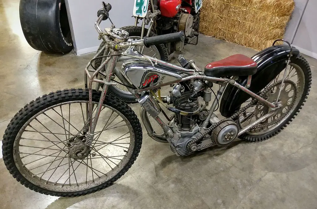

Used a 1" Harley tube clamp on the seat tube and made two 1/4" thick aluminum brackets with two holes in each, mirror image, and mounted the 300 lb. shock to the brackets and the other end of the brackets to the outside of the Harley clamp & bolted all. That end isn't going anywhere.
The nose of the saddle will mount to the stub of the seat tube, after I cut the stub as short as possible. This will place the back of the saddle out over the tire a good bit. I'm long armed and long waisted for my height and I'm used to a bent over riding style on not only my board track bikes but also my mountain bikes and road bicycles. This position takes the strain off my spine & eliminates the road jolts from going into the erect spine in a straight path.
Just an example of an add on that will take a little time but will make the Harley a little more friendly to the old guy & add to the long, low lines of the bike. The added structural benefit to the bike is that the smaller rear triangle tubes will not have to bear the task of supporting my weight & it's momentum generated on the saddle, but rather that load shock is transferred to the strongest frame member which is the seat tube. I've also sleeved the seat tube down past the two Harley clamps to the top of the bottom bracket lug. I don't think it possible to crush the DOM tube with a Harley clamp but it's added rigidity insurance.

Saddle came in...nice leather with thin gel pad & a lot of curl to the steel pan. I'll get the saddle mounted & see how it fits and looks. Rick C.

The seat kinda surprised me when mounted it looks rather nice and feel proper as well. It's been sitting on a shelf for years...don't remember how I came about it but think I've found a use for it at last.
You got my vote on the build off & well wishes too. No matter the ballot results it is a fine build! Forum members get out the vote for Jeff. Rick C.
Couple of photos showing saddle mounted. This position may change an inch or so but it's very close to where I want it. Rick C.

Great looking bike Rick. That is quite a cantilever you're creating with the seat pan and spring. It seems like the pan would flex (I'm also assuming you've thought this through pretty thoroughly since you always do). How much travel will the spring have before the pan touches the tire?
Correct Harold. The photo shows a mock up of the saddle that is attached at the seat post only with a block about 2" thick placed between tire and seat pan. I'm working on a greatly reinforced rib for the saddle mount to spring connection that will spread the load placed on the pan & increase the separation between tire and saddle pan to approximately 4" at the same time. I'll get back to this Monday as I ran out of time and energy late Saturday while fabricating the aluminum plates for the mount....the main rib plate was machined from 3/4" x 3" x 3" aluminum which attaches to the steel seat mount edge wise & bolted to the saddle pan. The spring is then bolted to and pivots on the aluminum rib to support the rear of the seat and the front of the saddle pivots at the seat post.
I think this will help take the strain off the pan mounting studs, as well as the steel pan itself. Spring compression is a touch over 2" after setting up pre- load so I'm pretty sure the low slung, flat track, saddle "look" will be there even without rider aboard.
Going with a spring is definitely not a vintage "race" look I'm aware, but it does take all the extra weight of the rider, in motion, off the rear triangle (seat and chain stays) & places it back on the traditional bicycles originally designed and strongest support... which is the seat tube. I like the way the spring fills the void between rear tire and seat tube as well, since I'm not a fan of fenders front or rear (rain is seldom an issue here in the Indian Territory), also I'll be riding the Harley a lot and I really want some cushion for a bad back.
I'll take some photos and post... oh almost forgot Harold sometimes I'm just wrong and screw things up without thinking. My bad! Rick C.
Parts for the front half of the spring/saddle bracket and support rib...to be drilled & bolted. This coupled with a re-enforced saddle bracket, rib, (not yet built) will tie into the rear pan spring supports. That full length support will control the flexing of the steel saddle pan. Rick C.

Thanks for the detailed explanation of your thought process Rick. Very helpful. I guess you're right that it's not vintage looking but then I'm all for making the ride more comfortable and safer. I think most of us build to an "inspired by" aesthetic within limitations. I really envy your ability to have a vision, make a plan and make it happen.
Really appreciate your comments Harold, very encouraging. Also glad you mastered the lace. I know that was satisfying.
Posting a couple of seat spring photos with the top mount bracket bolted together but not yet coupled with the saddle rib. Looks as though I will have plenty of vertical adjustment as well as structural strength for the pan.
