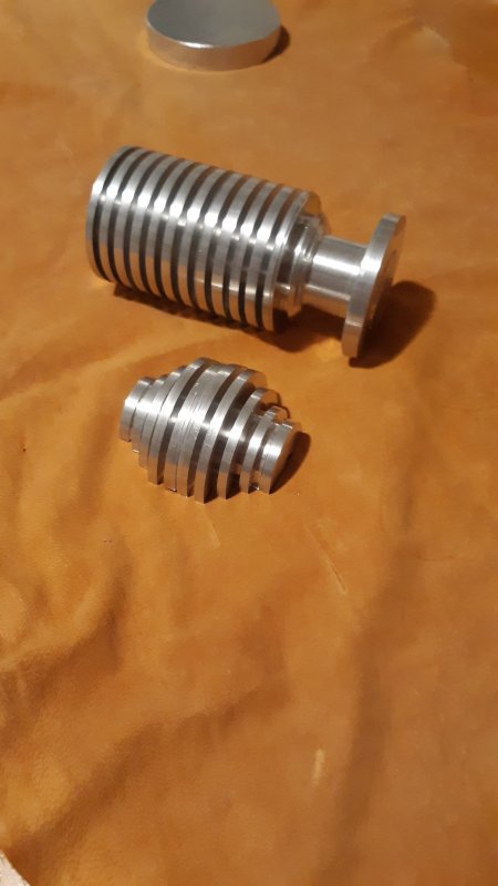

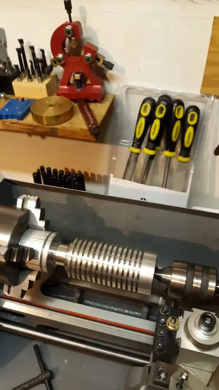

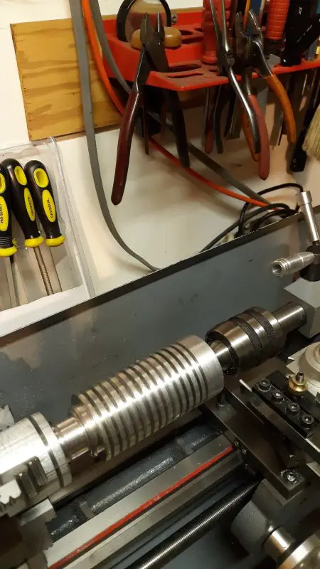

Since I don't have a mill I used the lathe to cut the vertical head fins. Parted the cylinder jug and starting work on a little brass carb, Hedstrom style. I've still to decide if I go atmospheric style or F-head on this single cylinder model. I've decided to use the battery style case rather than the magneto ignition drive.
Quite a bit of work to get to this point & both the head and cylinder reqire a lot of detail steps to complete. The little crankcase is really simple compared to this.
Rick C.

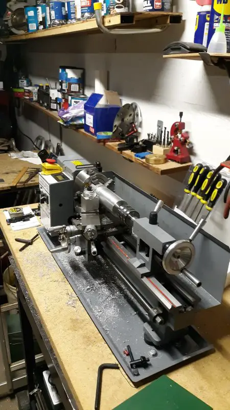

Steve I've had lathes and mills for decades and the past few years, I've lost track of how many; maybe four years, since I sold my shop, at any rate I've done without machine tools and that includes TIG and MIG welders. Though I get by on my 220v. flux wire feeder I miss my TIG more than I did the lathe. My eye health has improved to a great extent & with a lot of optical correction I can see well enough to weld a little on steel, but I doubt I cold pick up the puddle welding aluminum with a TIG. I may ask to try my luck at the local welding shop and try to TIG some aluminum. I know I can see to run steel. If I can't see what I'm doing I'll just buy TIG for steel....save a lot of $$ in the process, but I'm hoping I can see well enough to get a good pulse-.square wave ac/ dc TIG.
