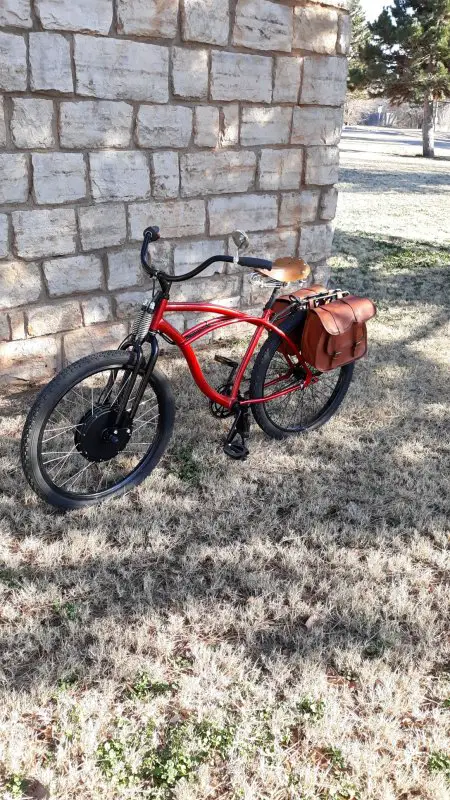

All super suggestions guys. I did get "Wally World Red" up and running today. I ran about 3miles total & spotted some issues. The front hub worked great and that is always a relief on any motor setup gas or electric and comprises a large chunk of any bike projects budget. I'm glad I went with 36v. as it has adequate power I'd think 25 mph is a realistic expectation, even with two batteries the bike is still on the light side. Two batteries, bags, rack and hub motor add about 30 lbs. to the Cranbrook. Though I left very few components from the department store carton bike in place they all have to go. One piece crank set is a joke, as is the headset, chain and pedals. I need much longer pedal levers and then the saddle can be raised. Though I like the look of the leather saddle I hate everything else about it. Good news is I have an extra bobber solo saddle on the shelf. I need to fab a post mount bracket for it however. I also think I have a mountain bike dropper post that may fit the seat tube.

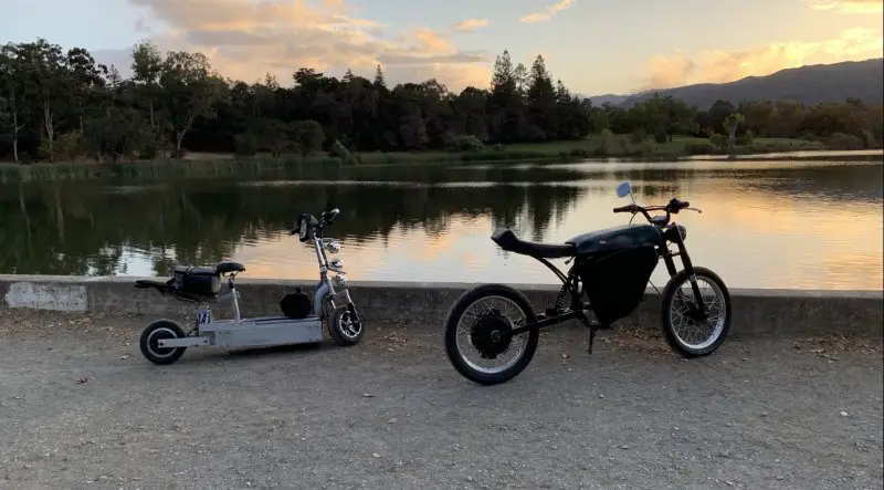

Hey Rick, read somewhere you are looking for input for different setups. You can hit me up.

Bike and scoot look great Tony and thanks for your offer of help. You're the man on electrics! I see you are making some high end packs available & hope that's a huge success. The e bike, cycle & scoot industry is booming and the top of these markets seem to be where money is to be made. The low end is kina' saturated with offerings currently.

I adjusted some things and upgraded the headset, and rode a few miles. Feels like a different bike from the one I rode yesterday, much better feel but still needs some of the mods I mentioned. I raised the saddle and bars which is a stop gap measure but it helped quite a bit. Even though it's an upright riding position it's really intended primarily for short rides about town . I think my back can take it. The short wheelbase, compared to most of my bikes, will take some getting used to as well.

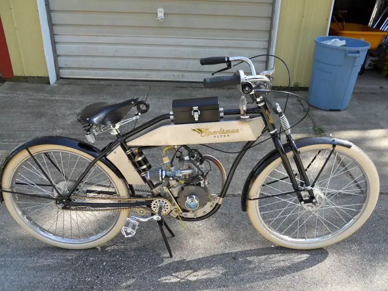

That was with a Broke in Brookes. See if you can soften the backbone tension, also tilt the saddle 15 or more degrees nose high to transfer your weight to the broadest section of the saddle. Oh what a difference it makes.
Thanks Tom for posting the photo of your Sportsman. I never tire of seeing it and I definitely don't have my saddle set using as much angle. I'll adjust & try this. I do think it will improve the ride. The adjustments of saddle height & setback coupled with having longer pedal levers has helped a great deal so your suggestion for altering the seat angle may improve my attitude regarding the knockoff Brooks I'd really like to stay with this saddle on this budget build and save the expensive bobber saddle for another bike.
The longer pedal levers are also one piece from a Walmart bike and function really well, though I plan to eventually change out for cartridge bearings and three piece crank set with Schwinn bow tie pedals.
Looks like this simple DIY e-bike can ride and function well basically as it was imagined. I'd say for those wanting to try a first e-bike and have an old frame in hand, $400. plus a couple of hours could have you up and running a hub kit, using one 36v. lithium pack. Not much of an "initial" investment to verify what the buzz is about electric bikes.
