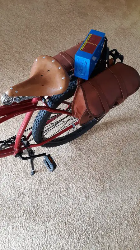

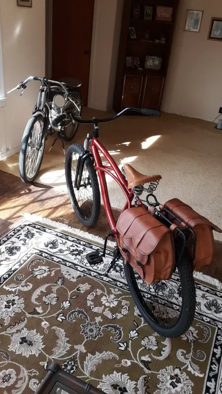

Basics for the 2500 watt Cranbrook "bagger". The leather bags will hold two 25 amp hr. 48v. lithium packs and the controller. Rear hub motor and batteries on order. 50 amp continuous controller set up with 70 amp peak (3500 watt). Amps times volts equal watts. Basically almost all the dollars on this one is in the power train.

Nice saddle bags Rick. where did you find them? I have scouted around and the only ones I have seen online that scale to our bikes are ones hung over a saddle horn. Spose it wouldn't hurt to snoop around in some tack shops.

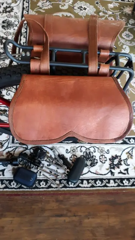

The bags are an Ebay item #124301049864 from India I'm quite pleased with them $60. or so shipped. The first leather bags I ordered for battery carriers for the Grubee hybrid and my mountain bike are really small, which I wanted for those two bikes the battery fits fine (36v. 20 amp hr.) but these bags had to be bigger, but normal horse tack and cycle bags are much too big to look good on a bicycle size frame. The equine bags have a wide strap that is much too long for even motorcycle service with alterations. Horses ass is really big one, thus the common linguistic usage of the term. 12x10x 5 inch vertical dimension being 12". The flaps will cover items longer than 12" though. The bag has several small pouches and is lined to protect items from the oiled leather. For the price pretty decent and I looked at what would suit my purpose not price I was prepared to pay much more for bags that would fill the bill.

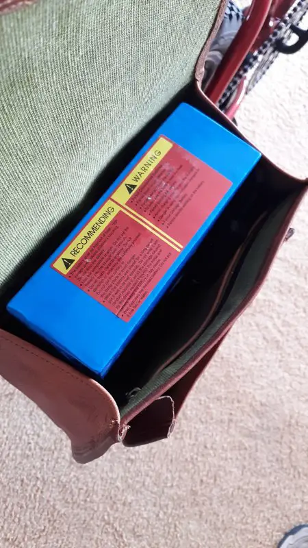

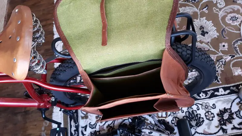

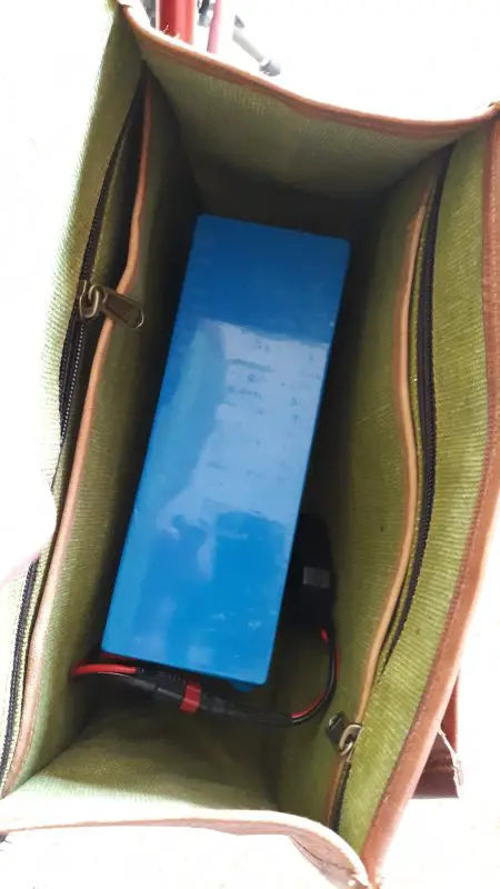

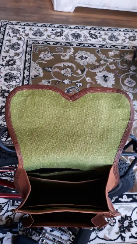

Tom here's a look inside the saddlebags. I discovered it has three inside pockets, two of which are zippered and are full length and bredth of the bag dimension. These are in addition to the main bag pocket. The is also an outside pocket that is very roomy and the large leather flap covers it well.
I've located a Texas saddlemaker that offers a black set of bags that features similar dimensions. Made in U.S. I'll check these out as well. Same price range, under &100.

Thanks guys. The bags are working out well the battery packs easily fit.
I made an order change and am going to use 36v. 20 amp batteries and using a front hub mount instead of rear hub power. I also substituted a smaller 35 amp controller with my order. The motor kit is scheduled to arrive tomorrow. The reasons for this change are really simple. I prefer the front drive for all riding except going uphill on loose terrain, such as gravel. This little Cranbrook won't ever see gravel. It's for town transport. Speed isn't important either. Twenty five mph is fine. Pedal assist is easier and when you pedal it's a two wheel drive train! I have extra 36 v. battery packs on hand and this makes swapping packs much easier and initial cost is much lower. The Cranbrook is a Walmart economy bike, short wheel base and running 1,500 watt plus power seems a bit much. It's steel frame and the forks are the good Sunlite version so the front hub is well supported but running 1500 watts on the rear factory drops seems risky. Finally this build was started to use up spare parts and to not spend a lot of $$ on so to date I have spent $355. on new parts for this e-Cranberry 36v. bike.
So that's the long and short of it and it sort of mirrors my Fat ugly electric that I used mostly what I had lying about to build, though it's 48 v. and it is used in gravel quite a lot. It would benefit from the addition of a 48v. rear hub motor for those uphill loose pulls but I'm not sure if I want to make that addition, but I am considering it and the rear electric hub is all I'd need to purchase.....
