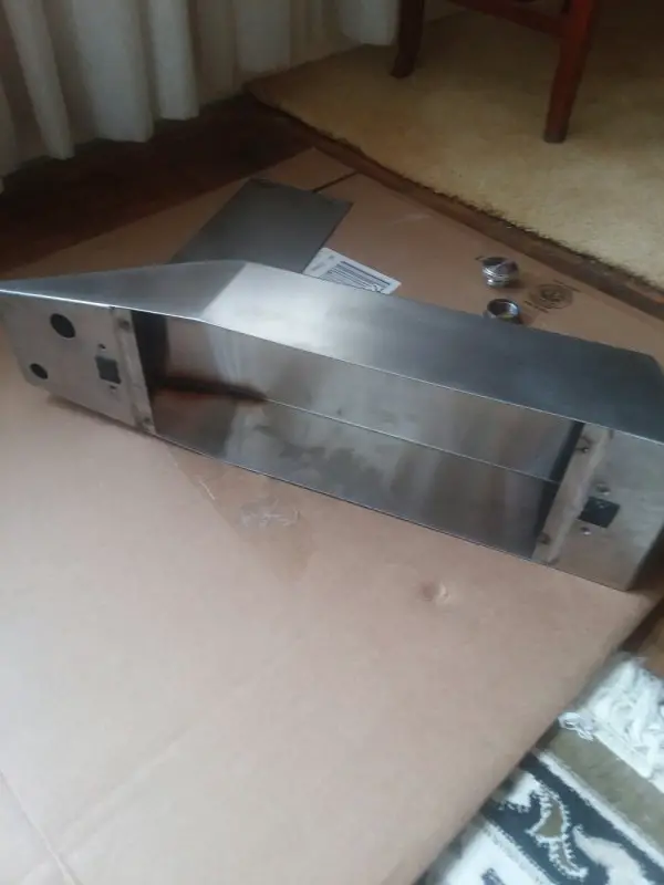

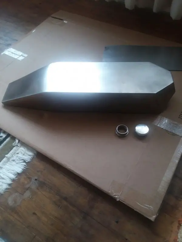

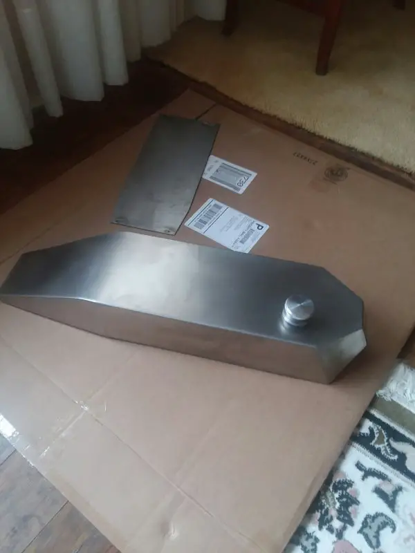

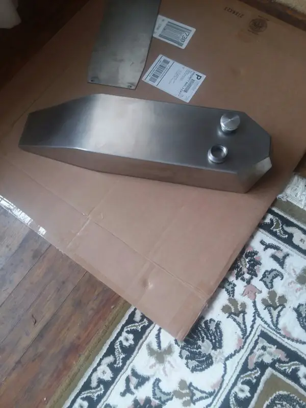

Sportsman tank arrived today, quick ship and well packed. These stainless, Harley style tanks have no waves or ripples due to poor box brake work or welding heat distortion. This is the second tank Pat's supplied me with the first a fuel tank for my Harley Pea shooter and now a battery tank and both perfect in fit and finish. The battery tank is a little larger and is a bottom loader, with a heavy duty stainless cover. I show a bung and cap in the photos that I may use, not decided yet. It's one I'd ordered for a torpedo tank that I've still not completed. Pat could have mounted the bung for me but I didn't want to hold up shipping & I'm still not sure I'll mount one...so there's that.

Always a shame to have to paint such tanks - but I guess paint isn't the order of the day on this one. Presumably you're planning on adding decals to a bare metal tank? How will you patina stainless to blend in with the rest of the build's aged steel parts?
That's what I faced building my Sportsman based Harley Peashooter & I just left the tank natural. With my Schwinn Excelsior I painted the stainless tank black. I'm actually thinking I'll paint the frame, forks and tank satin black on this one, and add red Harley water slides on the tank. Black was one of the four early factory color options. I don't have a client to please at the moment so things are being approached a bit differently as a result. Kinda shoot for an older restore look done in the eighties and subsequently well cared for?
Stainless ages well & dulling is about all I know to do to it. I did a torch burned stainless tank on a bobber once that looked great, but it didn't look aged.

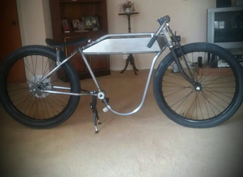

Mounted the tank starts to fill some space and that made the motor look small & believe me it's not. One aspect of board track V-twins that I admire is looking stuffed with motor and no room for anything else that got in the way of going fast, just bare bones racers.

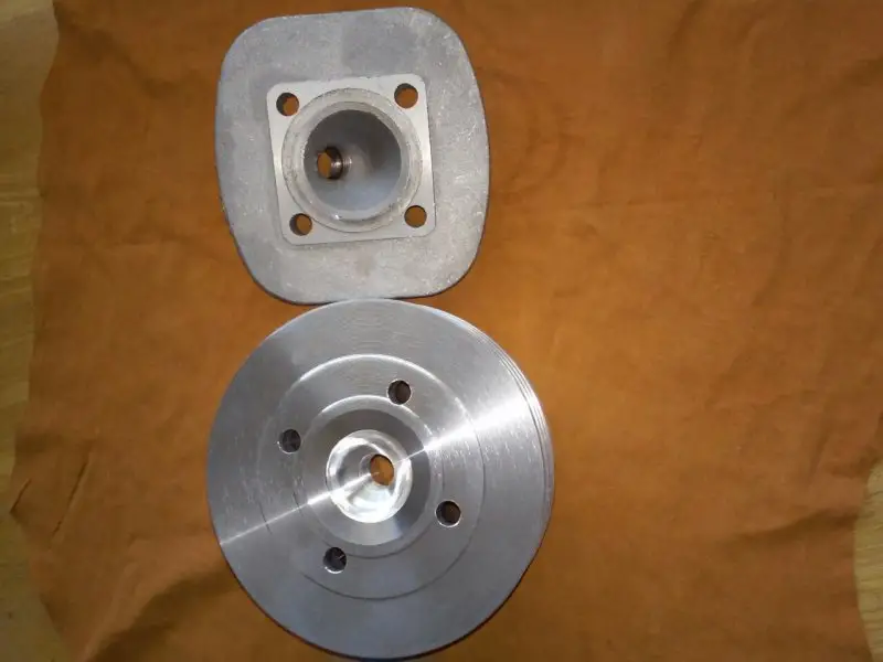

Silent grey ghost hounds of '15....Steve...notice the difference in the shape of the stock CG head, kinda' square and the aftermarket is round.

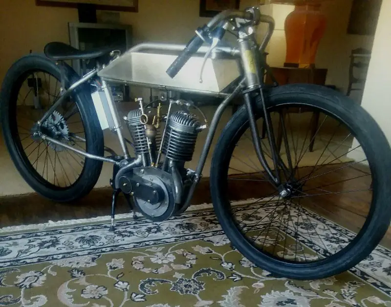

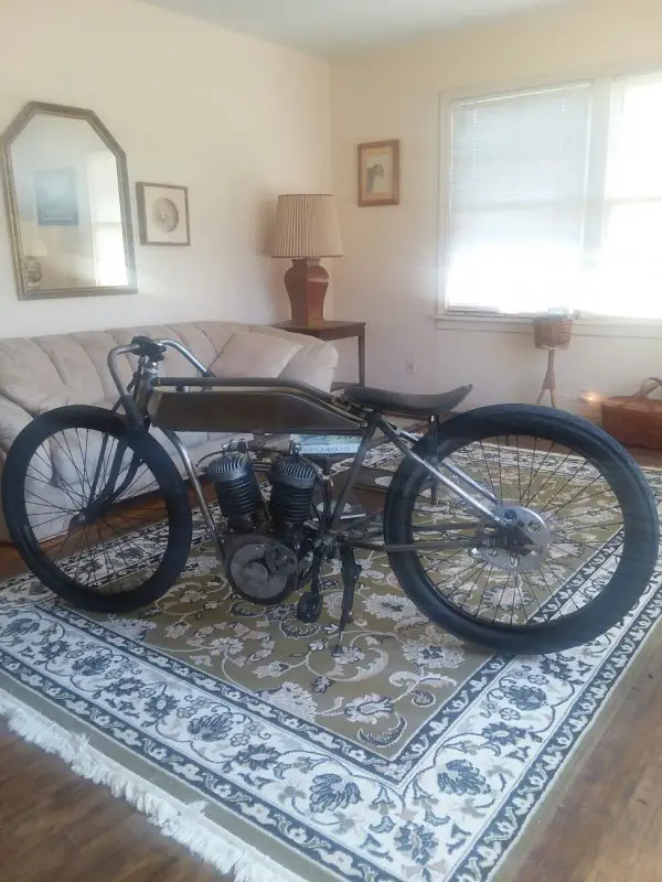

Bolted back in frame & I'm diggin' it! It's got the 2KW 48v. motor in it and I'll hook a small 50 amp controller to it. My 48 v. lithium pack can continuous 40 amp and max 80 so the controller will only allow 50 max. or 2,400 watt & 3.19 hp. It's fine for testing & I have it in hand.
If it can spin up to 4500 rpm with the reduction gear & 44 tooth final on the 28" diameter tires the calculator shows 44mph but that assumes the rider and bike weigh very little and the wind calm and narrow frontal area (think razor blade edge).

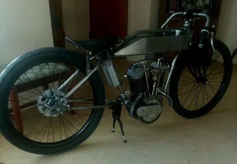

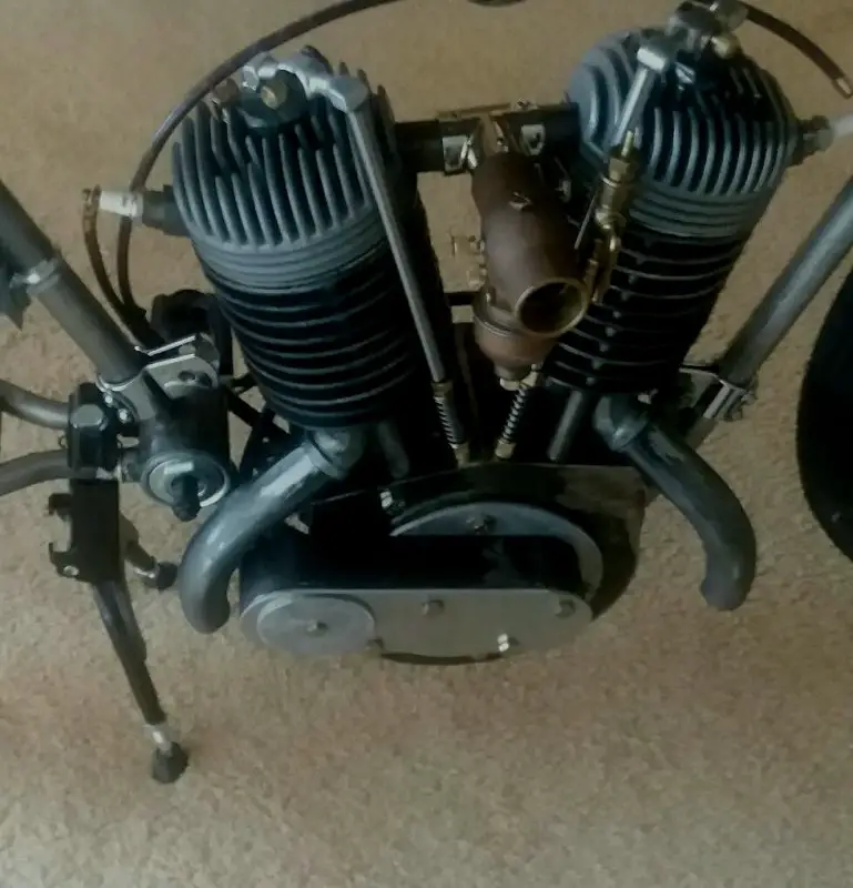

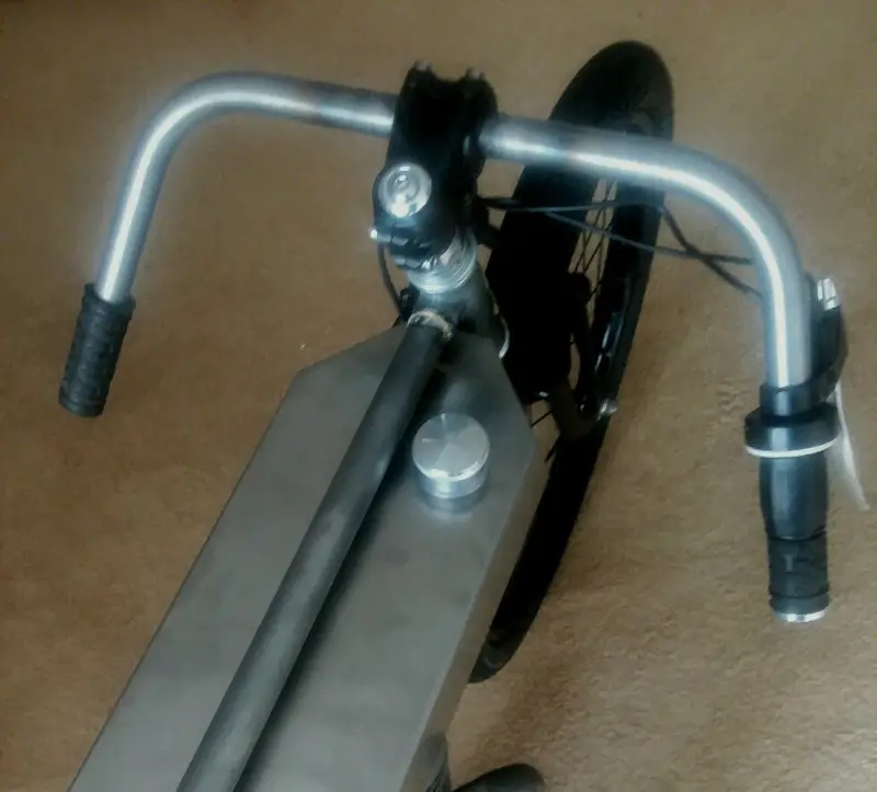

The more I get done the more things I add to my list of things to do. Photo shows throttle grip needs to be cut down 3" to match up the grip lengths of the half throttle & tube plug installed on the bar end. I went ahead and used 1" tube clamps to hold the little controller in place rather than use zips. The 72v. controller is three times as large physically. Glass sediment bowl will look good connected to the larger carb with copper line. Also the exhausts will be stubs, too much rams horn look about these as they are. Engine will be lifted about and inch too & shifted .75" to the rear. Top mount fabrication is waiting on engine height to be finalized. Same with pedal sprocket size, it won't be very big and also pedal clearance will have to be dealt with. Fuel bung location and engine mount brackets determined with final motor height decision. Lot of cosmetic details to complete after paint goes on. All these added to the long list I'd made a couple of weeks ago and I'm less than halfway through completing it.
I aged the brass carb with a mild acid wash accelerant...turned out about right and time will get it perfect.
All the brake lever is for, at the moment, is to activate the regenerative braking. Later I'll add discs front and rear on sealed bearing hubs for daily riding.
When things appear 80% complete, and close to going to paint, that's actually off by 25% in my experience.
Rick C.
If I'm to do a black bike: frame, wheels, tires, tank, saddle and motor ; then a little metal contrast here and there is all I've got to work with other than a Harley tank decal. Brass fittings, fasteners and a little copper tubing. Cast finish heads and some unpolished aluminum side cases are pretty much it. Most of the bare or plated metal centers on the motor. Creating a visual interest without color flash or a lot of shiny isn't easy on monochromatic projects. Shape and contrast...
Throttle grips pair up better now. I need to add a tube plug to the left grip as well. When I install the front and rear disk hubs I'll revisit my control options.
The battery recharge plug will go under the fuel cap which is screw on type bung with O-ring seal.
