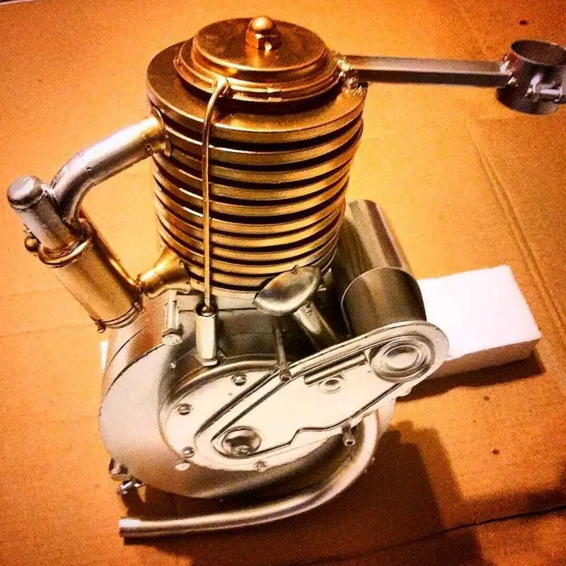

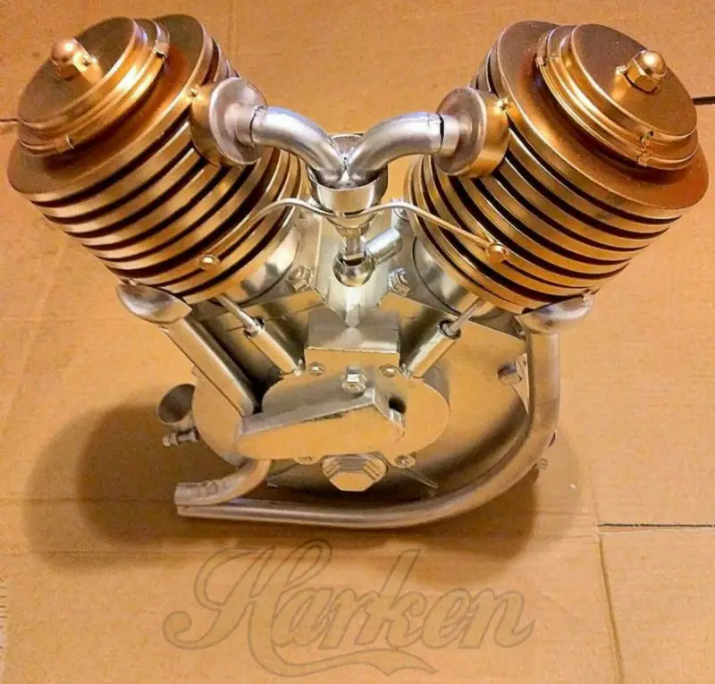

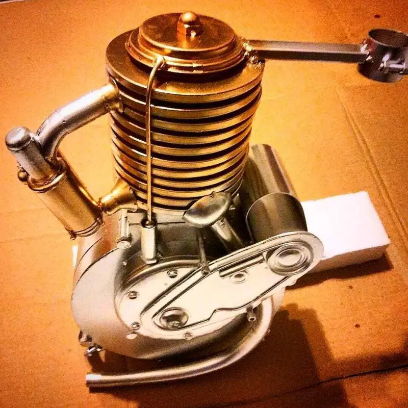

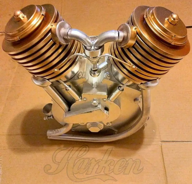

Rick, I just saw on eBay that Harken are soon to release eBikes sporting either v-twin or single faux engines. Current 'best offer' eBay listings are for some of the development prototypes. Pics attached.
Pete mags nailed the display motors source and pricing. He's shown various frames for sale with model V-twins mounted for awhile now and normally denotes motors shown as not included in the price. I wish them good luck if they bring an e-motor in a twin case to market. Though I'd think it would look quite different from the art models shown for sale. I can't see these as being used as very effective prototypes except perhaps for sizing a real prototype effort. No mater, they or someone else will bring e-powered classic style motor cases to market at some point and I'd think it sooner than later. Pat actually has the lead in this vintage electric-V twin specialty niche and it will take some real effort to match his quality and attention to detail, but others will try to do it on low ball pricing, but I've doubt this group will be successful their low quality and high price of their frames and tanks don't exactly inspire much confidence.

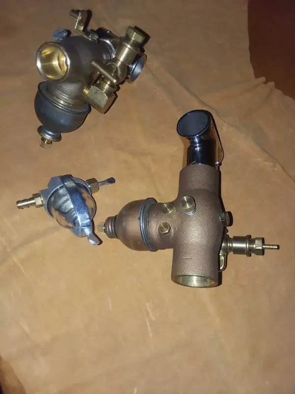

I've been thinking about adding some horsepower to my fake V-twin by installing a much larger faux Schleber racing carb on it and perhaps using the smaller carb on a single cylinder E-motor. It's something I can work on when I'm not working on something else.

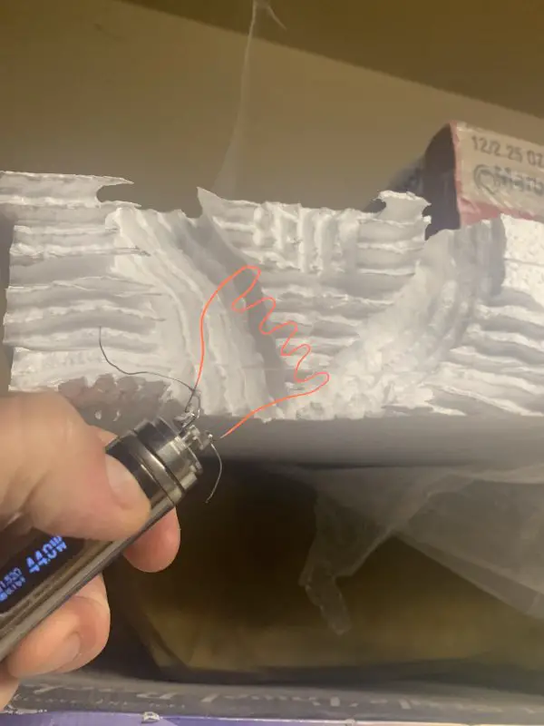

Here’s about 11 amps off a Sony vtc6 3000mah 30a for ya just playing around in foam with a 26 gauge sst form tool. That mod is supposed to go to 75w but it couldn’t push that wire past 55w or around 15a. Also at the The vtc6s I have are just old. Also have two 3500s but the mod alarms out with them at lower state of charge than about 60%. they are only good for flashlight or power bank duties.
Tony that's a rather cool tool electric knife for foam.
