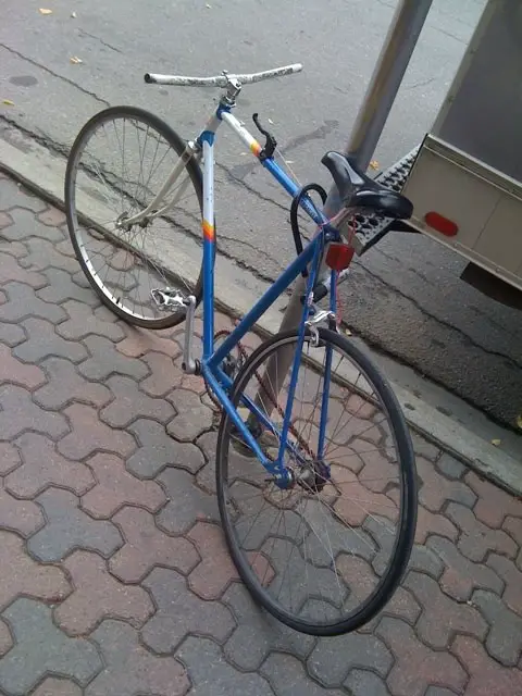

I have seen hipster bike riders put a brake lever on their seatpost, for a rear emergency brake, since they are required by law in some places to have a real brake and not the flintstone panic stop. http://www.youtube.com/watch?v=khWeLXUntBM (video man in pickup with no brakes tries to use feet to stop) Maybe you could put a locking clutch lever on your seatpost (shims from food cans work good), for an e-brake and parking brake.

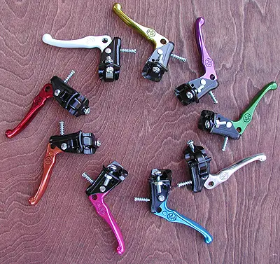

http://luxlow.com/products-page/fix...ke-lever-compact-finger-lever-in-many-colors/ hinged clamp BMX lever (look on junked kids bikes, can also get them from those)

Any bmx store or major bike shop will have them, and thatsdax or most motorized bicycle dealers have them (locking v-brake levers like the happytime clutch levers. The BMX type places will have the hinged clamp levers.
