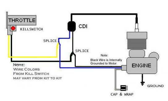

Here's a pic that might help you with the wiring:
I see the picture that the white wire goes no place? this is what I want? just cap it? Then the kill switch wires go into the CDI box wires?
This is completely different from the manual's instruction.
I have a green and a yellow wire coming from the kill switch, green to frame ground and yellow into the white wire.

My wiring is like this...
CDI wires(black and blue) connect into the black and blue wires from motor. Kill switch wires(yellow and green) yellow to white wire on motor and green grounds to frame.
My wiring is drastically different from the above. I did it the way the manual said...
Good idea to throw out that manual isn't it? Nothing has been correct in it so far.
Clip the kill switch wires off for the time being. If the kill switch is bad (and it might be), it may be drawing power from the mag, which is not allowing the CDI to generate a spark. And when/if you decide to wire them back together, splice one into the black and one into the blue. The kill switch will actually work that way.
