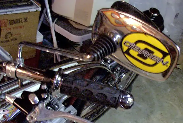

aluminum rod, aluminum sheet, some tin snips, alumiweld, and stick-on blind spot mirrors ($.50)
tapped a hole in the bottom, used an intake stud, and it threaded right into my dia compe clutch lever.
