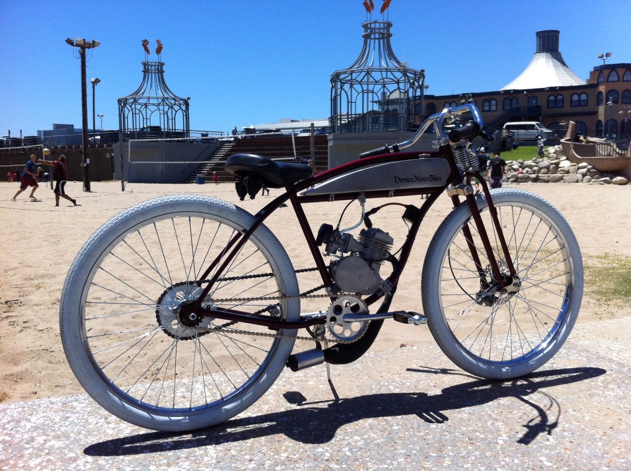

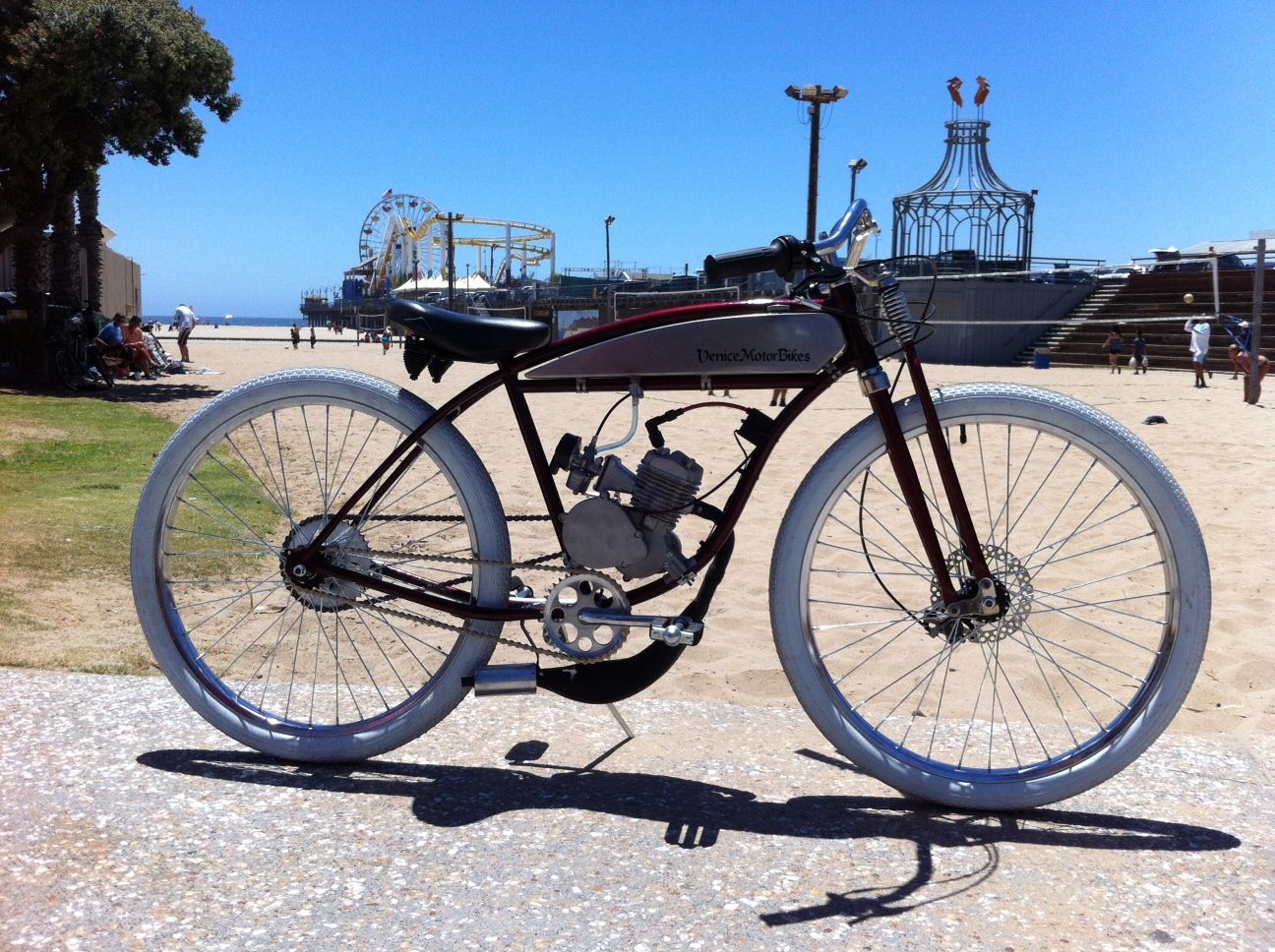

Here's a BTR that I just finished today.... Now I get to test ride it for a few days before shipping it out.
Every one of these I build gets a little better than the last one!
This one has a 4-stage 'blood red' powder coat. It has a 'three port' engine with a Arrow Cycles reed valve & a custom welded SBP pipe.

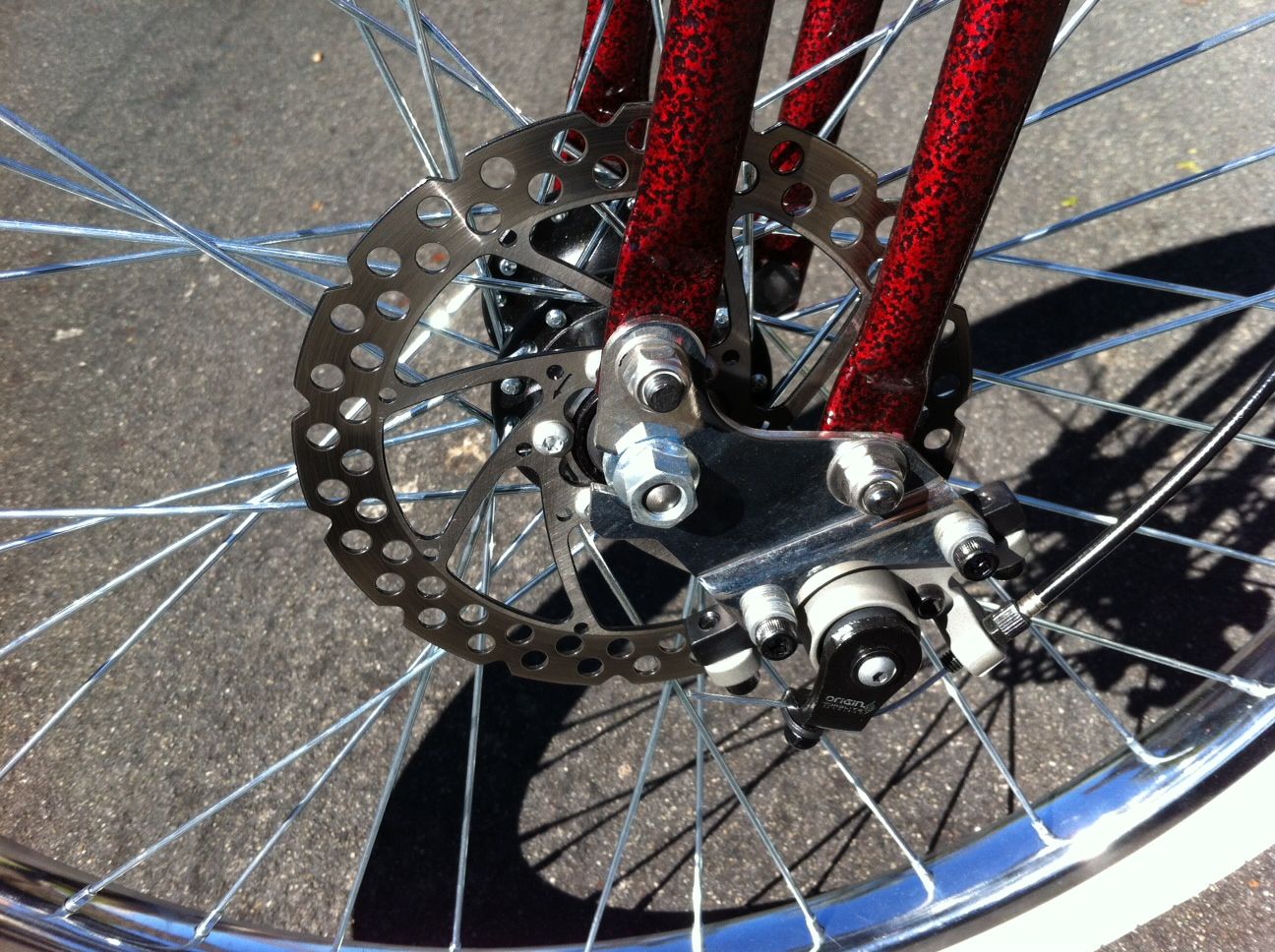

It also has a VMB Monark-2 fork with my stainless steel disc brake dropouts & a Sportsman tank & hub adapter with a 40T sprocket.

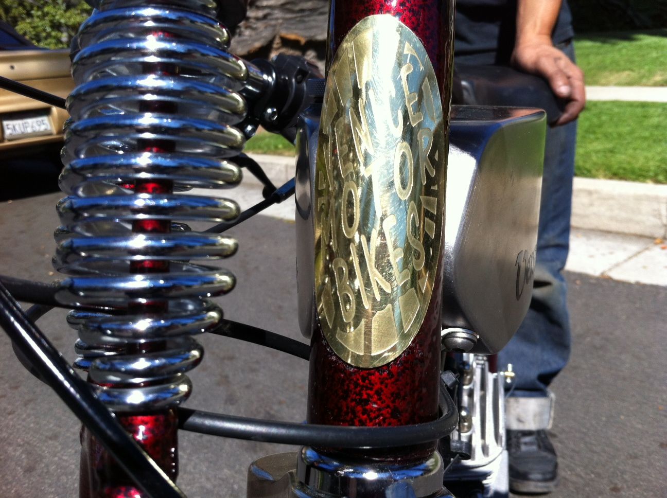

It also has a new VMB brass head badge.

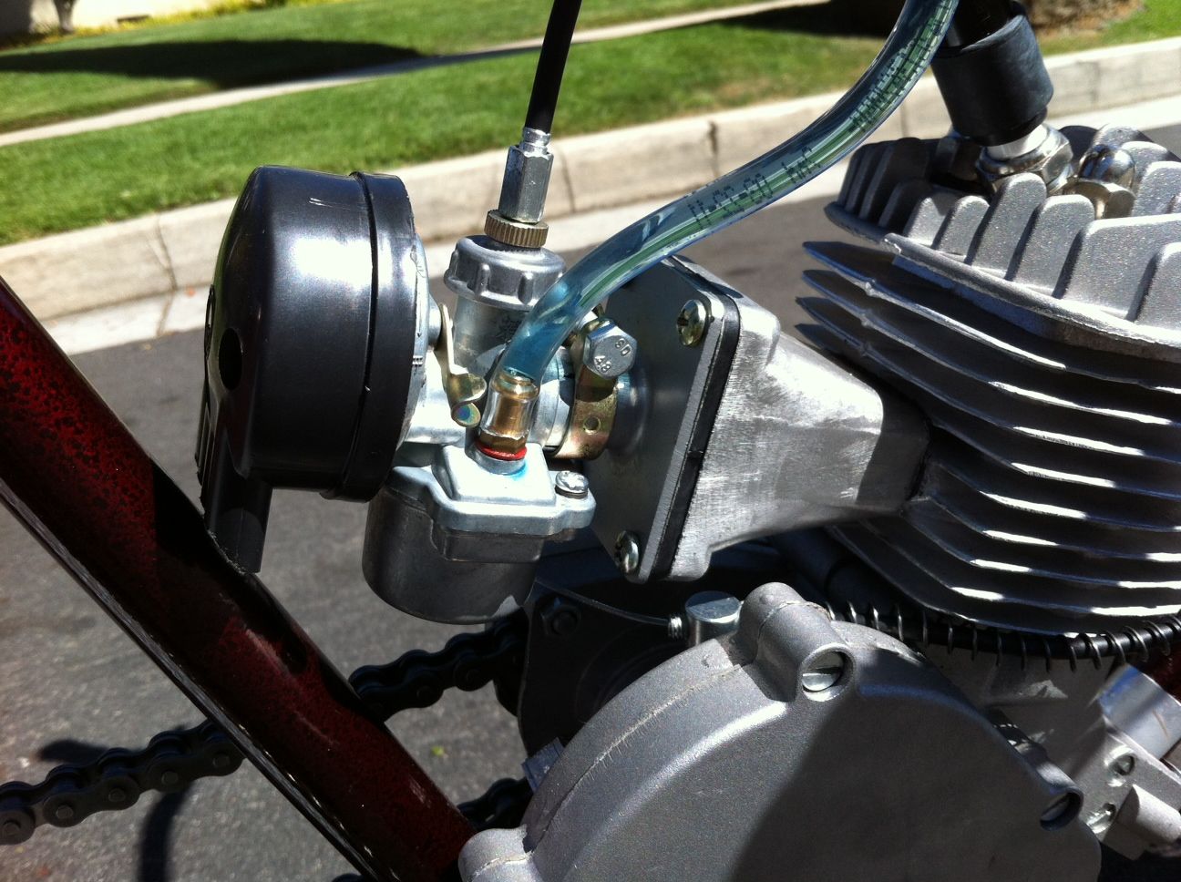

Just curious if you see any improvement using an NT carb with reeds. That is an NT, yes?

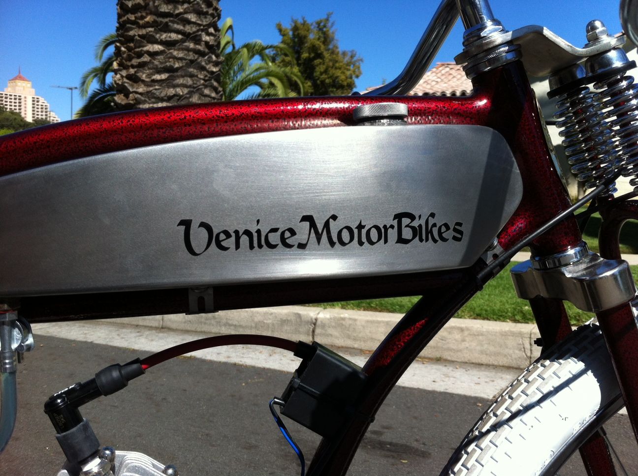

SOOOOO Nice! Tell us about the paint / powdwdercoat whatever. It looks like a process I had done to an old Buell I once owned. A marbeled silver followed by a transparent candy red. Not inexpensive... Worksman frame?

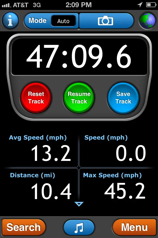

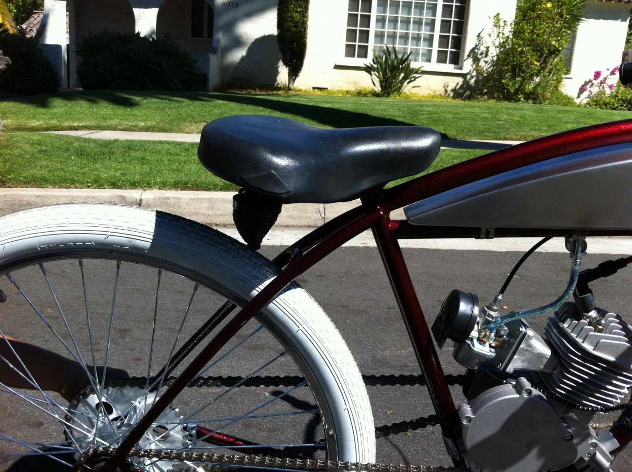

Update... Here's a picture of my iphones GPS from the test ride today... 45.2 MPH on flat ground!!! :eek:
I'm learning a lot of new tricks to make these reed valves work on these HT engines!
Yes, thats a stock NT carb with the stock jet; & yes it's a 1951 Schwinn Panther frame.
The powder coat is a 4-stage job... first black, then 'speckled' silver covered by two coats of dark red.

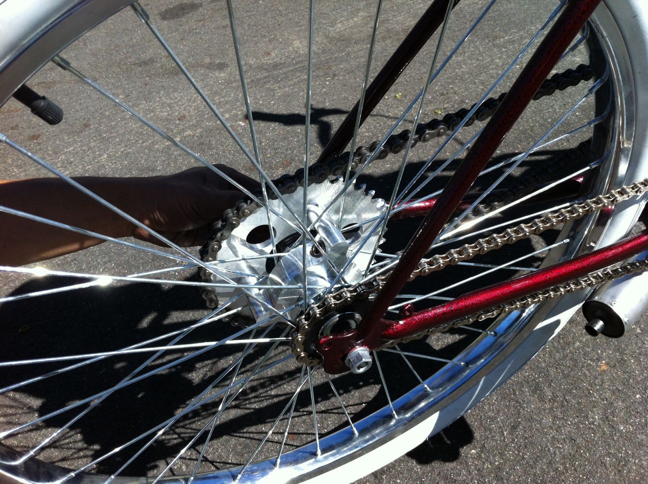

Here's some pictures I took of it while out on the test ride today...

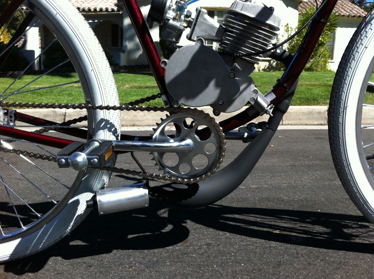

Reed valves and expansion chamber, eh. If I know Norm, he did port-matching, balancing, and who knows what else. But stock carb - hmmm...
And all of it on another totally slammin' bike. Nicely done, Norm.
Venice Motor Bikes
Mar 20, 2008
7,333
1,967
Los Angeles, CA.
I have to admit that I got real lucky on this bike... I didn't split the cases to port match the two main transfer ports; Instead I matched the base gasket to the cases & then did some ginding to the cylinder to make it match as best I could.
I did do a 'big dog' third port & a large transfer hole in the piston.
As for the jetting, I just kept testing & drilling it bigger & bigger until it didn't need the choke to start.
It runs a little rough until about 35MPH then it hits a sweet spot where the pipe comes on & it smooths out & starts really gaining speed.
