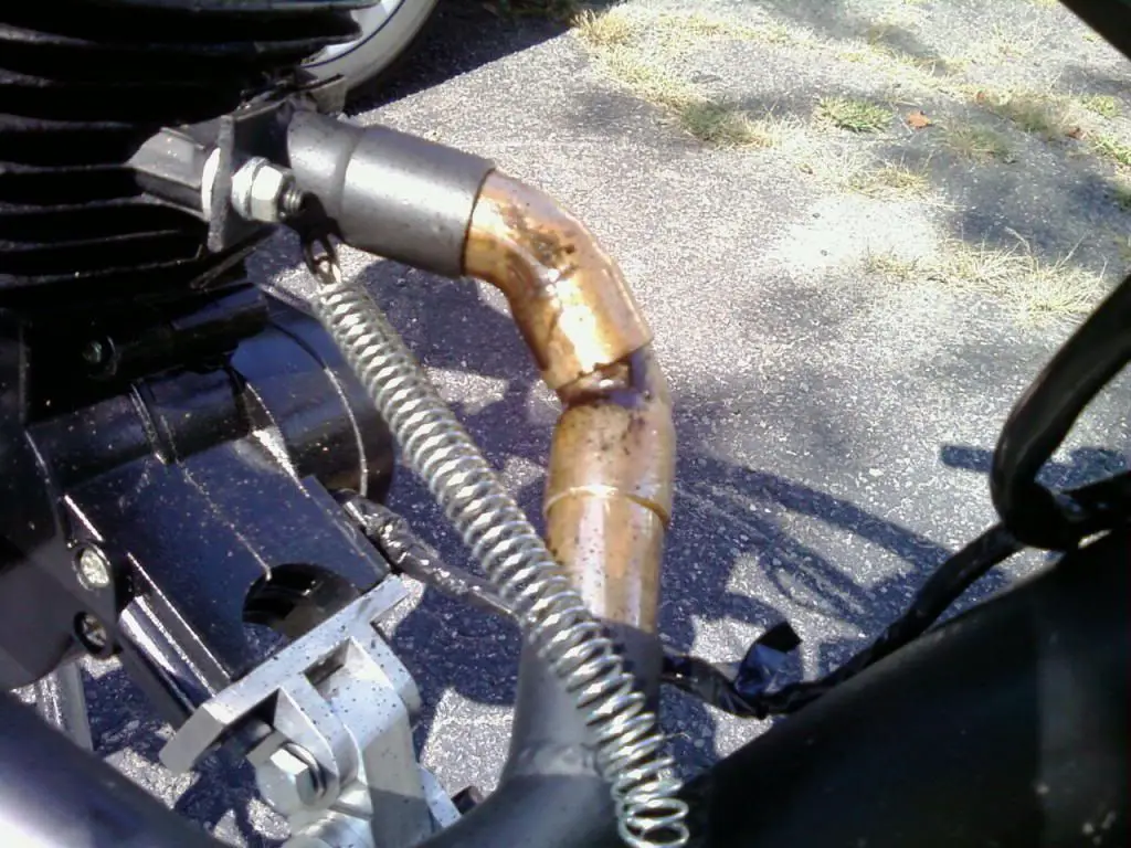

  18. chainmaker
    chainmaker New Member
    Joined:
    Jan 19, 2010
    Messages:
    2,597
    Likes Received:
    So this is the oil seepage I am wondering about from the 2 joints. Is this reason for concern, I am planning on cutting some slits on each joint to allow clamps to get a tight fit.

  19. GearNut
    GearNut Active Member
    Joined:
    Aug 19, 2009
    Messages:
    5,105
    Likes Received:
    Some oil is normal, but if the engine is running rich you will get more oil residue in the exhaust.
  20. GearNut
    Joined:
    Aug 19, 2009
    Messages:
    5,105
    Likes Received:
    I just saw your pictures. It looks normal to me.
