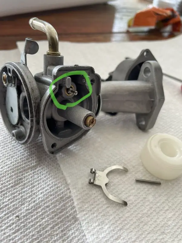

Problem: i have a nice running (usually) 80cc bike i am running 40:1 mixed myself. My bike is currently awaiting a new spark plug arriving tomorrow because its fouled (think its a NGK B6L.) I think my problem is my petcock or bowl etc. I have a friend who while hes riding leaves his petcock on. If i do this first of all it fills up ands leaks out of the air intake, second if i leave it on the bike eventually sputters down and stops. Then I clutch, turn off petcock and keep riding untill i need to turn it on again once my bowl is used up. One solution I have is to open the petcock slightly which kinda works but im fairly sure that the float is supposed to float up once full and prevent more from entering.

thanks for the reading, in the comment before you meant debris would be in the jet end where the needle goes in? also i read the reading and if i were to bend the float things to make the engine leaner and not flood what would be the best way to go about doing that
If you remove the carb, after cleaning out the needle and seat, invert the carb. Install the float with the needle attached. The float should be parallel to the carb body. Bend the tang on the float to achieve this. Reattach the float bowl and install the carb.

i tried to blow air into the fuel intake while manually pushing the tang needle and the air flow was never cut off it was continuous, even letting more air in i pushed the tang
cleaned it up and the connection slider was bent out so i rebent it to keep it in it should open and close without issues. still wondering if b6l will work
