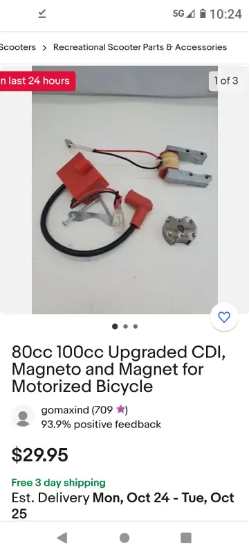

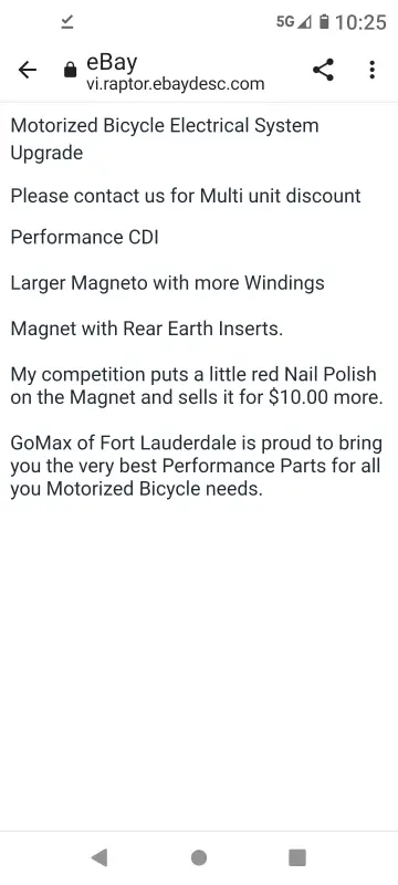

This is the only one recently that has all the top parts in one place... You can adjust the timing with a star washer with a tab bent over to retard the timing if needed...

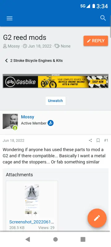

I've been messing with the G2

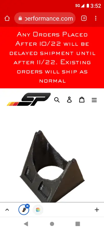

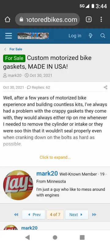

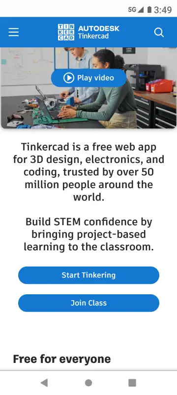

Smolik sells the stuffer block or you can 3D print one and theirs a member on the other forum that has made me custom gaskets in the past...
