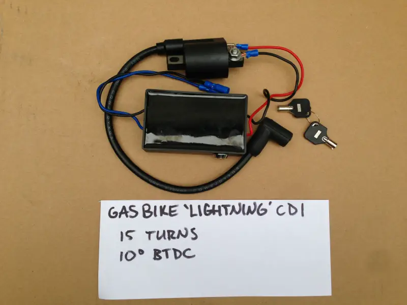

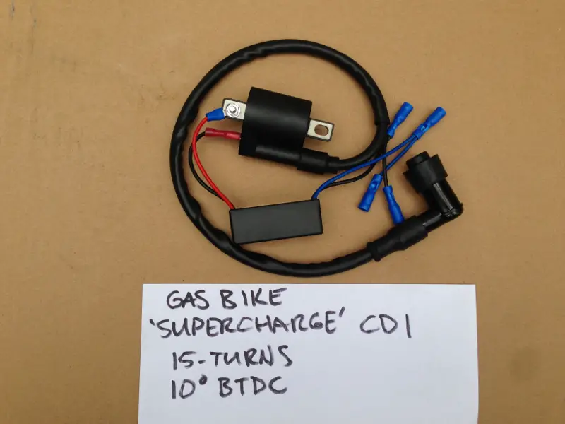

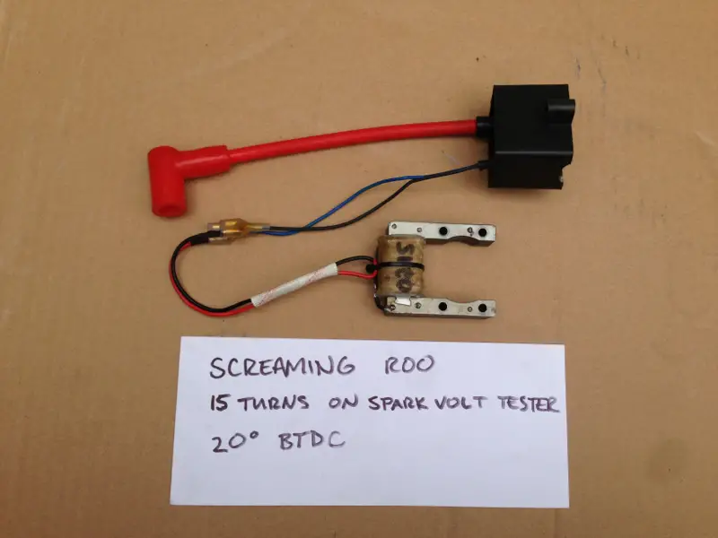

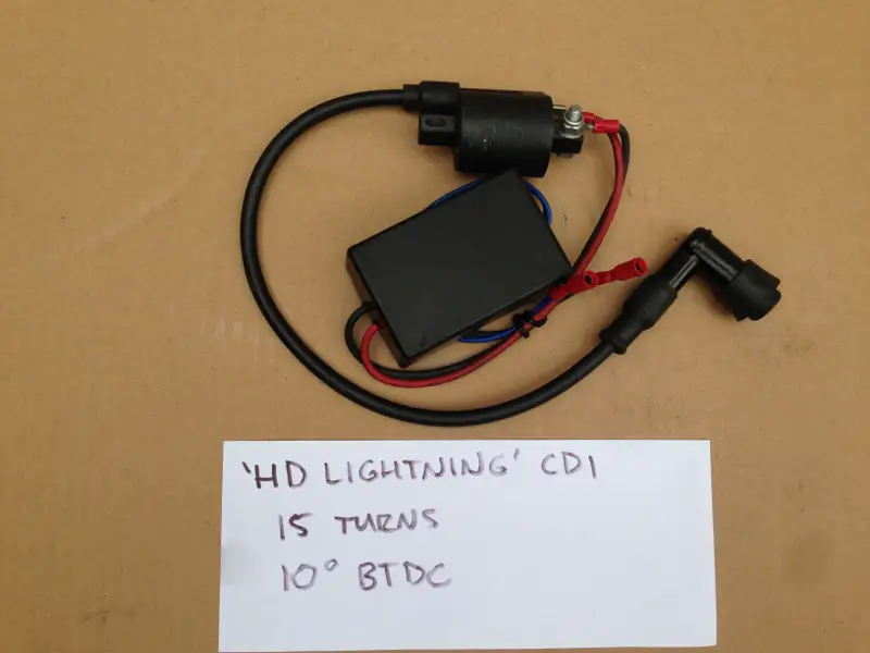

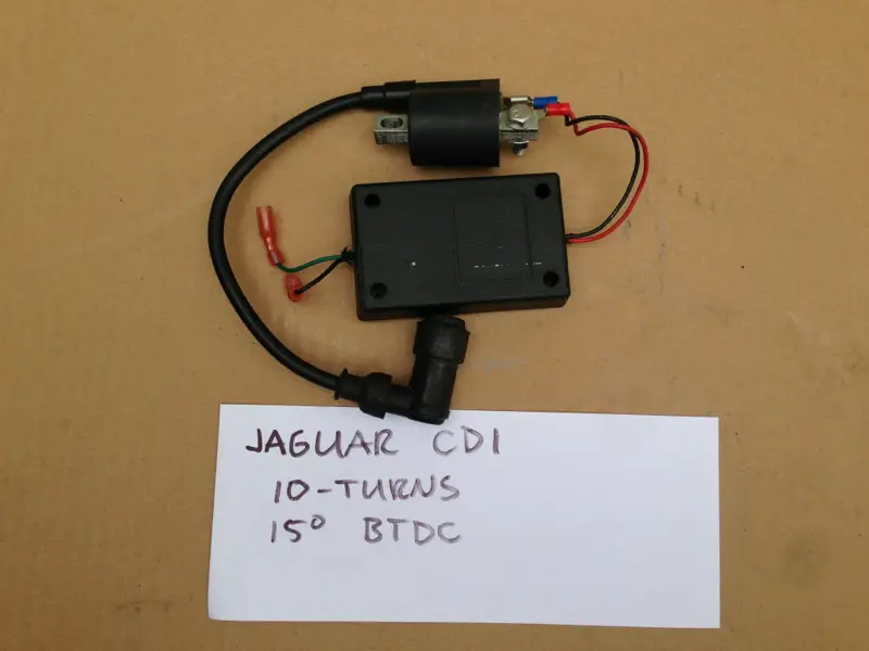

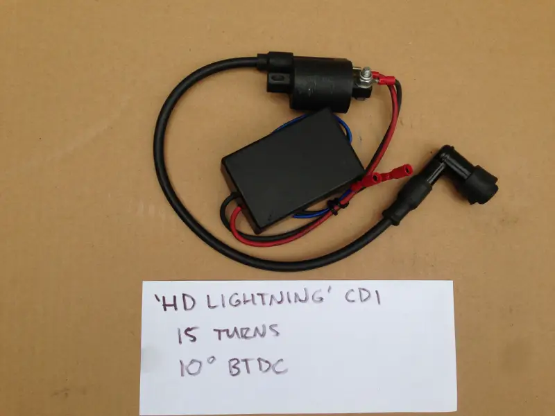

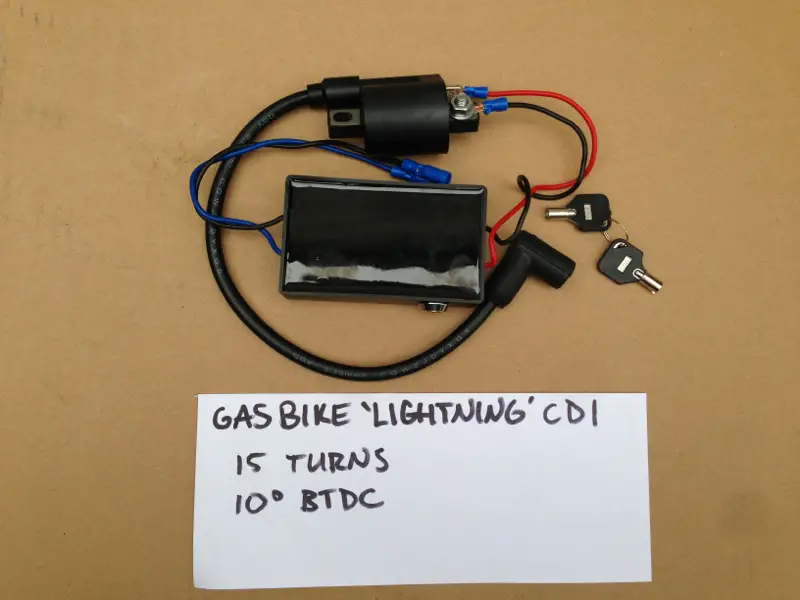

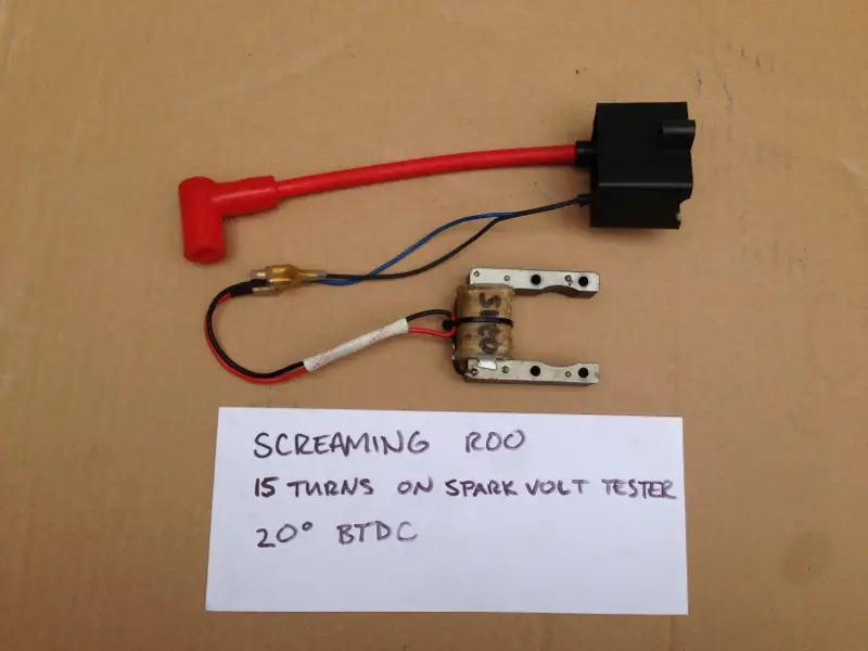

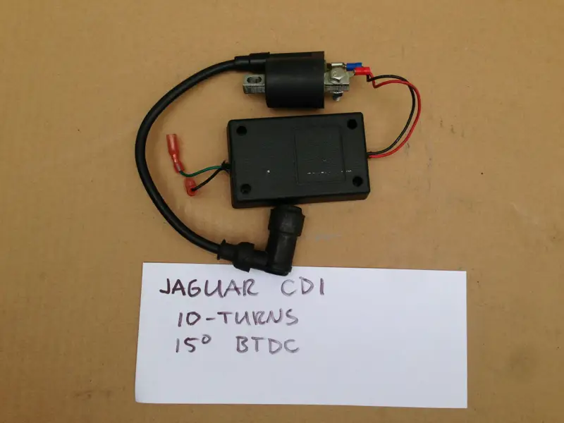

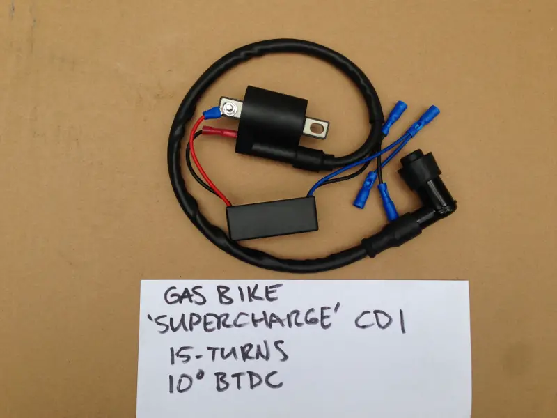

Here's some of the different aftermarket CDIs that I tested with the results...
*edit*>>> The numbers posted are the total advance degrees @ 3000 RPM, & the 'number of turns' is the total outward turns on the coil voltage tester.
All the CDIs that I tested (even the stock Chinese black boxes) have a advance curve of roughly 25-30 degrees.
Most of the stock Chinese boxes maxed out around 5-10 turns, (but one particular Chinese box maxed out at a whopping 20 turns)!!!
My 12v timing light was having a bit of trouble reading the 6v sparks at low RPMs, but I was able to see quick flashes of where the timing curves started.
Gas Bike just re-named this the 'Super Rocket' CDI
Gas Bike just re-named this the 'Thunder' CDI.
So after digging a bit I have come to the conclusion that the Gasbike CDI is being sold with different names from other vendors. However the CDI ignition coil can be ordered from aliexpress.com for a whopping 1 USD. I am unable to find the box which they use. I'm pretty intrested in finding out what it is. Because BikeBerry sell their between 30-50 USD (no key lock and keylock). The ignition coils appear to be 12v. I had a major preformance boost with BBR Tuning Stage 2 12v box. I without any doubt would find them to be The same timings. The Stage 2 Box however is a little larger. Has anybody been able to pin point the name to this mysterious box? I guess their called Ignitors.
