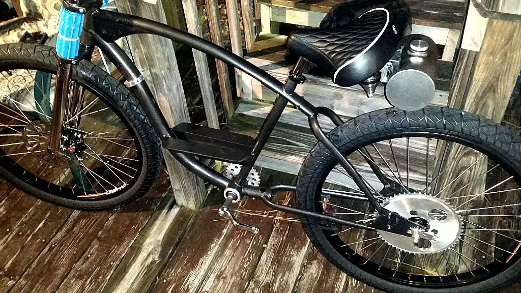

Here she is....99% complete. I just have to do some final detail work and I'm in the process of making a front motor mount. She runs good, real good! I cruised at 37 mph for a good mile with no issues at all!
But, I should have listened to everyone and just got the Noram cheetah clutch. The high stall max torque is a big piece of poop, but I was impatient and wanted to ride and save on money....now it's showing. Looks like I will be buying a cheetah this weekend!
I'm happy with my exhaust. I welded it myself using left over handle bars. My welds are not the prettiest, but it doesn't matter because I wrapped the exhaust in header wrap. Can't wait to start another build!
Here is a little better picture with better lighting. I just love this bike. Fires right up on first pull every time. Rides like a dream, too!
