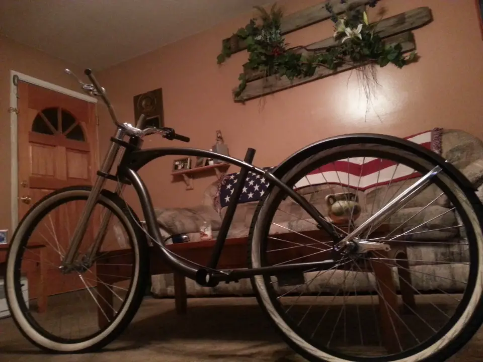

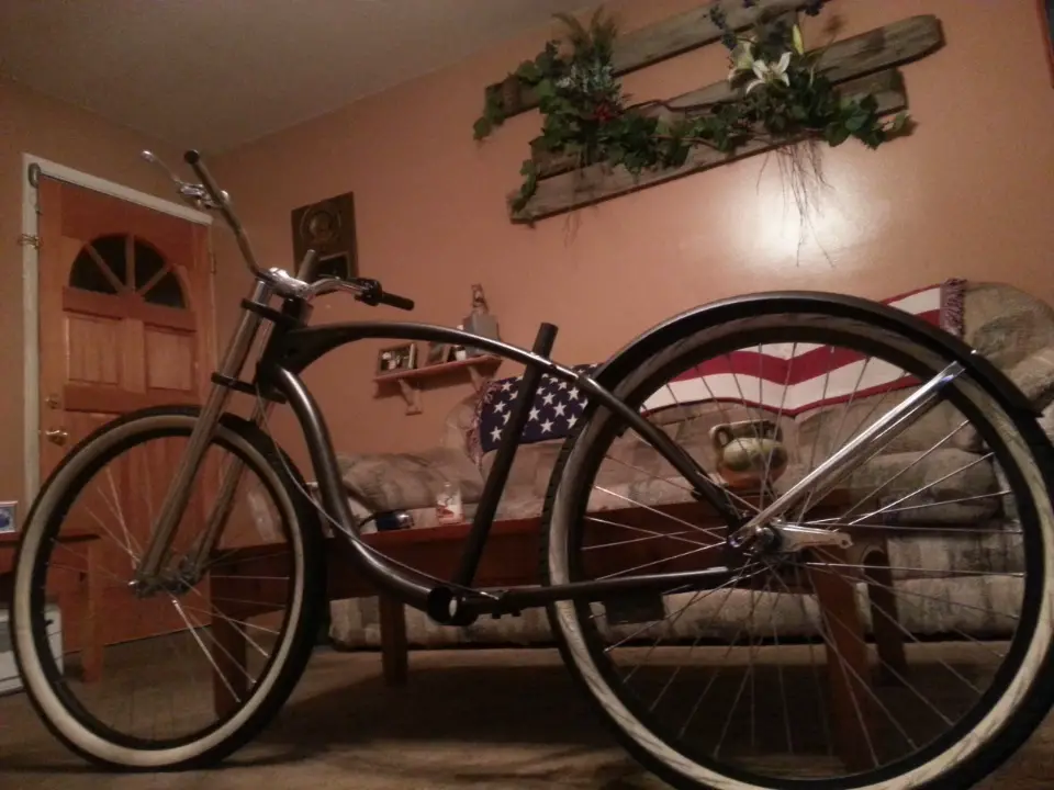

Here are a few pics. I was board so I mocked the bike up. I'm still waiting on my wheels. And, no fenders. Lol. Paint is not quite done as well.
What do you guys think of the white walls? I'm starting to like them... I was wanting hookworms, but the more I look at the white walls they are growing on me.
That's awesome!
Like said love the white walls, and the extension they give a little more room for wheel also..............Curt

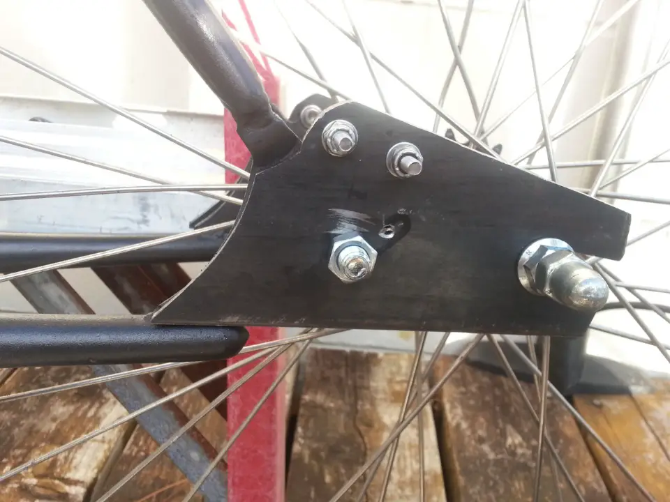

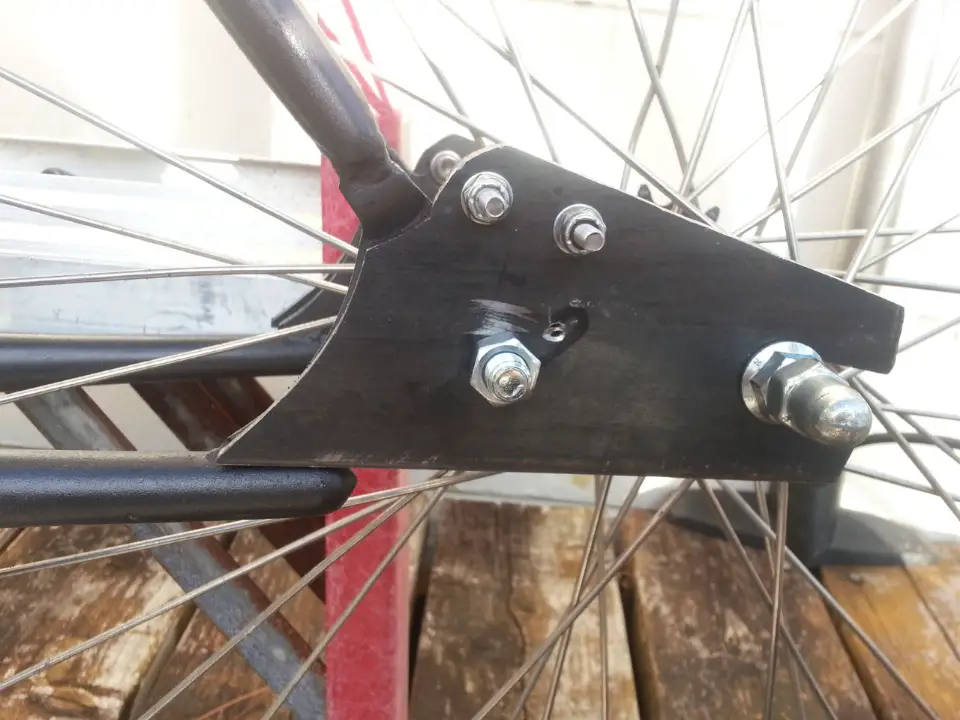

Finally got the dropout extensions finished. Just need to do a little fine tuning and then get them welded up!
I have an image in my head of how I want the bike to look, but when I actually look at the bike I realize it is going to take a lot of work!
Be Kool if you could find some button head allen bolts and put the nuts on the inside.....Just my thoughts..........Curt

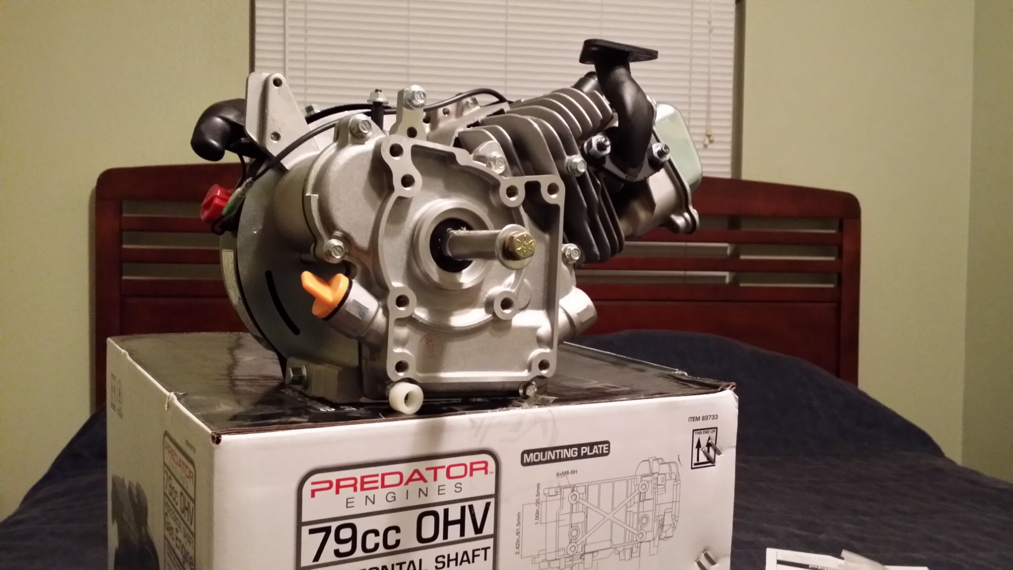

Picked up another one today.....
I ordered a shaft bolt kit from AGK. It came with a white, plastic spacer. You can see it in the pic. What is it used for because it doesn't fit over the shaft?
Nice lookin bike I believe the plastic spacer will go on the bolt after washer to take care of space at the end of the shaft.
If your going to weld that drop out in I would make it wrap around the frame.This is how i do mine on my higher power builds on my Schwinn frames . If you do it the way you have it you end up with a really weak point above your drop out .Just my two cents and could save you some aggravation down the road .
