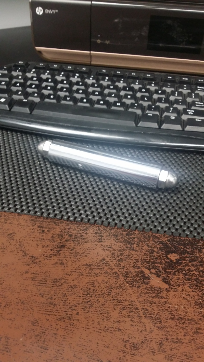

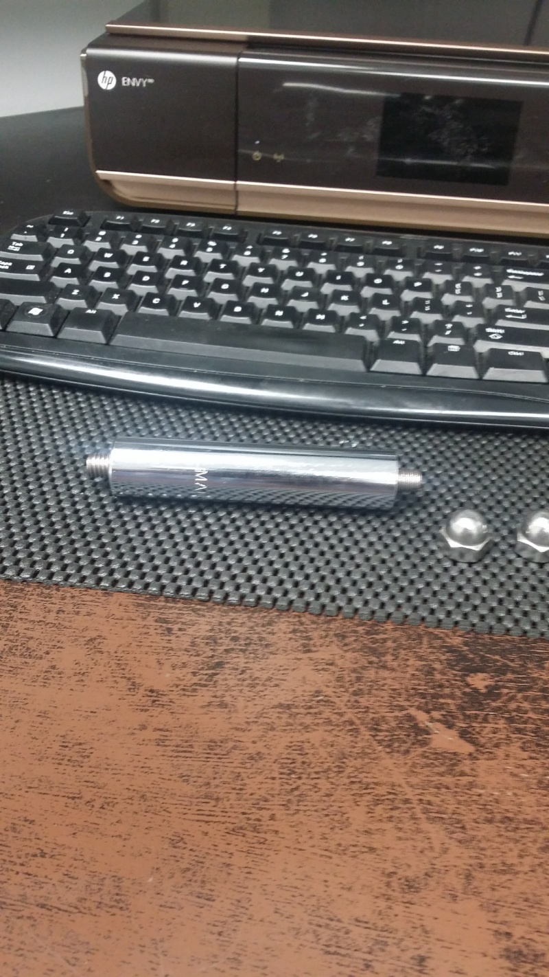

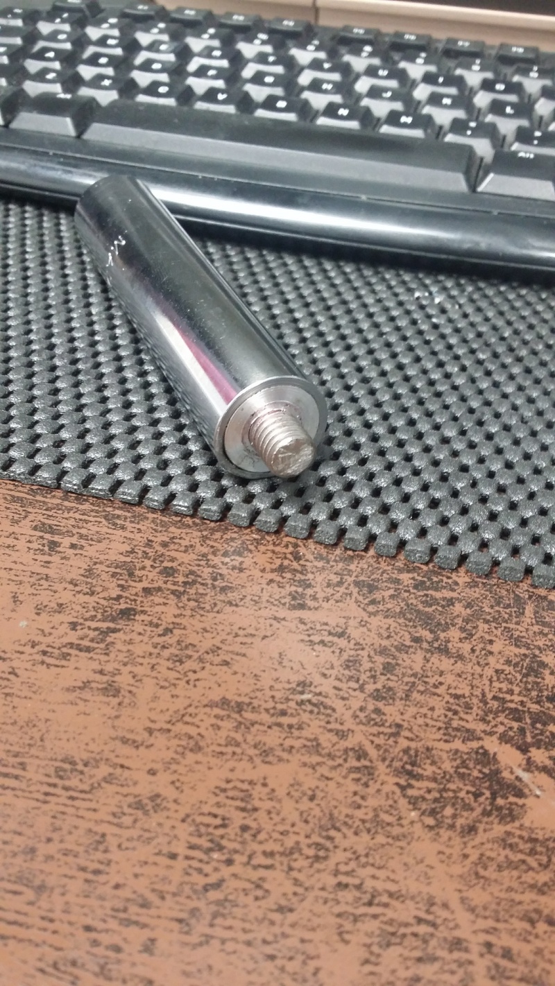

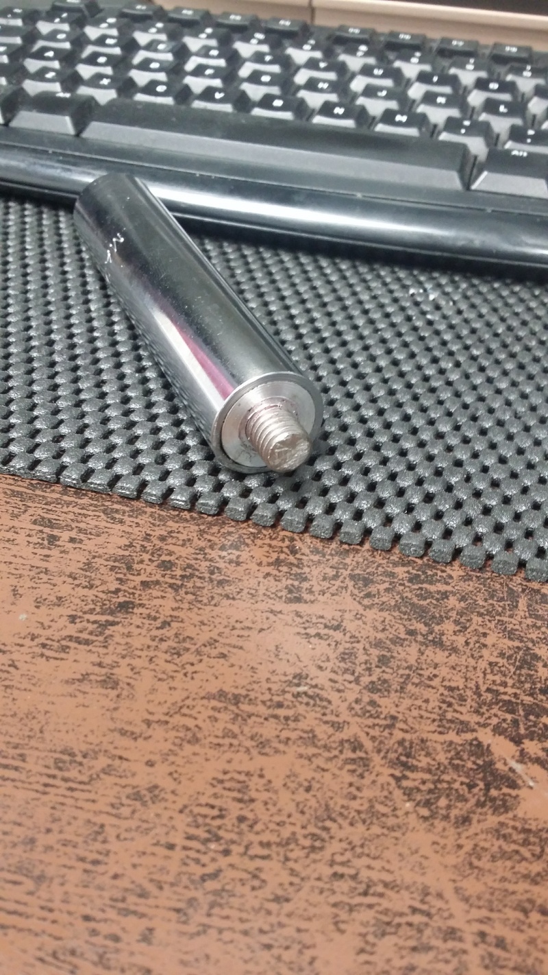

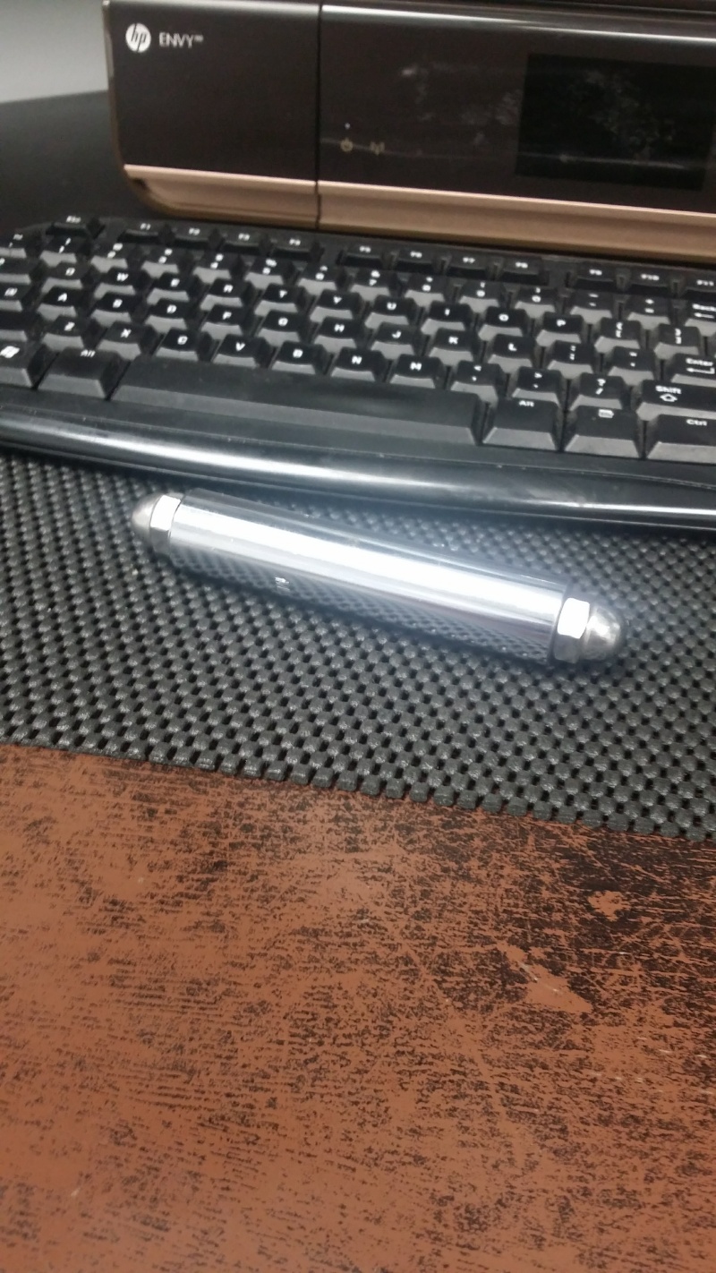

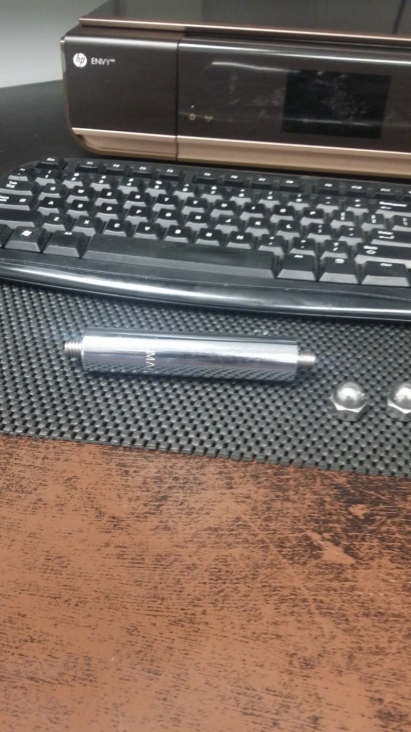

http://www.ebay.com/itm/Chrome-Moto...ies&hash=item2586418de1&vxp=mtr#ht_711wt_1124
I've been working on a front headlight mount. I used the above fork brackets and cut a piece of old handlebar to the correct width. I then used the lathe at work and turned down some aluminum, drilled it, tapped it, and pressed it in the handlebar....
Awesome simple mount,love it. Just had to order a set of them brackets.
Great job on the build looking really sharp.............Curt
