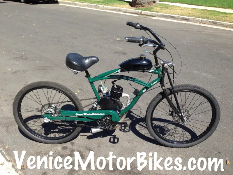

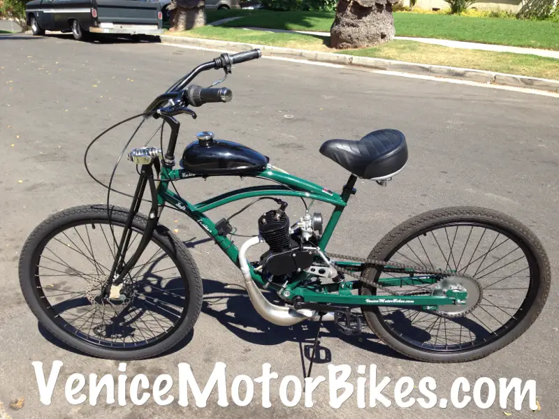

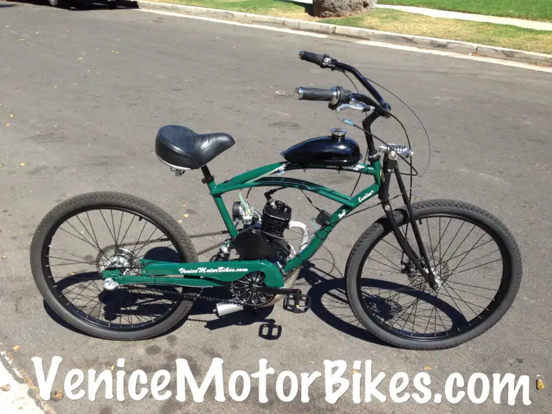

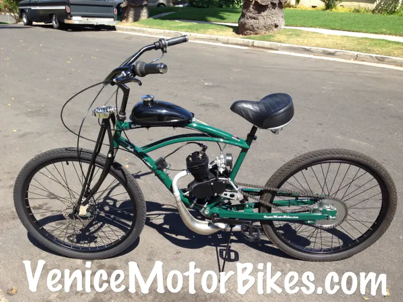

I just finished this bike for a customer to take to Burning Man.

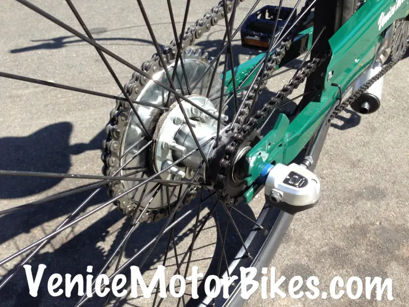

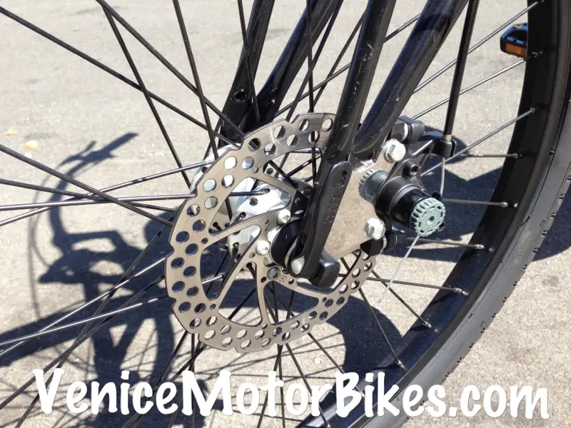

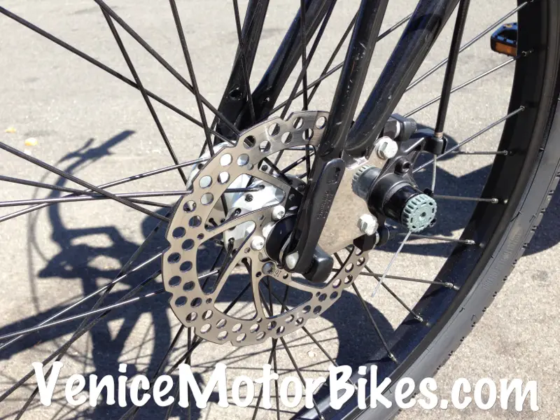

I custom built a set of heavy duty alloy wheels with a Nexus 3-speed hub & a front disc brake & welded a SBP pipe to give it more power.
This bike rides super smooth!

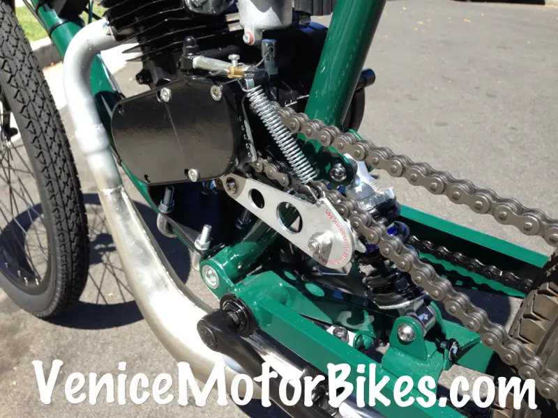

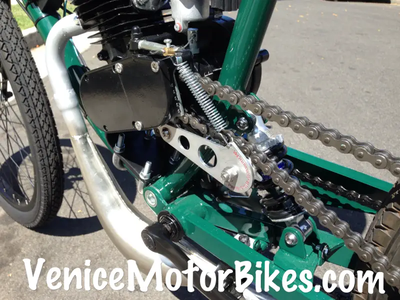

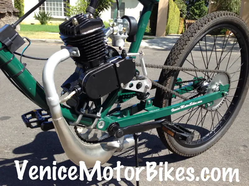

Did you have to do anything to the spring tensioner to keep the chain on?
Is there any slop in the rear end?
I added a heavier spring to the tensioner, & I also hooked it onto the clutch arm to give it more 'pull'.
The bike's made by RustySpokes.com , & there's no slop, but the swing arm does have some 'flex' to it, (but nothing too bad).

Nice Norm....I like the old "Rusty Spokes" but that actually looks like a newer one. If the customer was willing to pay for some extra cleanliness, I'd have built him an in-frame tank and mounted the coil under the engine on the bottom of the seat tube by the BB. It's just me and the peanut tank don't see eye to eye is all ;)

Ya Scott, I hear ya about the tanks.
I do everything i can to use custom tanks whenever I get the chance... but this guy already spent plenty on this bike. :rolleyes:

great job, Norm. That's a very clean build and a I think something that a lot of folks have been wanting to do / see but havent been able, or have been scared. You may have opened a door to a whole new wave. again, great job.

I decided to do some testing of how well the chain would stay on during real heavy riding & managed to pop it off... So I added a Arrow case saver, a tall spring arm & another spring.
So far it's working good & I haven't had any calls from the customer about any problems. :)
