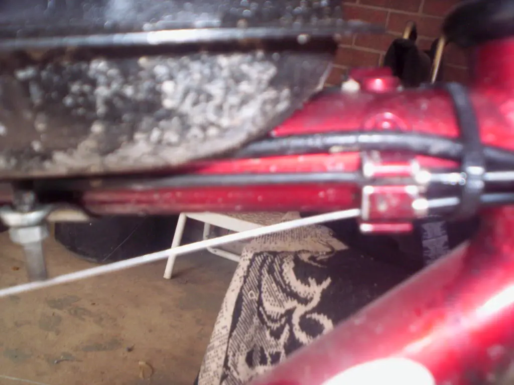

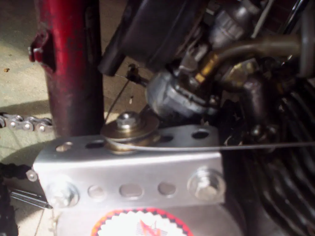

2) That clutch mod. I'll post more. That bike is no more. MOOP2 is my reincarnation with this mod on there.

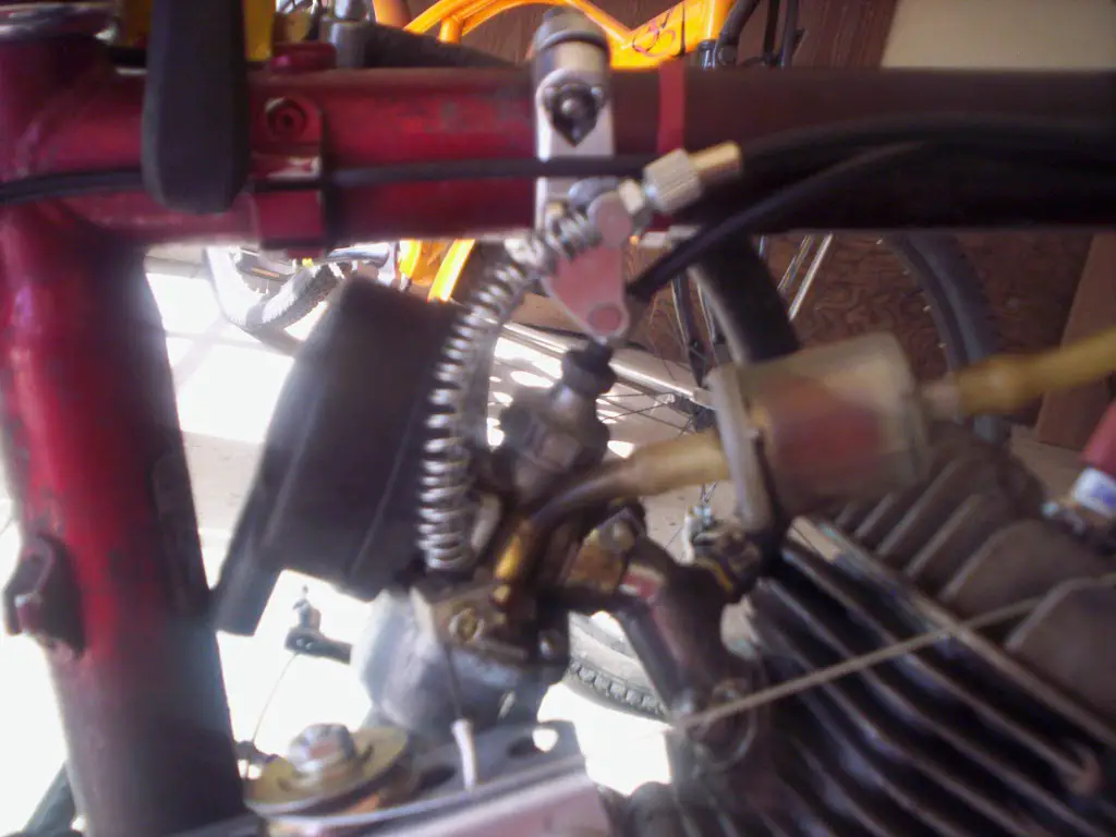

3)Auto choke made with parts lying around. This clamp was a front derailer.

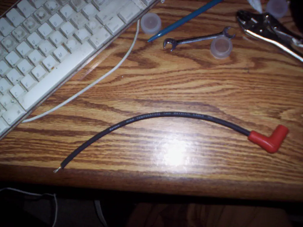

4) Replacement wire from NAPA. It's a solid steel wire inside. just about three bucks for the whole thing. The solid wire screws into the CDI really tight and it's 7 mm. The NAPA store I went to was a national distributor store so you may have some trouble finding it.

Yes sir, Large you were the man on that one. It was one of my favorite mods.
