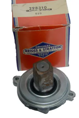

Equivalent to the paul clutch
My Briggs engine has recoil starter with paul clutch between it and the crankshaft.
China Girl Engine would have probably different part needed like 57H had mentioned Craftsman Ratchet Adapter, same idea though.

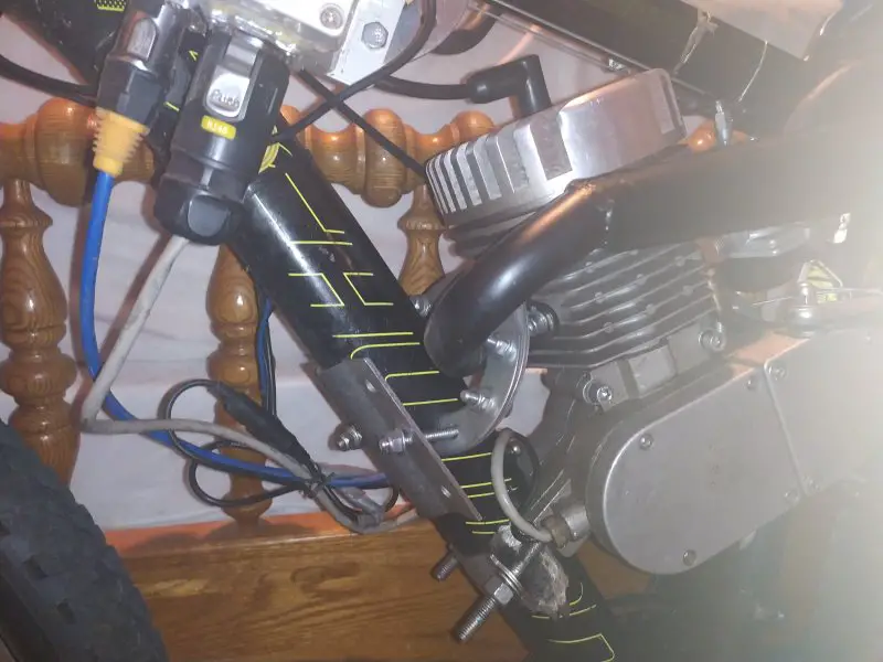

Mount your exhaust to the frame, keeps u from overtightened motor mounts and keeps your engine from drifting to the left on the drive train side, I usually use extra motor mounts
