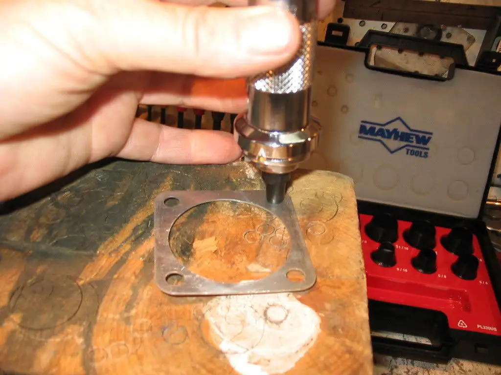

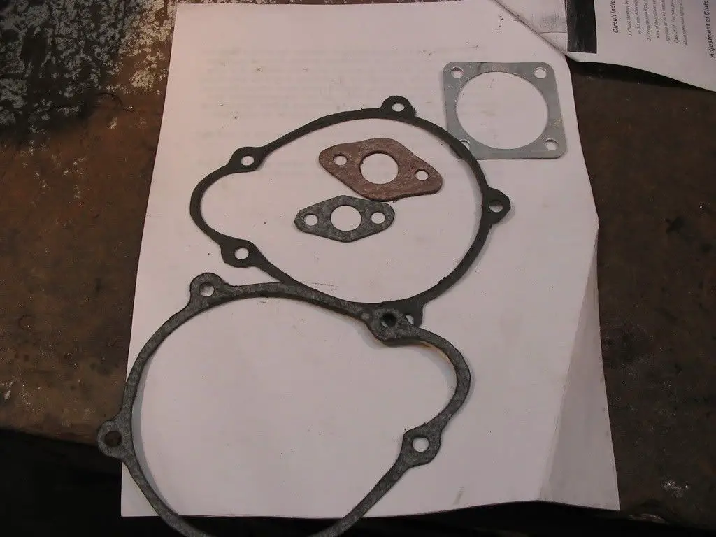

When you first get your engine take the time to make good gaskets use the kits gasket as a pattern and use your home made ones. mostly the side covers,intake and exhaust will be the ones to make here's an example.

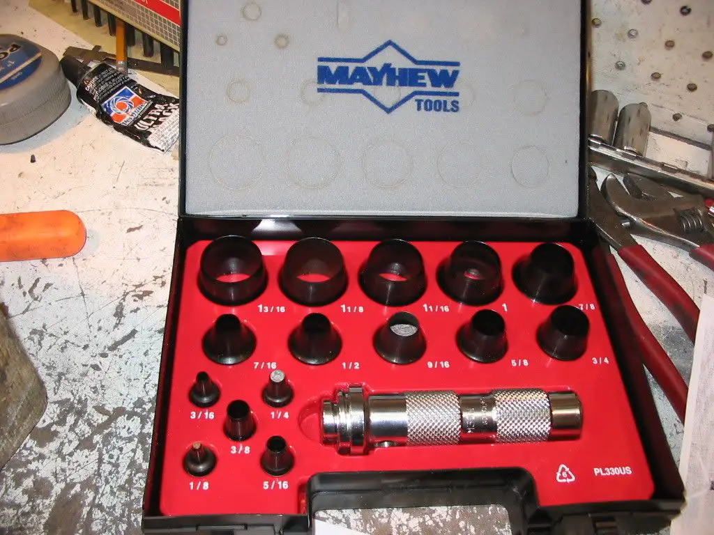

Here's how I get the nice holes. you can cheat by using the right size tubing and sharping the end. Most important I think is the wood block using the end grain this will make the best backup. another tool for holes is a leather punch. You all will come up with other ideas I'm sure so share them.

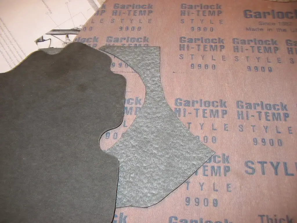

Get good gasket material I go to a shop that makes oil field industrial gaskets and these guys let me have scraps. The picture shows examples the high temp material will work good on the head and exhaust believe it or not.

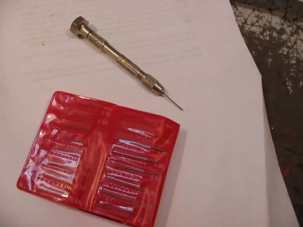

If you just gotta work over the mainjet by soldering it closed and redrilling may I suggest a set of these drills and pen vice. I got the vice at a hobby shop and the metric micro drills at a gun show.
