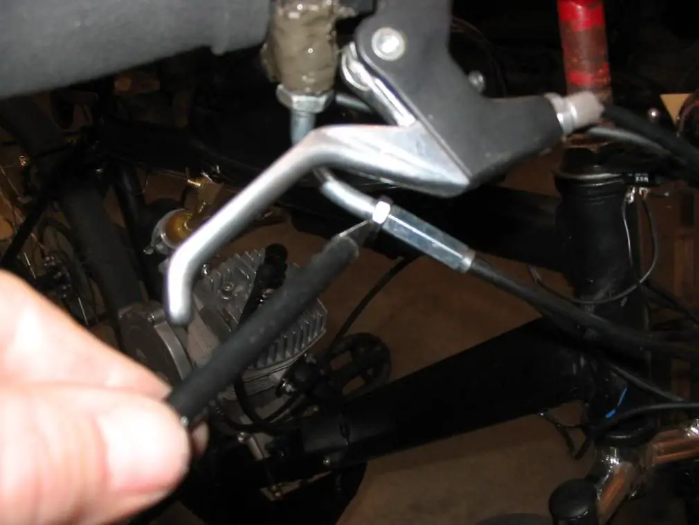

pen pointing to an adjustment area for taking up slack on the throttle #2 pic my throttle cable has another adjustment up at the twist grip to take the skack out of the throttle cable.#3 all done. #4 its running and its cold .

Quick question. How mych play should there be in the throttle cable. There doesn't seem to be any slack in the cable at all is that wrong?
So I should get alonger cable? I have loosened at the handle and at the carb. I have given her all I got captin. lol

Hi Norman, Can you tell me the best way to adjust the throttle adjustment area? I put a new carburetor on last night. That made my leak go away but I have lost a lot of power. I tried screwing the throttle cable at the carb in more but it only made it worse. Now I'm thinking of going the opposite way.
Can you give me any helpful hints on this?
Thats it hope your questions got answered if not give me a PM.
Norman
to take the skack out of the cable lengthen out those areas. what this does is make the outter housing longer in relation to the inner cable.
