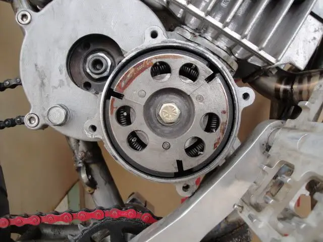

The reason these motors need to engage at a high rpm because it needs to engage near the power band or your bike will bog and sometime will not run if the engagement is set too low. I'm pretty sure its the 3 shoe so you can adjust it by removing the clutch and barely back out (1/8-1/4) the screw in the center of the shoes. Dean made me a new intake manifold for my bike that kicks the carb out to the side so I can install a different air filter. I'll post a picture of it soon.

the clutch engagement has to come way down, it's way to high, kind of like your drag racing just to make it go, theres no way i would try to ride it through town the way it is. i'm going to adjust it as soon as we get back from ventage days this weekend, no way i'm going to ride it for 5 hours like this. we'll see what early adjustment does to the break in.

GH had a 2 shoe clutch and stretched his clutch springs and his bike wouldn't run after that until he replaced his clutch with a 3 shoe.
You can ask Jim Manic Mechanic how he adjusted the clutch to engage at a low rpm and the bike can take off from a dead stop with no problem. and since it engages early it is less wear on the clutch and certainly will have no effect in reaching top speed and rpm since it is fully engaged. I am not making a video you can take Jim's word if you don't care to take mine. It is a 2 shoe clutch and it is the 5.8 motor. I do believe you can achieve almost the same results with the 9.4 although you probably have to engage a bit higher. Who wants to engage at 11,000 rpm anyway?

Well if you want an on/off situation then engaging at that rpm is fine. But if you want to ride at all different rpms then your clutch will be slipping and heating and wearing prematurely. There is no downside to engaging earlier. As long as you have enough initial rpm to keep the motor running. With the 5.8 it is very comfortable at all speed ranges with Jims mod. As a stock 5.8 it was not that rideable and clutch slipping would have destroyed the clutch in short order. Judging by other Morini Clutch Problems posted here that is probably the biggest reason for clutch failure.

i probably have 500 miles on this clutch total, and half of that is with this configuration of reduced weight and more spring tension. it probably engages at 3000-3500rpm. i would like to be engaging a little higher, but i dont ever have to pedal, which is good because the clutch sticks out too far and stops my crank arm anyway.
the point is, all you have to do is add weight or reduce spring tension to achieve what you all want. if you add weight, try to add the same amount to the same places on the shoes. springs are fairly consistent if you can find them locally.

i haven't had the cover off to look yet, but the paper work says there are 3 arms with clickers on them, turn ccw to bring the clutch in at a lower rpm. with the gears in the nv all the low ranges are just about useless with the high rpm engagement, you have to be about half way through the ranges to get a little speed out of it. so it should work well with a lower rpm engagement since the gearing will still let it rap out before you up shift. the rear wheel cocked over on me today so i'm making toruqe arms to beef it up. it's just so radical engaging at that high of an rpm that it's hard on everything. once i get the clutch dialed down some i think it will be a lot of fun, as it is now theres no cruising, you just blast up to speed, then coast and then blast up to speed again, not realy fun riding like that.
