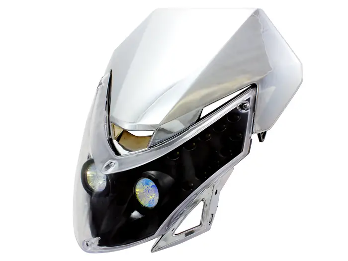

4. Also going to get a streetfighter light from ebay like this one
These are pretty cheap and I live right next to a motorcycle repairshop. They said they'd be happy to lend me a hand if I brought a finished bike with the light and weld something up for me to mount it.

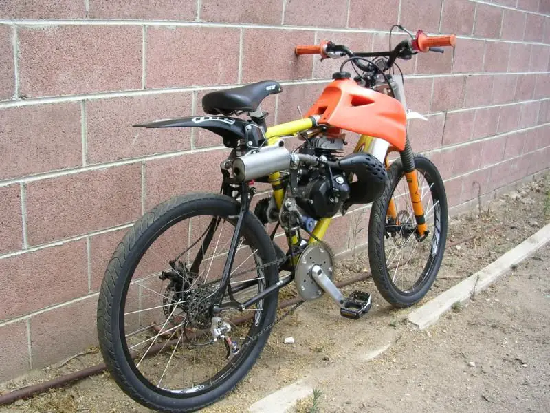

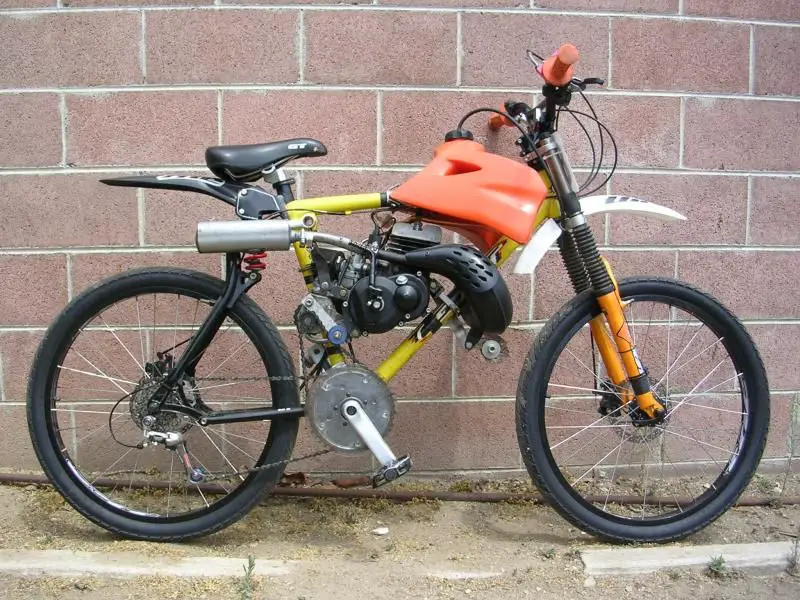

There are very few full suspension bikes that will work well for a motorized bike. Heres my full suspension GT LTS with disc brakes and a KTM clone with a shift kit. I also built one like it with a China Girl instead. With a shift kit you don't need to worry about the suspension pivot location causing the chain to get slack during its travel. It takes some fabrication to build a suspension shifter and the cost gets out of hand real quick.
