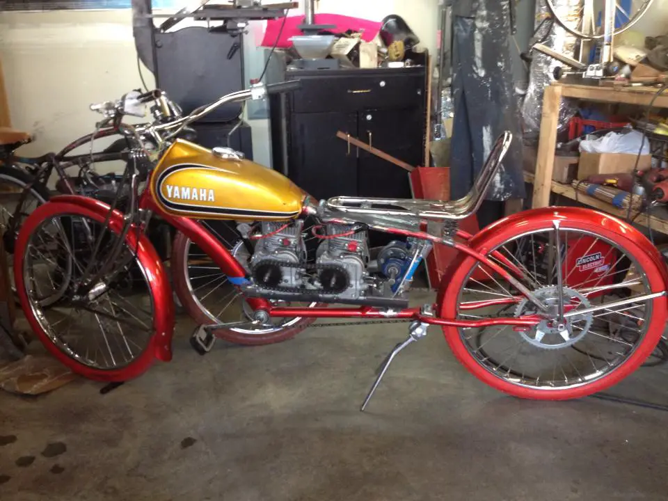

Just saw that Pic. It's the "Cats Pajamas"! I like that you added the Yammy tank. I'm having the same thoughts. The stocker's look too whimpy, if you know what I mean.
I'm thinking a tank like this, if I go the chopper-bobber look..

That tank is sic. But it cost a ton. eBay is my friend. Tried to PM you but it said you didn't toggle PM on.
Click my name see my threads started you can find my other builds. Most of all I build I state where I got parts from and what the cost was but you will have to read from the start and follow to the end to find the vendors etc.

yeah that tank turned out very nicely, too bad it's mounted on this......but, they are available for about $60-125, not counting the resto work and chroming, finishing etc.

Looking through your post, you are a "force de rigueur!"
I see nice workmanship and well thought processes. However, I do realize it's a work in progress and constantly evolves. I'v been there, as well.
Still, not taking away any shine from your work......
