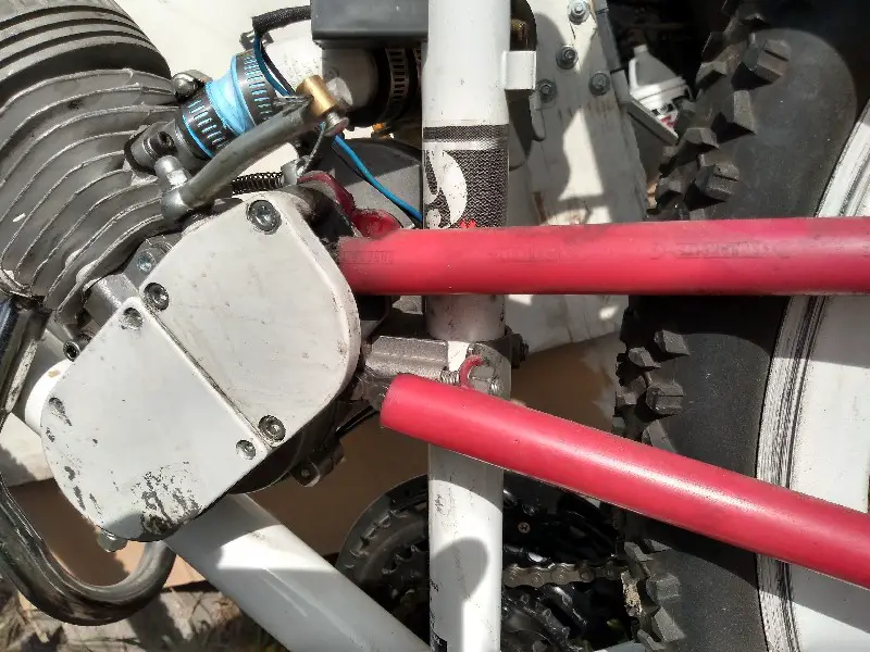

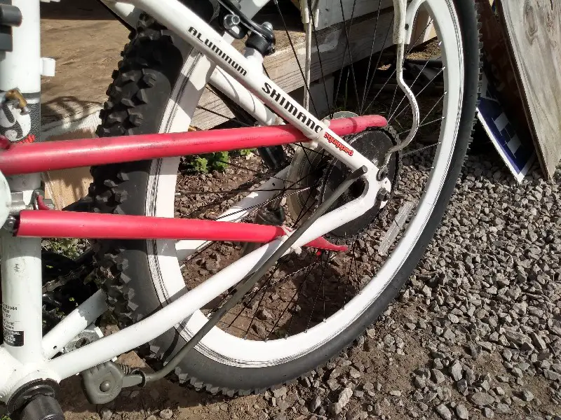

Hi, I have had similar chain issues with the 66cc China girl. I got rid of the tensioner, I tried the spring loaded tensioner, the issue there was in bump starts. I solved the problem with pex rigid water pipe. It is tougher than pvc or abs pipe. It is available in 5 ft lenghts at Lowe's, it is inexpensive. You would need to devised your own method to attach it to the engine end. I used tie wraps to attach it to the stays. It is easily cut with a hacksaw and file. You can form it with a heat gun or toaster oven. It is how I got the name "Smooth". We put one on my friend Bills bike and all he could say was smooth. Use half links to get proper chain length. Hope this helps. Riding WOT or I will stay home and knit socks. IMG_20190412_165456244_HDR_resize_0.jpg IMG_20190412_165446853_HDR_resize_62.jpg
