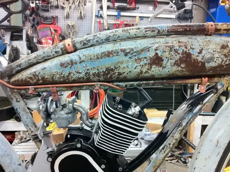

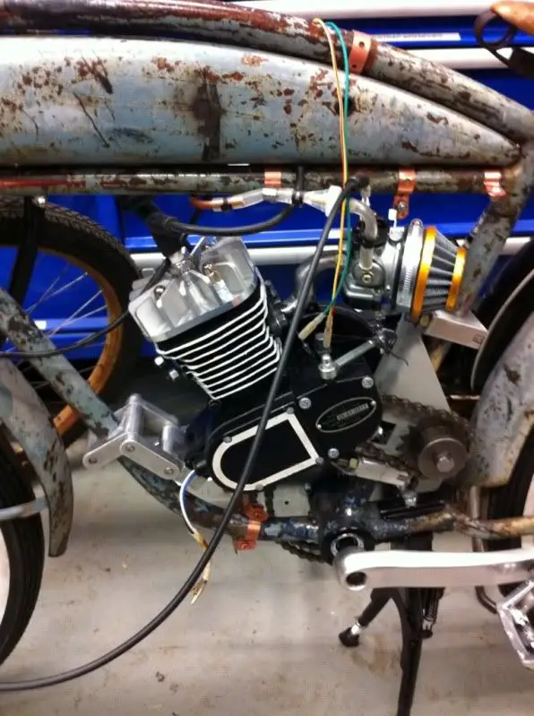

manic mechanic.
I bought a pirate one for mine...I removed it before ever using it. I put two compression seals on the spark plug...still mashed the electrodes together. I got an indexing kit, used the two seals, AND indexed it so the electrode was up for more clearance...still mashed it. I still had to back it out several more turns before it quit hitting, and that was just turning the pedals over by hand.
When I say mashed them together, I mean stopped the engine dead, couldn't cycle through.
I went back to one seal, put the manic head on...no mashing. Lesson learned.
Maybe with a different heat range plug, yadda, yadda, yadda, but that wouldn't have left any adjustability, either. Also, it was a mid range plug, so it could have been even worse.
I can't say I'm a fan of the angle plug setup.
pirate:
manic:

manic mechanic.
You have to put the correct type spark plug in these heads. That is all there is to it.... pretty darn simple really...
Heat range don't mean a darn thing if you have not followed the manufacturer directions and use what they say to use. Just throwing any ol spark plug in any engine is plain silly..
So in a nut shell there are only so many variables here. Both heads were made for a dome type piston. What this means? All the other piston variations are flat top pistons.. Follow the directions its very easy to set ether of these heads up right. I like the original Pirate's design looks better and perhaps way more authentic on a classic board tracker looking build my self but that's just me.
