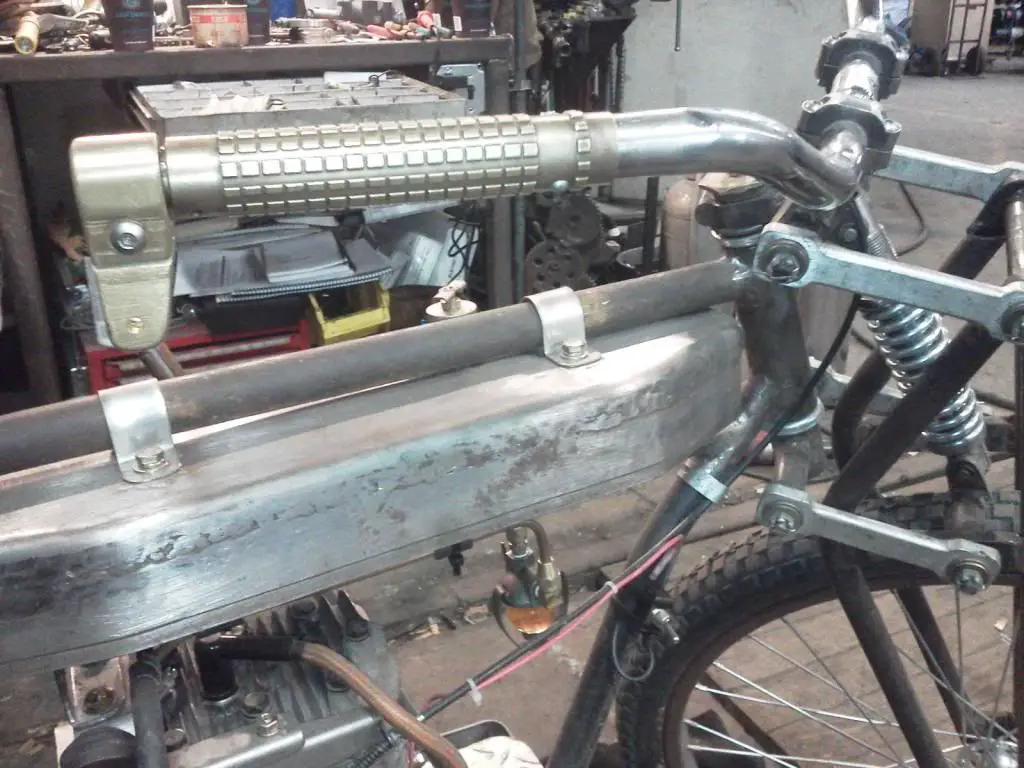

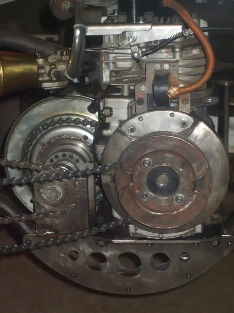

Tweeked the kick-start a bit gearing wise. to get more revs per throw.

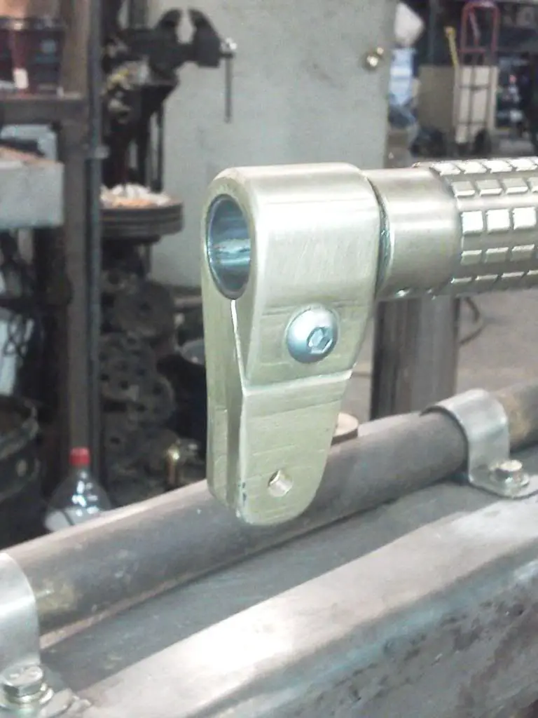

and came up with some thing for hand-grips, Torch handles !
Then I thought I'd make an internal throttle out of one. hence the month from the last post. made every part at least three times but got it.
I'll take some pics of all the in side bits next time i have it apart.

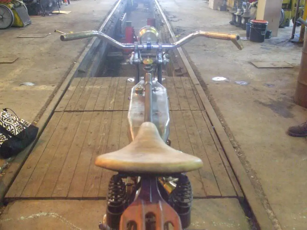

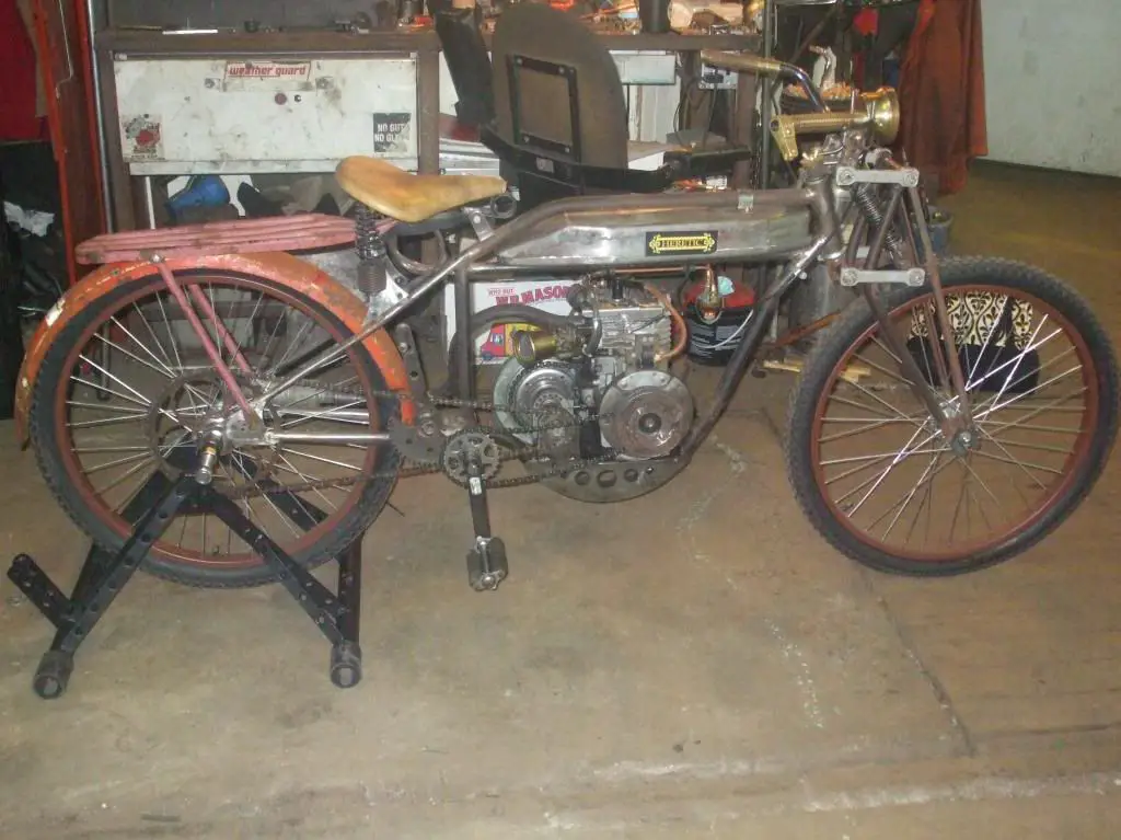

Shot this yesterday. Sometimes I think I do mock-ups purely for motivational reasons.

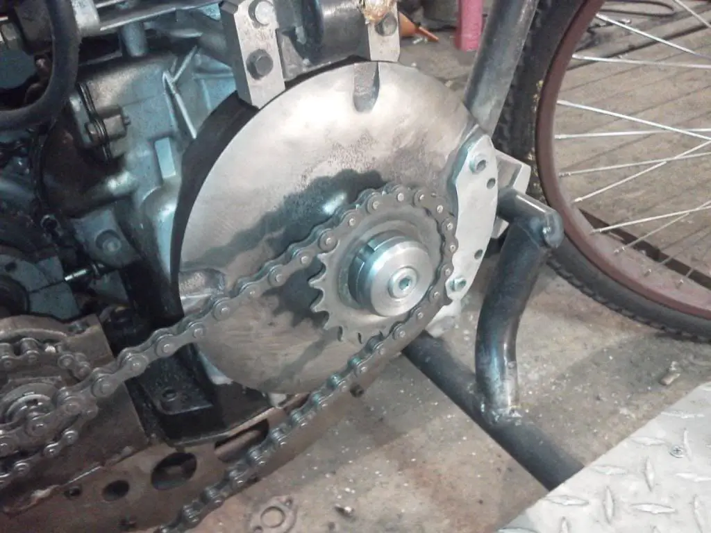

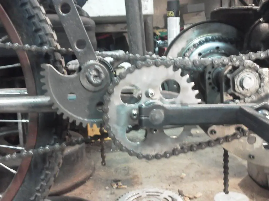

Trying to load from my phone . If it worked that should be my sprocket I cut.
Made from scratch, no CNC. Just a jig and a drill press.
I kinda lost track of thing I did since last few posts.
Made new cranks, nothing I could find would work with out heavy mods so I just went from scratch. Although I had to have a bike shop cut the left handed thread. Its like the one frik'n tap I ain't got.

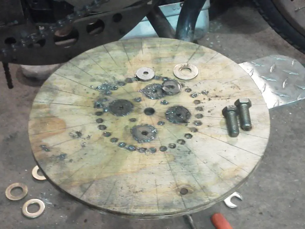

Thats part of the jig to make the sprocket, It bolted to another part witch bolted to the drillpress and then could be rotated one tooth at a time. After that you just cut along the dotted line and lots O filling.
In earlier posts the kick start used a bike freewheel. It worked ok but not great. Now we have a 3/4x1 inch one way needle bearing pressed into an adapter that rotates on a hub witch screws on to the flywheel.

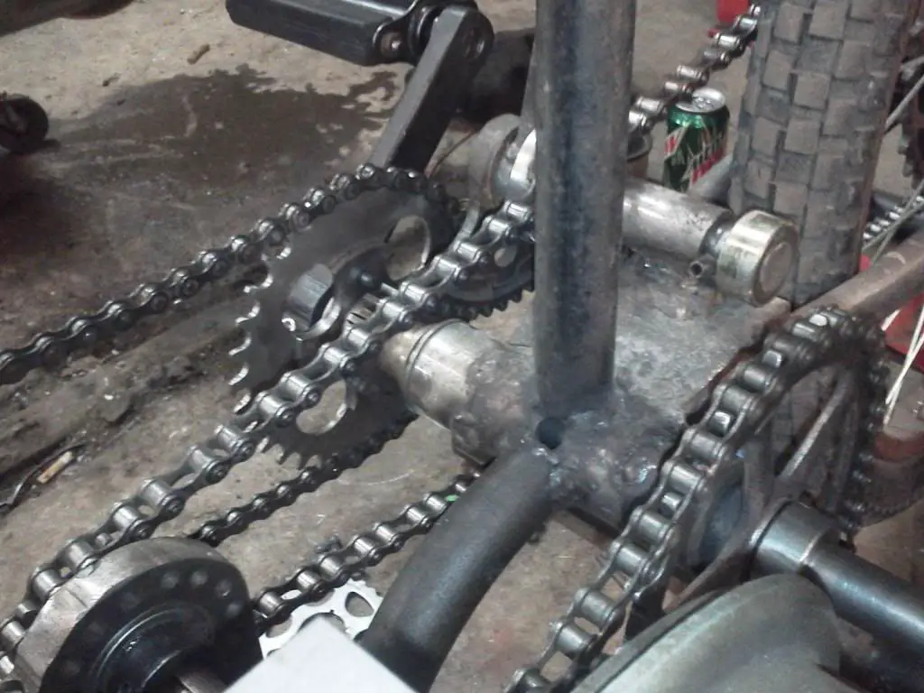

Started work on the peddle side of things, another old skip tooth.
that makes four different chain sets altogether.
Here's a shot of the throttle(old torch handles) and the start of the brake lever.
cUT FROM 1" X1" brass stock.
