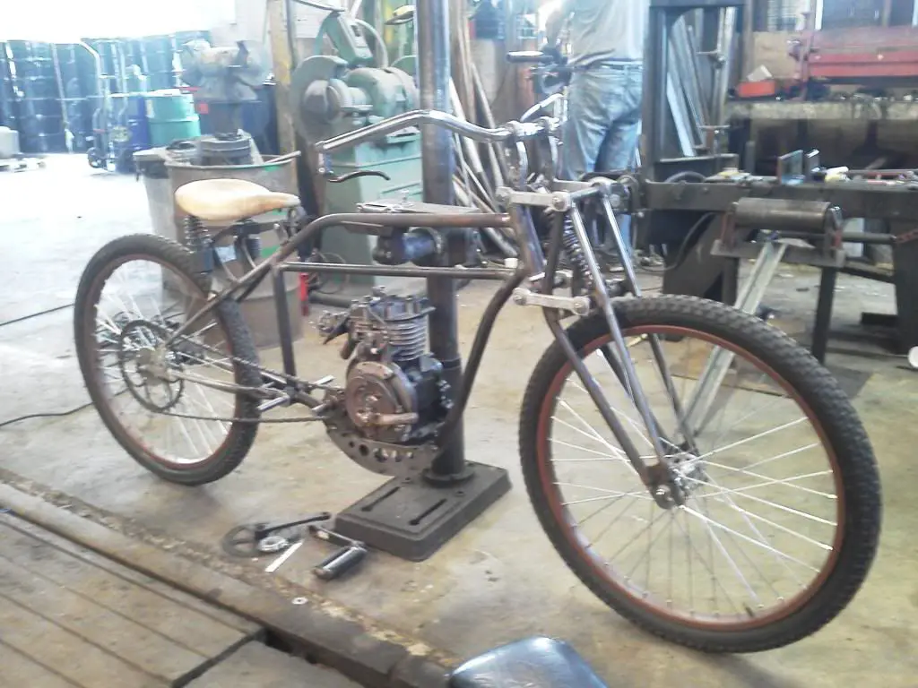

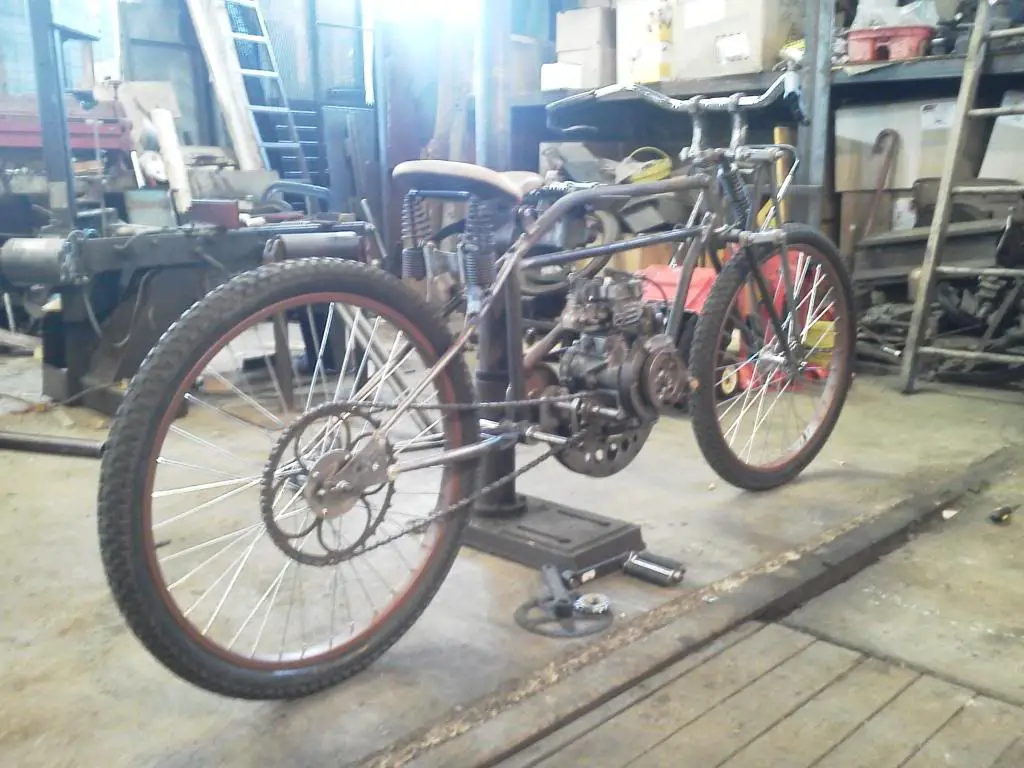

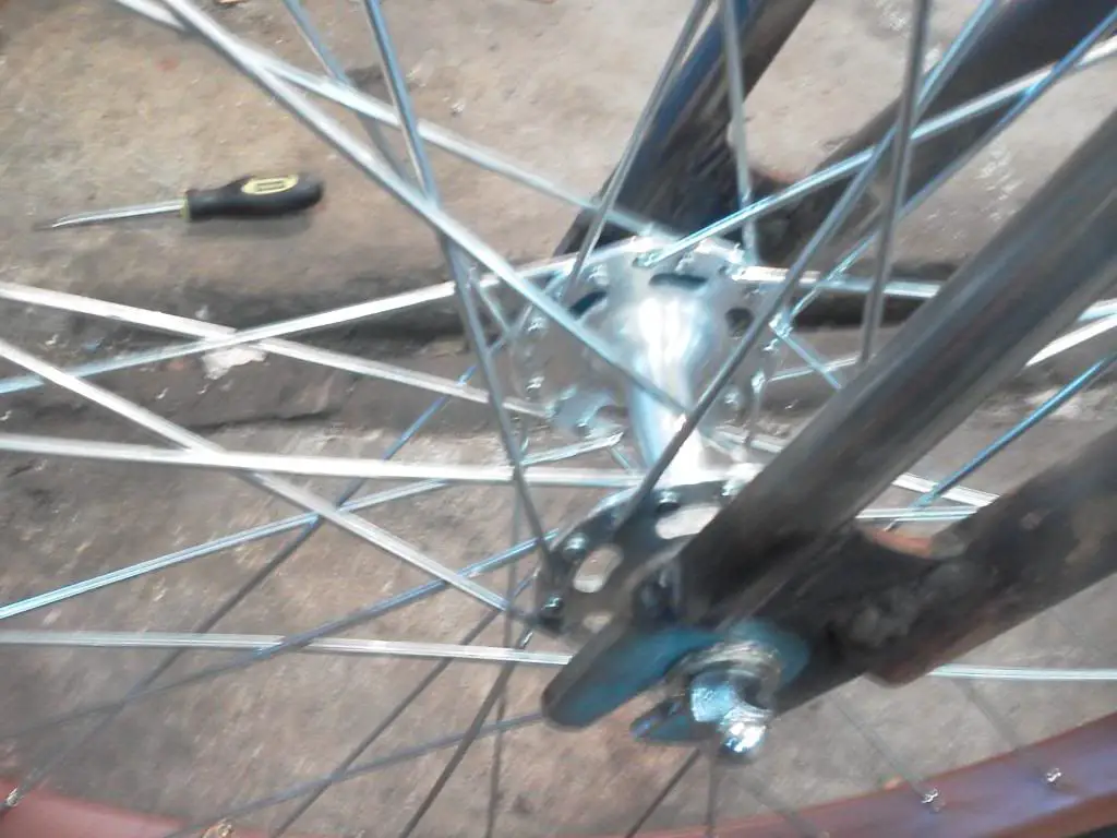

Been a little while since the last update. Most of the recent work was in the wheel dept.
Tracked down 12g spokes, painted the hoops, rebuilt some hubs. Taught my self how to lace and true wheels. Dial indicator and all.

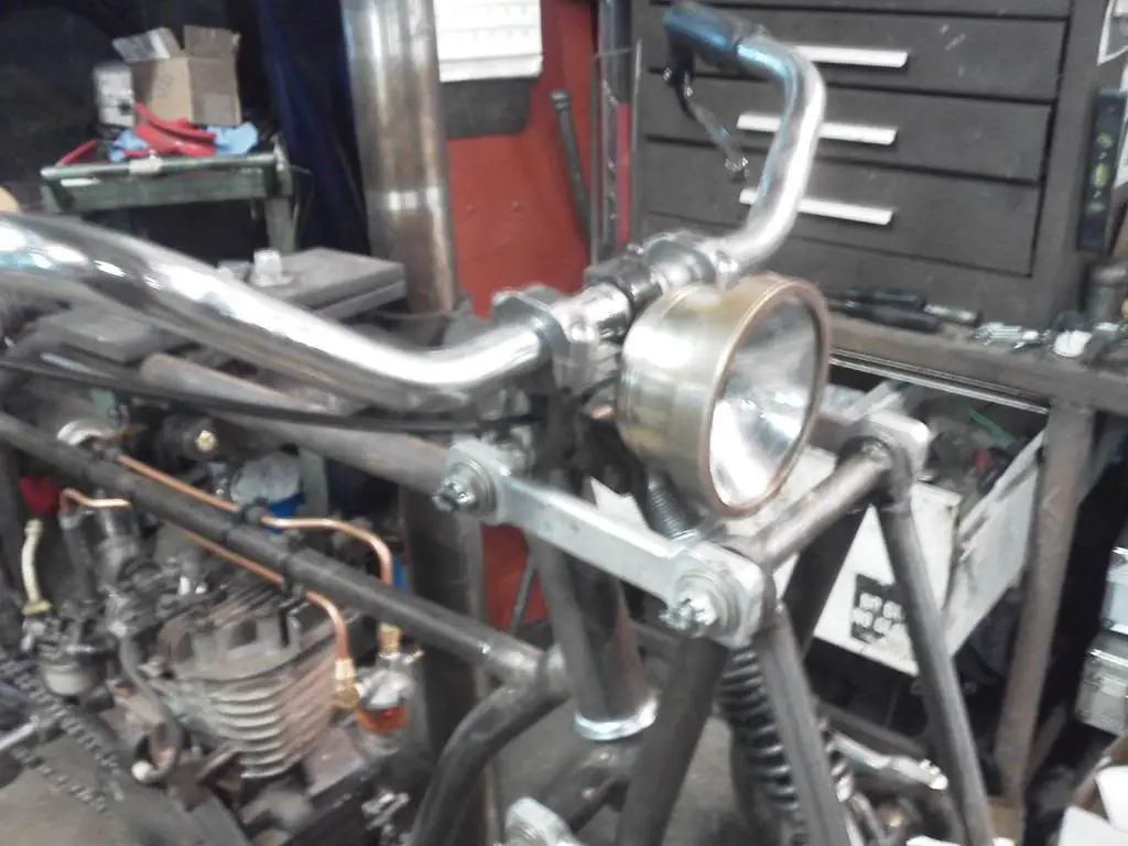

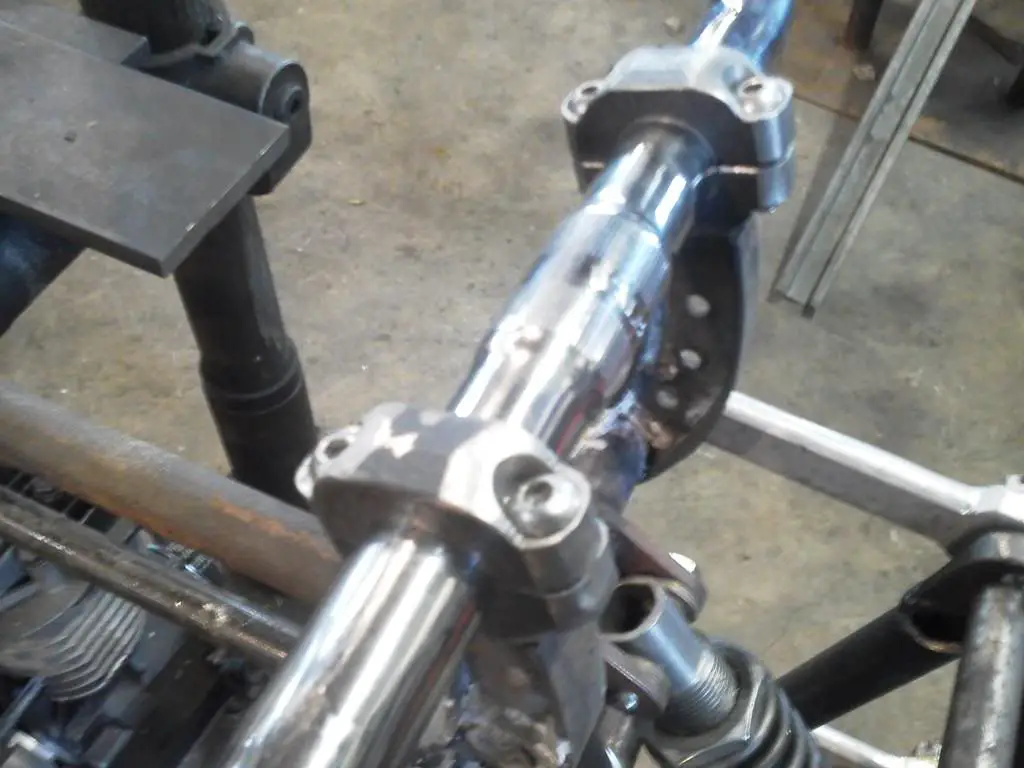

Also got some handlebars and made risers.The 7/8th two bolt clamps where done from solid 5/8th stock. I drill the main hole then the bolt holes, cut'm in half , tap the lower half and drill the upper bolt holes a 1/32 larger then the bolt then do the shaping.

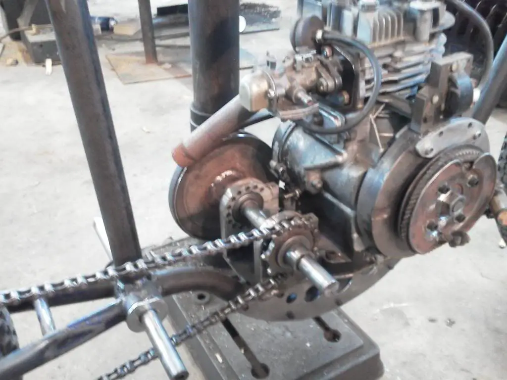

The pillow blocks for the jack shaft were done the same way.

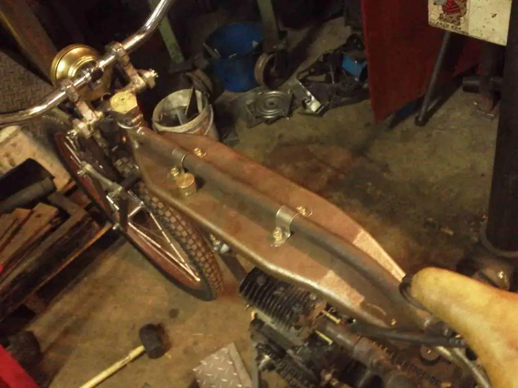

Tank and motor work are next. already cut out the wooden form to start hammer'n.

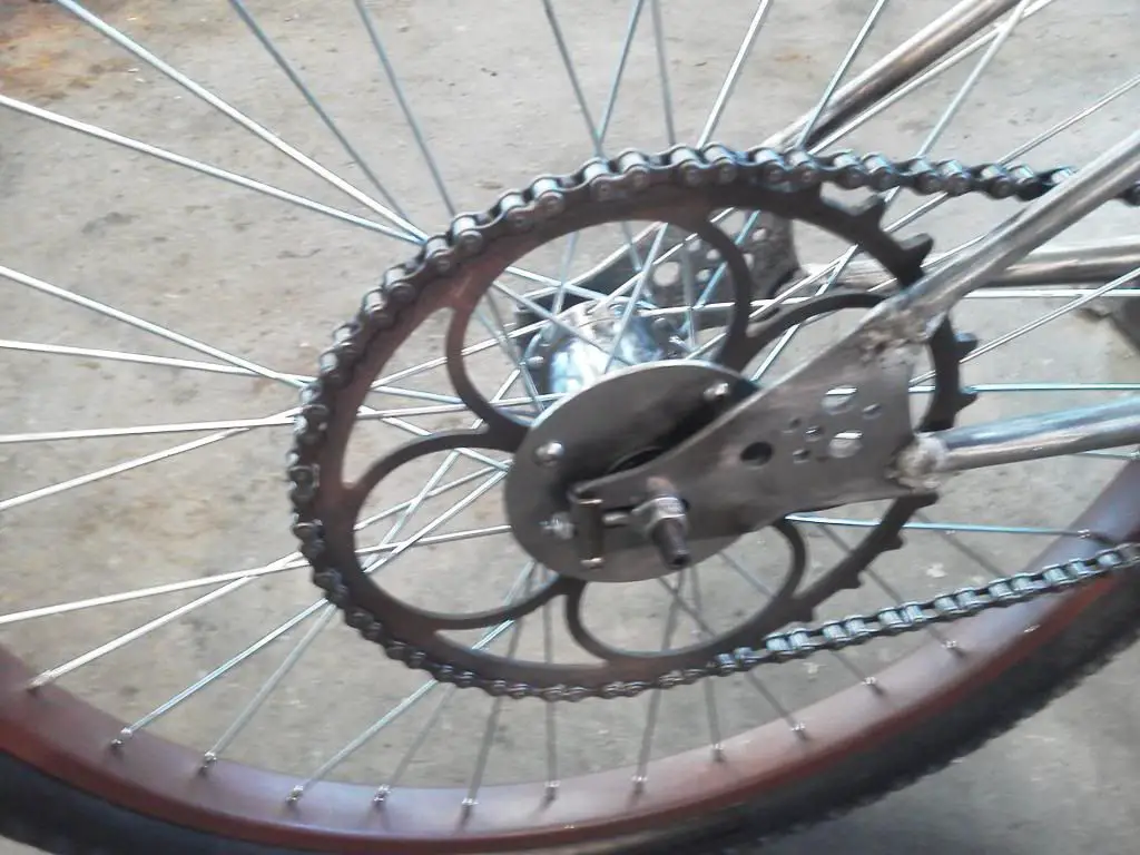

And if your wondering how it'll stop with out front or rear drums. I plan on making "perimeter mounted rotors".
Don't ask how long it took to figure out what the **** they were caller. but I like'em so I'm gona build'em.

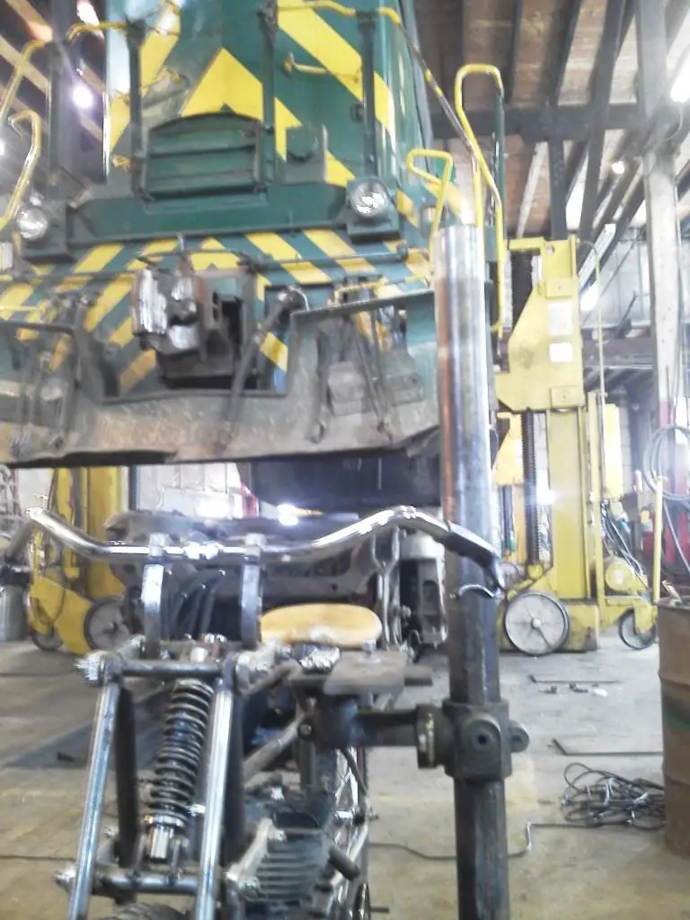

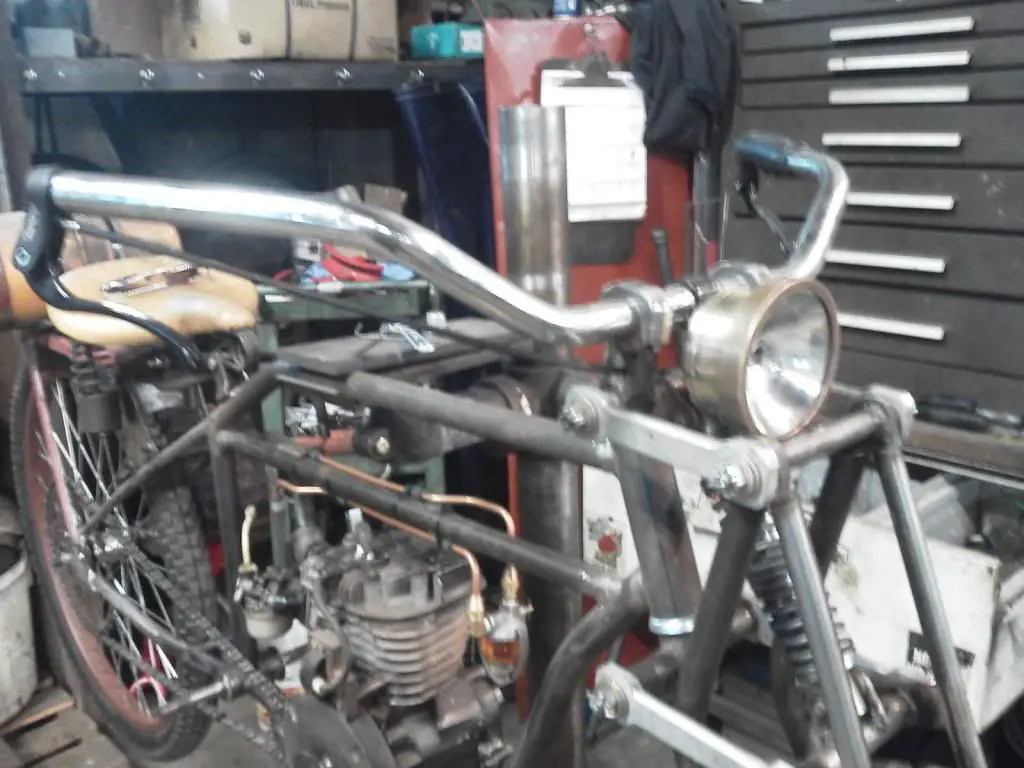

Thinking about lowering the risers about an inch and a half and adding a cross bar to the handle bars....Any thoughts?
I do think they would look better lower...
And with the way those handle bars spread out I’m not sure a cross bar would look right? They’re not the traditional tiler style that usually have cross bars anyway.
-Kirk
The handle bars IF? you are going to keep them would be cool if you extended them back and since you have plenty of room you shoud make an oil box/tool box for the seat post and fender of course.
I think was going in the direction of a gentlemen's cruiser look. with a little nod to the steampunk for style. so maybe full full fenders front and back. and I have an alternator to work in so I'll need to make a battery box at some point.

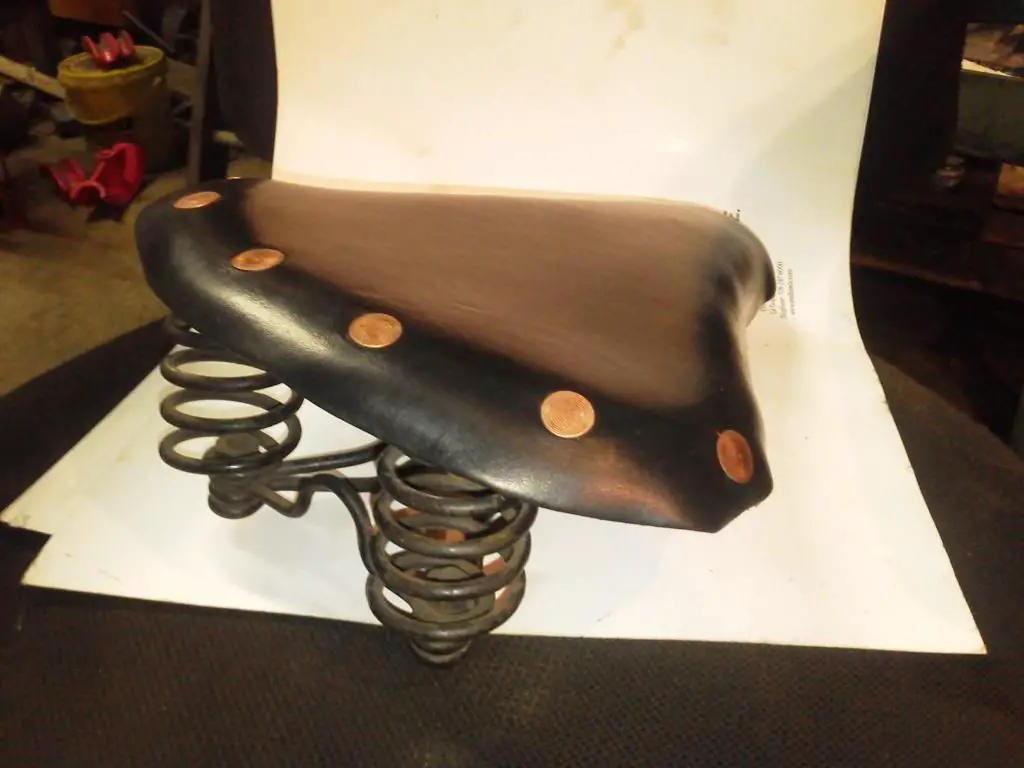

Hey so I never got back to how the whole leather thing turned out. not that i don't like the seat on the bike now but I picked up a mess of thick leather real cheap and wanted to try shaping a seat. so carved out a wooden form, soaked the leather in warm water and watched it shrink about a third the right size....
Cut out another one and twice the size i needed and started over.
And after drying, cutting, dieing and riveting here's what I got.
still need to work on the nose but not too bad, big learning curve on this one.
But still fun.

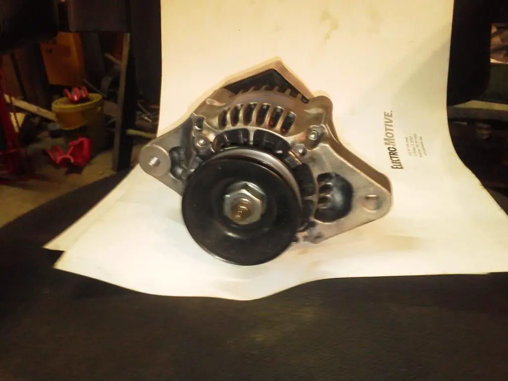

and heres a shot of that alternator I found.

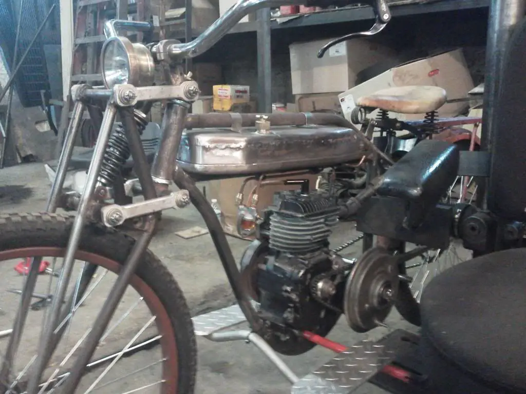

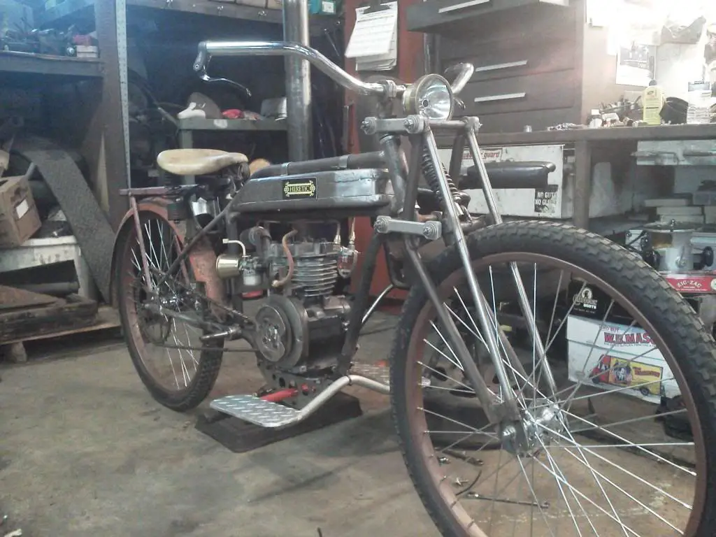

So got a few things going on and thought it might be time for an up date.

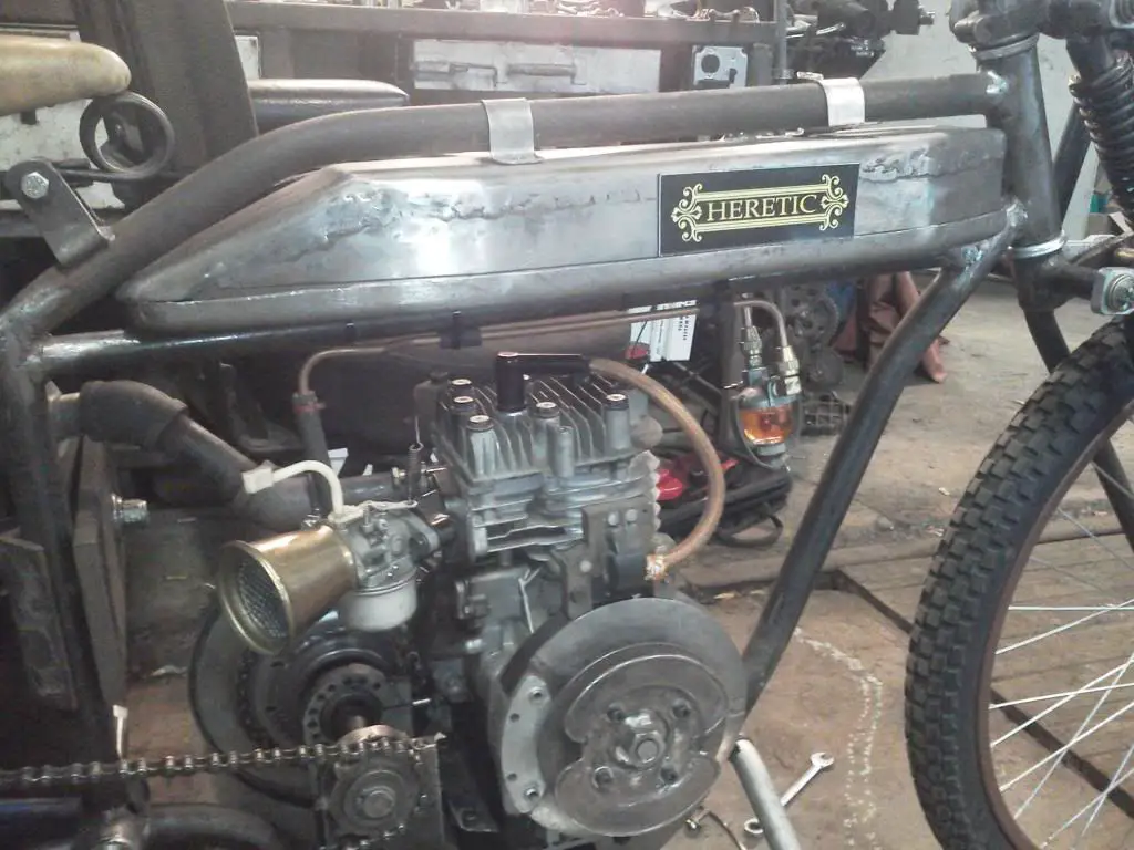

The tank is coming along
Clutch and drive train just about all worked out.
Did a little work on a logo.
No photo yet but the kick-starts about half done so that will be coming soon.
I like the foot boards, nice! build and I like the all the other little details too!
Thanks! for the update COOL STUFF!
There should a drawing in the patent page. I posted when I was working on them or you could Google Webb Girder forks. That's where I found them.
