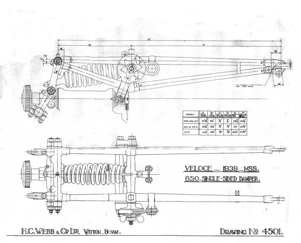

Looks to me you used a bike shock with double springs,what weight springs did you use? The drawing show a friction shock how kool................Curt

Turned every part to the shock on lathe, the springs are valve bridge springs from a locomotive head. I think that shock took the better of three weeks to make.

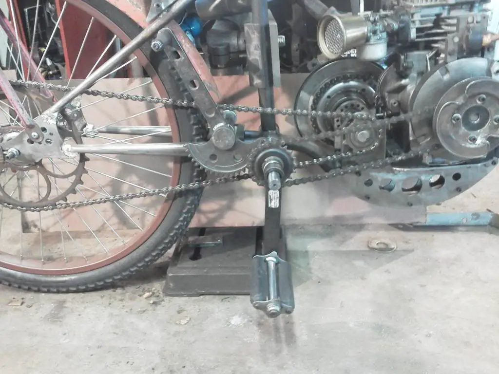

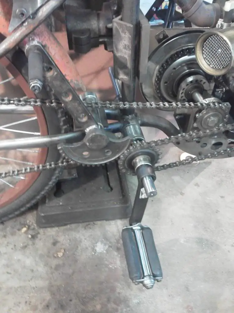

I'd been thinking about a kickstart for a while and think I got in worked out.
Put a freewheel on the flywheel, with an extra sprocket geared to a third crank.
and thats what I came up with.
I have'nt tried to start the motor with it yet, little more welding to do first. Then I'll see if the gear ratio needs to be changed.....and I'm sure it will.

Dude... are you one of those secret Genius guys ? that's Fantastic! "Making it as you go" Yah Right you've had this bike in your mind for a while haven't you, cause this bike has been well thought out, I'm just having a hard time excepting the fact that yer just winging it.
NICE JOB!

That video just reminded me that I've got an old 1930's Briggs 2hp washing machine motor with a kick starter (that runs, by the way) in storage at my folks house.......hmmmmmm.....thinking thoughts that would stumble empires.......
