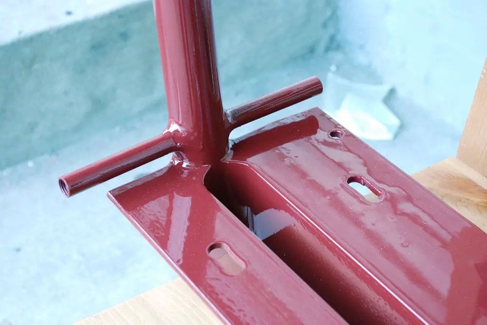

As most of you all know I am now in the process of painting my bike, however progress is going really slow. This weekend I was able to paint the fork and few other bits and pieces. Here are photos of my progress, tonight I hope to do the pin striping on the fork.

Thanks guys, The color is Summit Racing's single stage "Merlot" but it is more of a blood red in person.

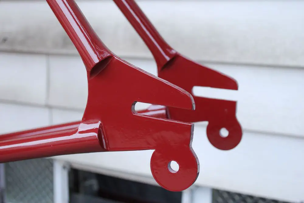

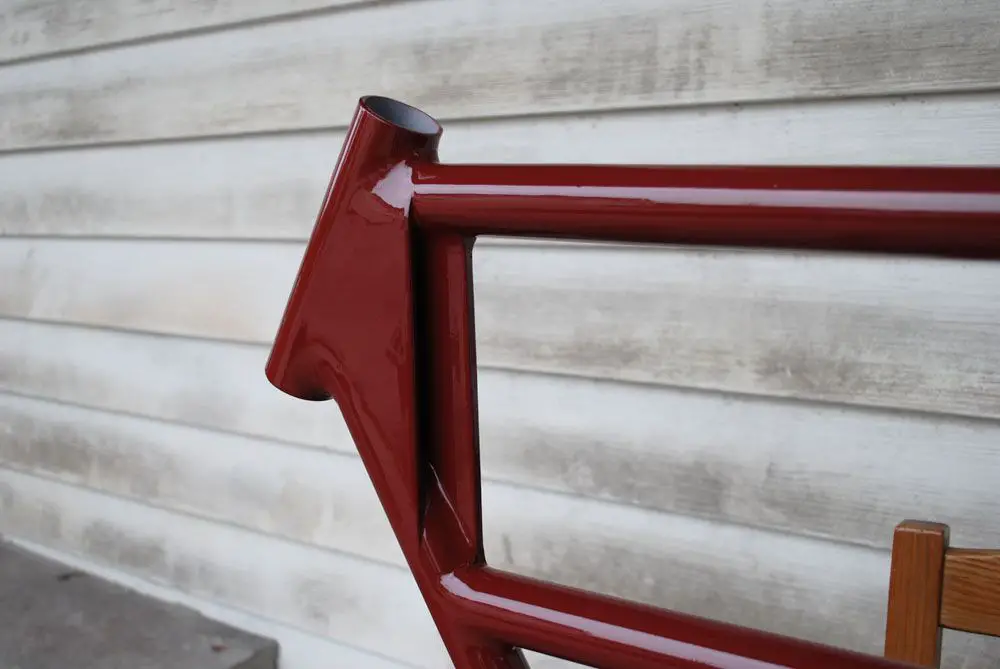

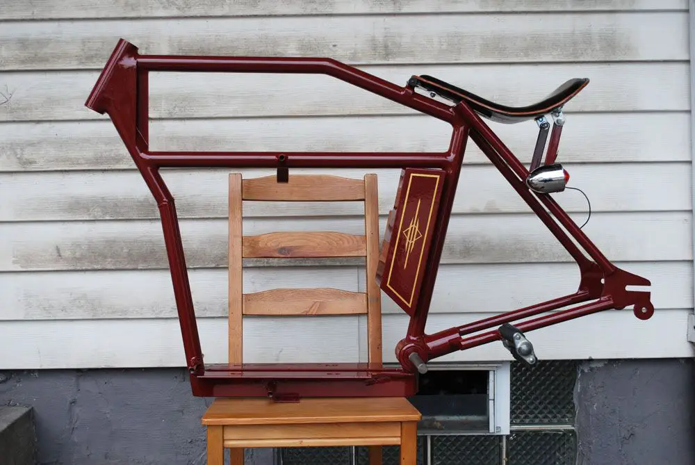

right side of bike

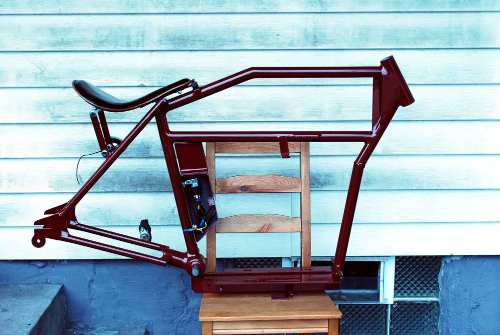

left side of bike

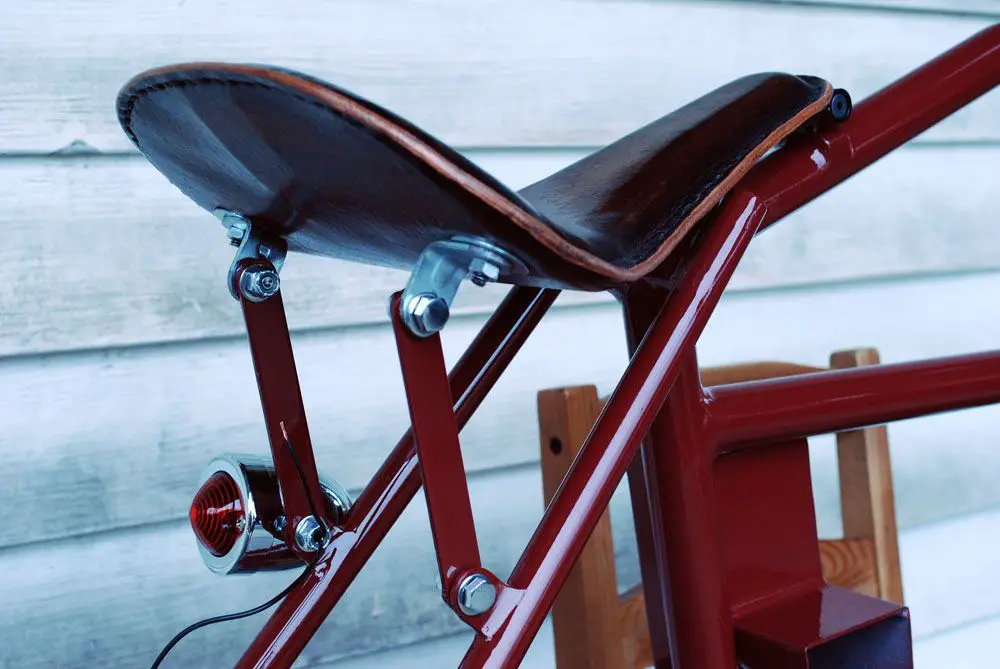

seat and taillight

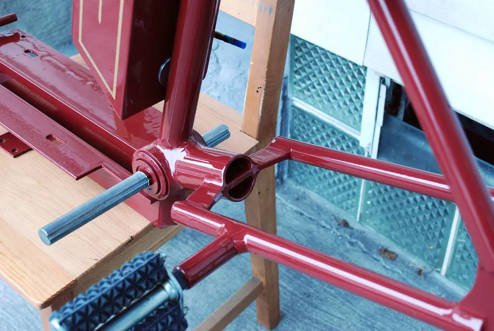

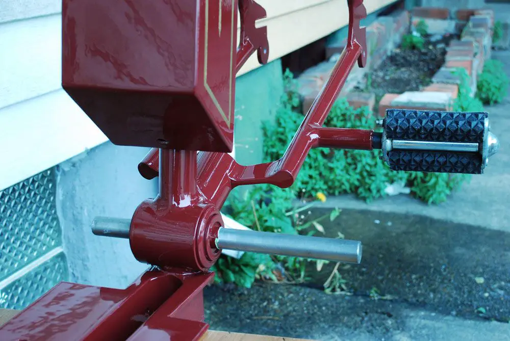

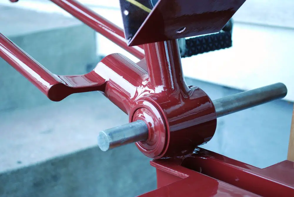

countershaft
Yes I will be adding pin striping in various areas of the frame. I just finished painting it on Saturday so I'm waiting for the paint to cure 100%. It's been very humid here lately and it is taking a while.
Hi Lurker....looking very smart...the gold pin strip really sets it of...did you use a two pack paint..looks nice and glossy....where did you get the plain rudder pedals....DD
Thanks guys, the paint is a single stage urethane enamel from Summit Racing. The bike will never be left out in the elements so I figured single stage is good enough. The block pedals came from the basement of a local bike shop.
