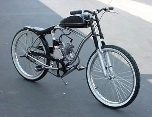

Bike in question
I just checked the photo gallery on the frapper map I set up and here is Kevins (mypetelvis is his screen name) bike Frappr Maps - My Maps . I don't want to speak ill of the seller but feel that if they are selling a product and want to show kustom work to promote sales, they should show their own work or at least credit the builder/owner:-||...Kelly
