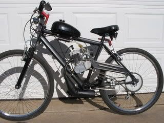

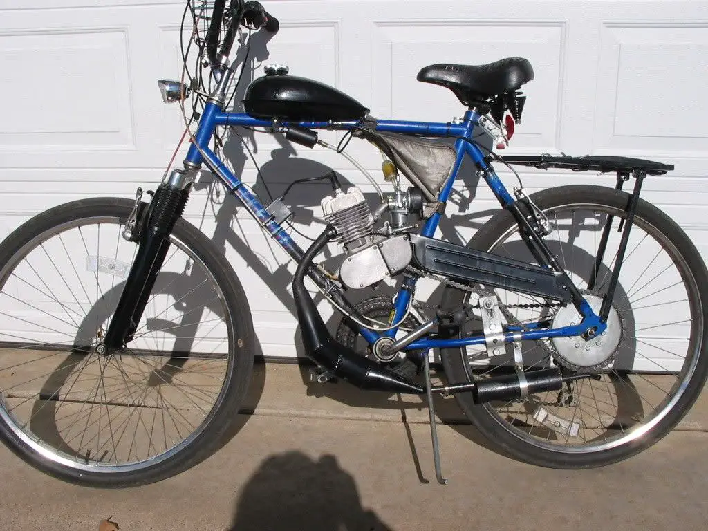

You can roll your own pipe if you have a welder not near as pretty as a factory made one but for me it was fun.
Re: least expensive engine modification for performance
This homemade pipe has the muffler built over the end just a can over the stinger and a1/2" hole with little tail pipe sticking straight down.

I just couldn't resist you need a helmet if you feel the need for speed. Please be kind as my feeling get hurt easly.rotflrotfl
great pictures norman nice job. i need me a helmit like that beer and chips the coneheads lolrotfl
