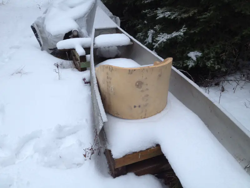

Since I have a couple of questions which require photos in order to ask I thought I'd go ahead with a bit of show and tell first.
Below are two photos showing the old tri-car seat sitting in the proposed Sociable canoe body. Too big for two of them. A better option might be a couple of boat seats offset in tandem.Even then it would be a tight arrangement.

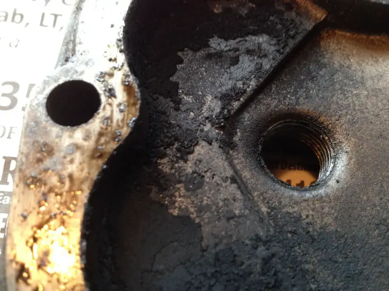

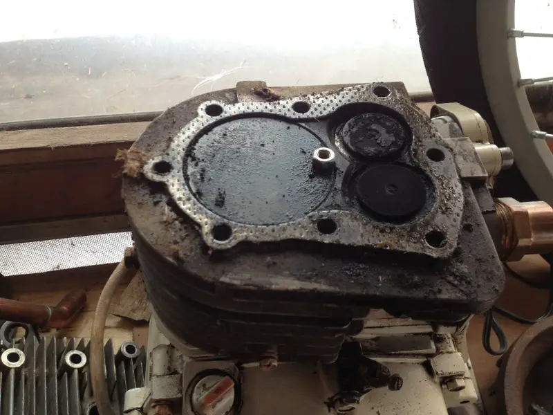

2nd pair of photos show the head opened up. There's some carbon gunk which could stand some cleaning up. Any tips on doing so? Left to my own devices I would probably use paper towels and gasoline. Maybe something else is better.

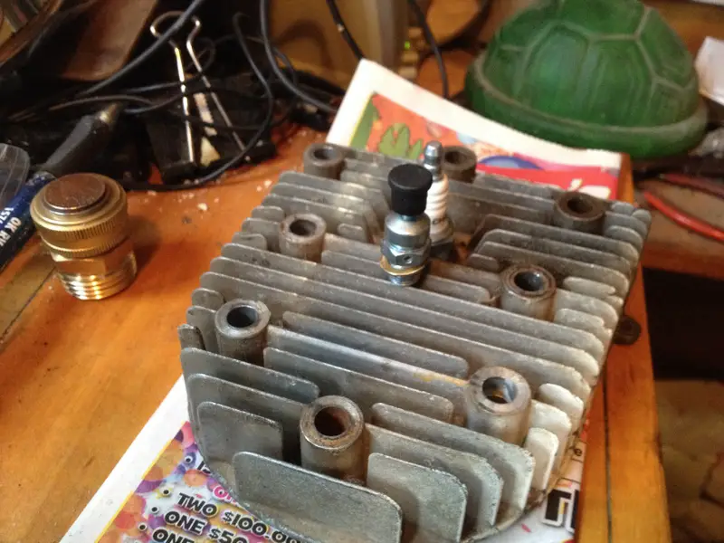

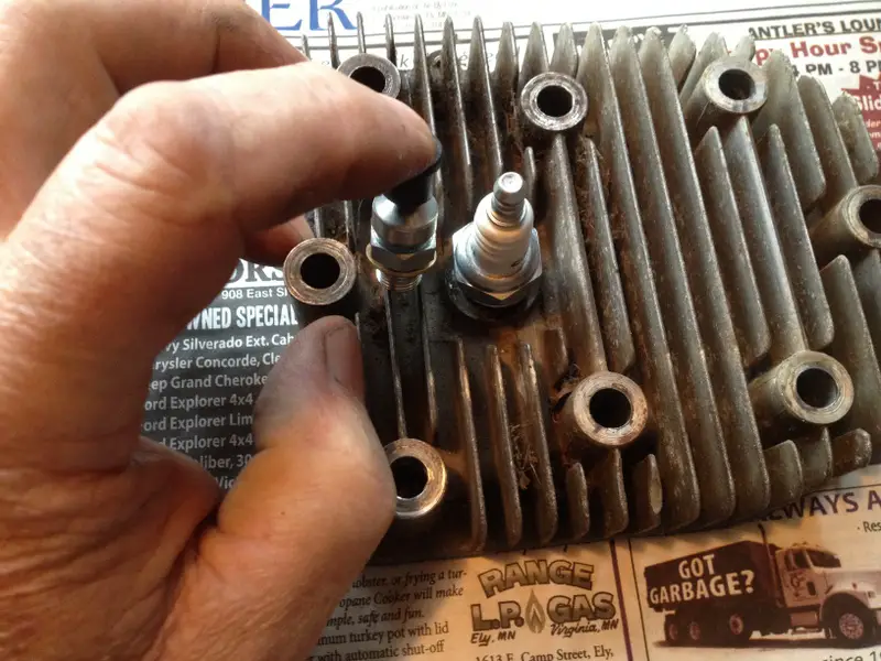

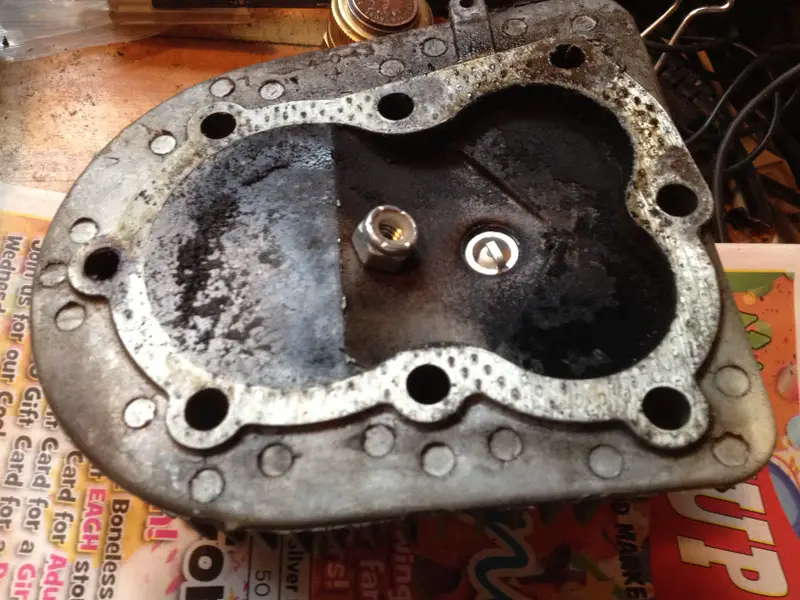

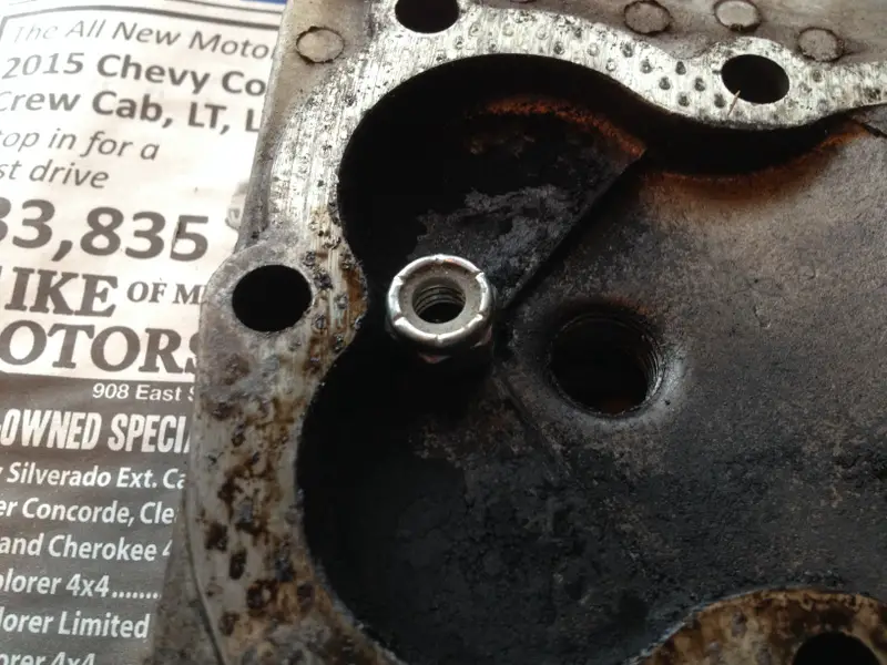

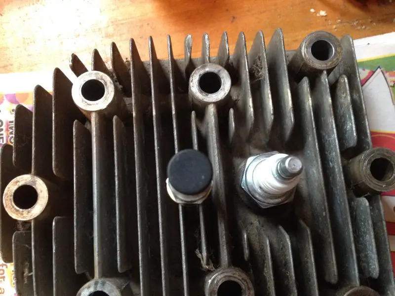

I'm attempting to show where I figure to place the compression valve. This is just next to the spark plug and to the rear of the engine. The last photo has a locknut marking the spot. Looking from underneath it appears to be a flat spot which means I would not have to shave down a flat, but just drill the hole and taps threads. Does this look okay or is there a better spot? Thanks beforehand.
SB

racie, You're right! What was I thinking? It looks like the only viable spot is to the opposite side of the spark plug. I'll take a couple of photos and show you.
SB
I think it should work if it don't stick down pase the the head and interfear with the valves,could always use some brass washer if it does. Break line fittings have small brass washers maybe NAPA............Curt

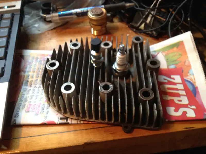

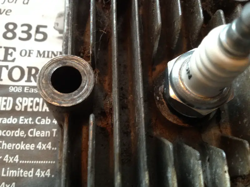

Thanks so much for catching that! How about here? It isn't flat so would require a little dressing there from underneath.

If the plug wrench will fit , should work. How about go just one fin further,you could break the really thin fin off and use a old wood chisel to flaten it were you going to drill...........Curt
How about here?
SB

I found some one leaving a pressurized spray can of Permatex gasket remover by the trash. The can was full I took it. I used it also on the carbon build up. Since I was not removing but the valves at the time, I made sure to stuff cloth in the cylinder with the piston down, to keep it from getting on the cylinder walls.
This older variety stuff sprays a foam that continues to bubble a reddish yellow color stuff. I expect it is probably quite caustic, like some de-greasers, brake fluid, and the like. It is best to wear gloves and eye protection.

Piston and valves ....you gotta miss...anywhere else should be ok I'd say....how far into the chamber does the part reach?
