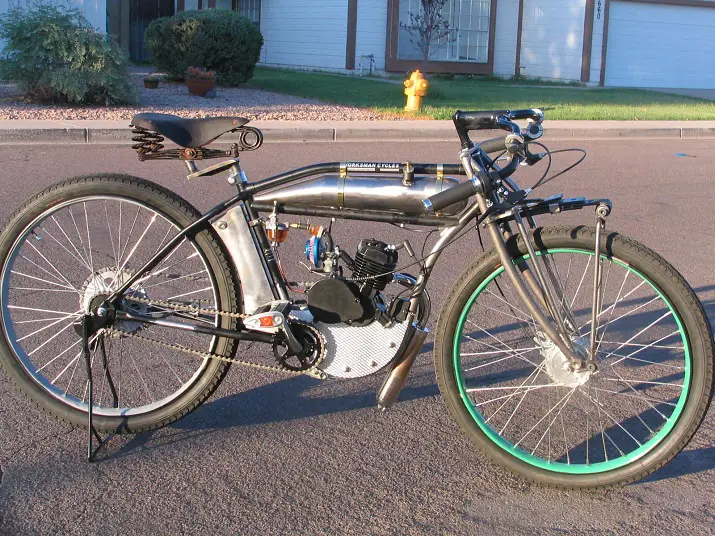

    I just weighed my bike, fully loaded it weighs #125 lbs Do your bikes weigh as much. I'll include a pic. I hope this pic thing works

    Heh.... Look close! That bike has quite a "PAIR" HAHAHAAA! Never seen Truck Nutz on a bike before! GIGITY!

    OOOOOOOOOh yes a pair of brass ones lol. That's Turkman for yea . Dan

    That kickstand is off of a moped....I have one just like it. He adapted it to the bike.

    Ahh no Scottmo I copied a cheap aluminum china one the bent an wouldn't hold my bike . That kickstand is handmade by me with steel in my garage." theirs nothing you can say that can't be said , nothing you can make that can't be made".weld.weld.weld

    My bad Turkman, Ive got a copy of your's that was on a Peugeot moped that I've yet to put to use. Nice job, it even looks a little beat up like mine.....mine is made of steel.
