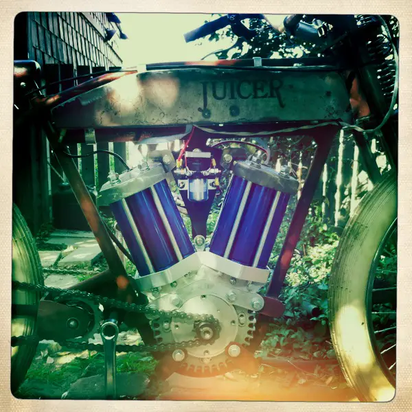

Time to think about the tank. As before, I mock-up the top in wood first. Another fab tip; if you need to trace a projected line, split a pencil down the center and use the lead-side against the floating line. In this case, my result was a bit inconsistent, so I cut the best half, traced it and used the reverse side of that template to cut the other half.
Alright, it looks good in wood. Let's do it again in metal.
I used the same 1mm scrap metal that I used for Juicer I. I really love the rust patterns.
Chopped in half with my trusty angle-grinder, it's ready to mount.
Check out my nifty, floating chain tensioner. I think I learned that trick from Sheldon Brown's site.
So Juicer II finally sees the light of day, but will she go? Will she stop? Will she make my woman a widow? Stay tuned.

48v 16ah
After a few test rides I have a couple more numbers to share. With the controller set at 100a I have more than enough power to zip up the hills of my neighborhood. My top speed is 46mph and my range is nearly 13 miles. I'm pretty happy with the performance, but will have to boost the amperage if I want to win any races. That won't be too hard since my controller is rated for 400a and I have oversize cables between it and the motor. But for the street, a hundy is all my brakes can stop. The bathroom scale says she weighs 111 lbs.
