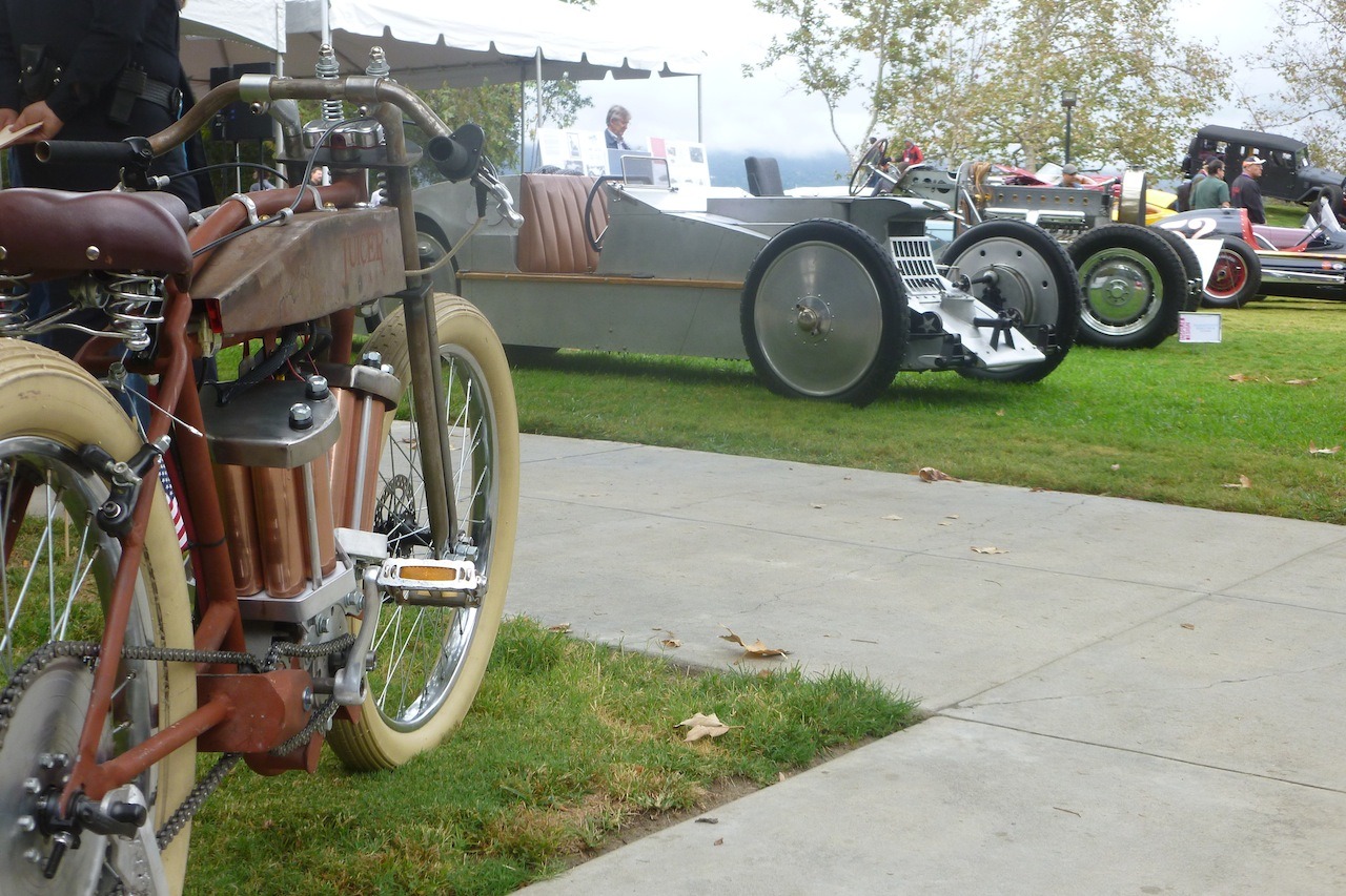

A faculty member at Art Center in Pasadena invited me and the Juicer 48 to the 2012 Car Classic. The theme was "Inspired Design." It was a huge thrill, lining up between some very rare vintage conveyances. Syd Mead, the Blade-Runner designer was there. And since it was in LA and had something to do with cars, that "comedian" from the Tonite Show showed up in a jet-powered car (I guess he didn't want to attract attention).
Also, I should mention that there is a new Juicer 48, the "Ranger" which boasts a 28+ mile range (not bad for an ebike). It is now for sale at Hollywood Electrics.

Congratulations for the recognition you are receiving and for the continuing evolution of your design. You took the ebike to a whole new level and keep making it better and better. Well done, sir!
