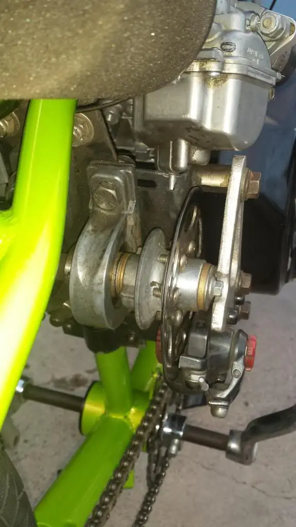

My understanding is that having the disc brake on the jackshaft allows it to have much more braking power. Therefore, I plan on having a motorcycle drum in front, which I believe will allow more than adequate braking power for normal stops at the speeds I like to cruise, and the jackshaft disc brake for emergency stops only.

Ridin' inSane Diego, CA.
Please forgive my ignorance, but I can't wrap my mind around how a brake on the jackshaft can stop the wheels from turning, and brake the bike. HELP! and where can I get that engine & jackshaft mount!?
In a nutshell......the rear wheel (sprocket) is driven directly by a chain from the jack shaft. You stop the shaft from turning, the rear wheel also stops turning which is braking to the rear wheel.
On my 212cc bike, the engine itself does most of the rear braking with it's compression when you let off the throttle. The jack shaft brake is just there if I need just a little more braking power in certain situations while racing.
The front brake of course is used for most of your stopping power as far as all vehicles are concerned.

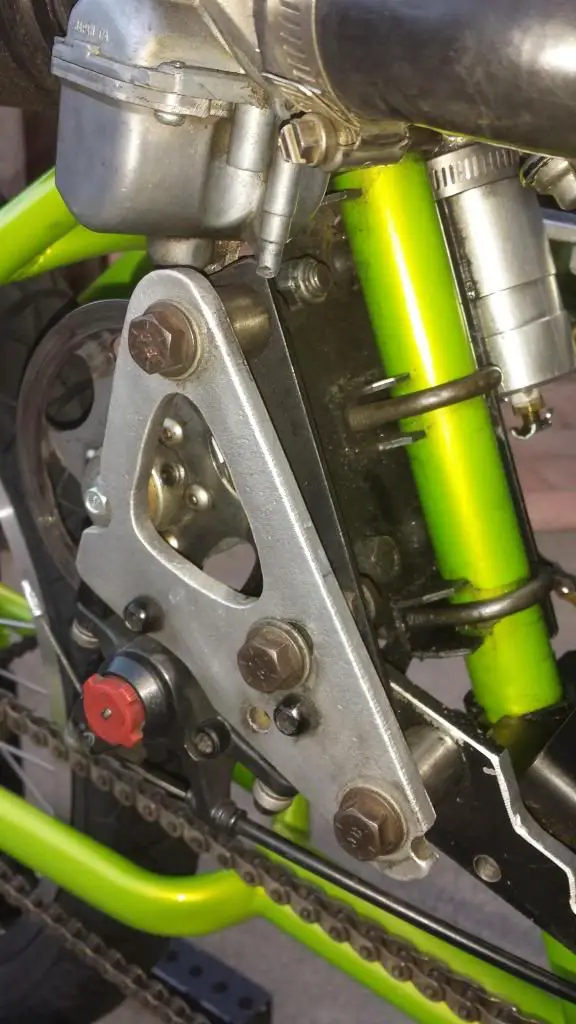

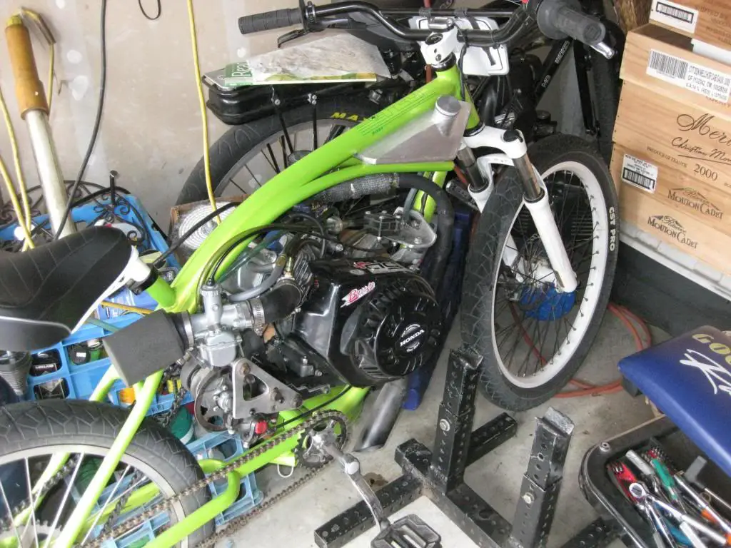

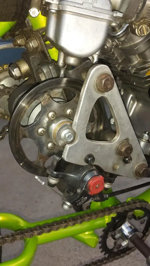

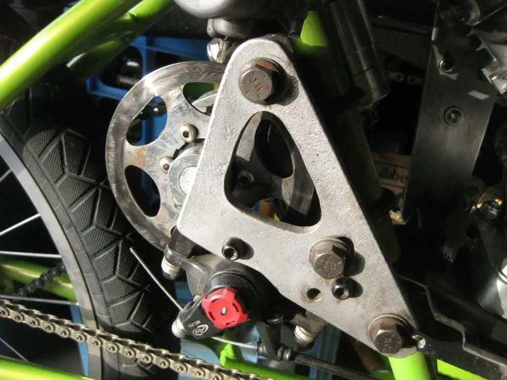

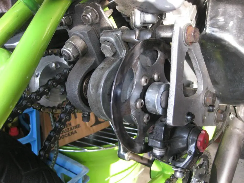

Here are a few more shots of the j-shaft brake on my 212cc bike.....
