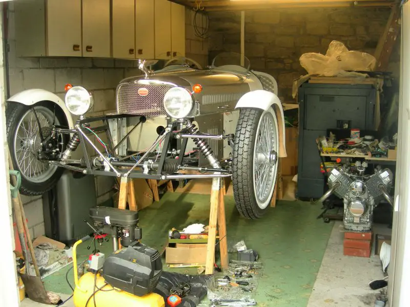

Here is the electric tri car frame before I took it apart and stored it.

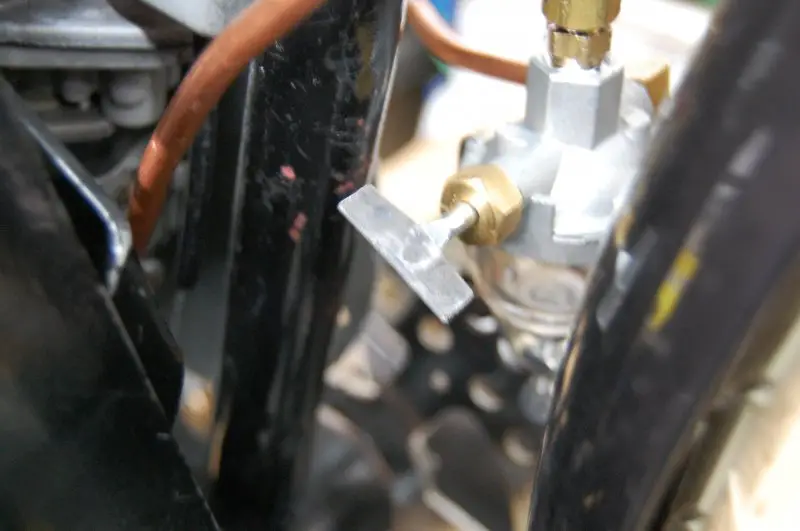

Went through the gas line for the tri car and wound up having to replace some of it. The glass gas filter leaked but it was an old one that came with a gas tank
No matter what I did to make a new gasket it still leaked so I installed a new one I had. Haven't tried it yet but I'll find out how it works when I fill up the gas tank. Perhaps it will be one of life's more exciting moments but you take them where ever you can find them at my age.
The new filter of course is of an amazingly poor quality where the gas cut off screw is concerned. The screw that holds the glass bowl tight has a somewhat usable place for your fingers to fit to turn it but the gas shut off screw needed a pair of pliers to grip it or maybe it just needed younger hands.

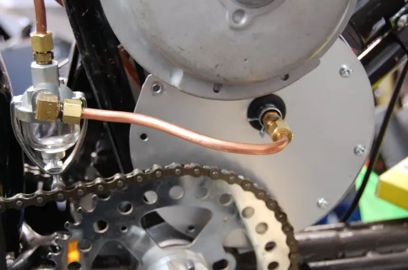

I cut a piece off an old bike fender and folded it over and clamped it onto the gas cut off screw to form a T handle. Spot welded it on the cut off screw and it works well now. Forgot to take the camera with me so I'll get a photo tomorrow. Remade the gas filter to carb line so it runs down to the carb instead of slightly up hill.

Here are a couple of photos of the new fuel filter to engine gas line and the T handle I added to the fuel filter to make it easier to turn off and on. I'll try and include a photo of the original gas cut off screw that was so small I couldn't turn it.
