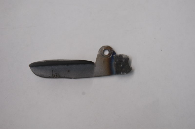

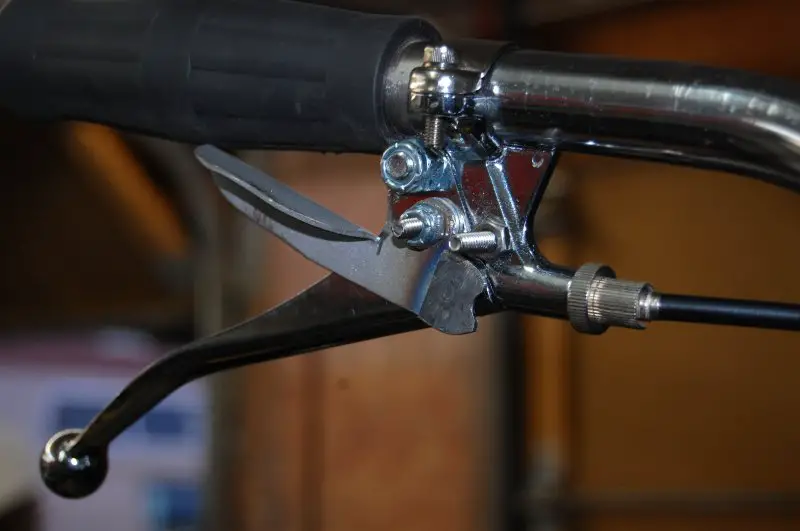

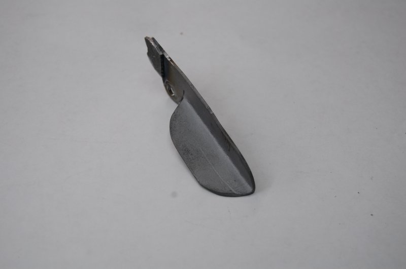

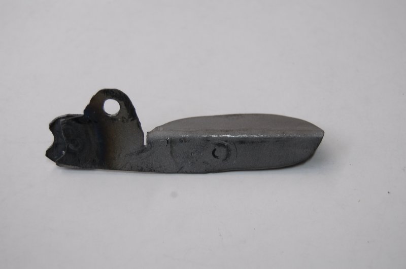

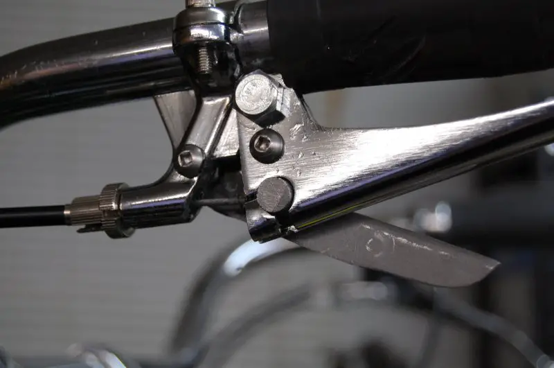

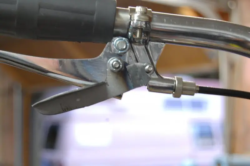

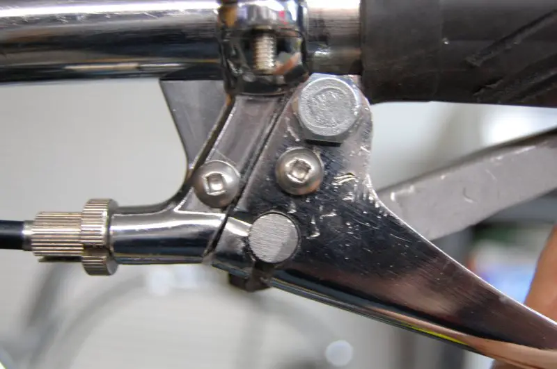

Finally have the lever to hold the clutch lever open when I start the bike. Just used a strip of 16 gauge steel and cut a slot from the top down to the middle of the strip and bent the top section over in the vise to form the thumb rest part of the lever.
Drilled a hole in top of the front half so the handle would pivot then rounded the thumb rest part of the lever and shaped the rest of it with the 1" table top belt vertical sander. Drilled two holes in the clutch lever it self. One for the lock out lever to rest on to hold the clutch open and the other one as a pivot point for the lever.
Got a little loose with the belt sander and had to spot weld a piece on the end of the lever and reshape it so it held the clutch open. As my shop auto teacher would have said," Wonderful, now you've gotten yourself into it, you get to devise a plan how to get out." I tell myself that every time there is a foul up.
January was a splendid month. There was one day it didn't rain in the complete month though some days did have a few hours of sunshine before or after the rain. From mid February on we should get more sunny days. Today it was sunny and 50F and I spent it cleaning up the work bench so I could move it outside with the tri car on it.
The gas filter needs to be moved up two or three inches so it's above the carb some more and before I take it off the work bench I need to figure out a carb filter. It's a snow blower motor and never had an air filter.
I have a few photos of what I did and tomorrow I'll paint it and reinstall it and finish up the clean up and wait for a sunny day to test it all.
