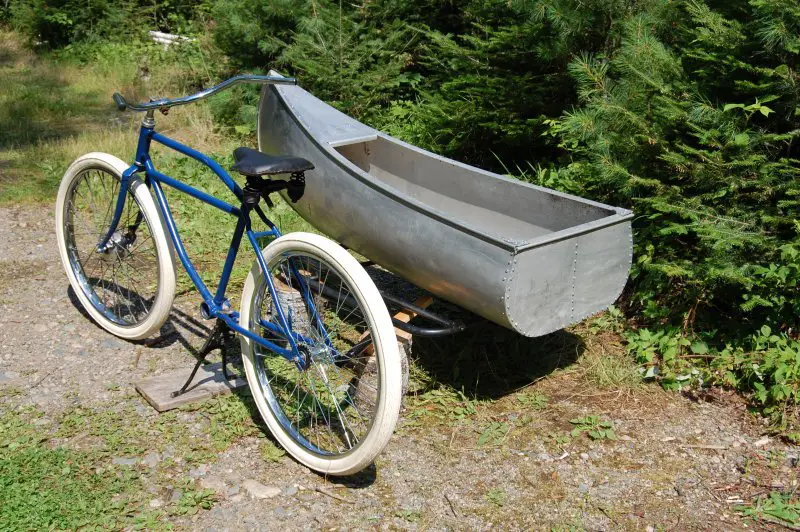

Here's a flash back. The start of Bike Camp.
I didn’t recall the Worksman frame ever being blue, but that must have been how it was when I bought it… through eBay I believe. And in the picture the front down tube has not yet been through surgery with an implant from a 1950’s Schwinn girl’s bike giving it enough room for the Sachs engine.
Interesting how one thing leads to another. If Fasteddie had not stopped in to say hello, that sidecar might not have ever been finished and all that happened at bike camp thereafter. Glad you stopped by, Steve!

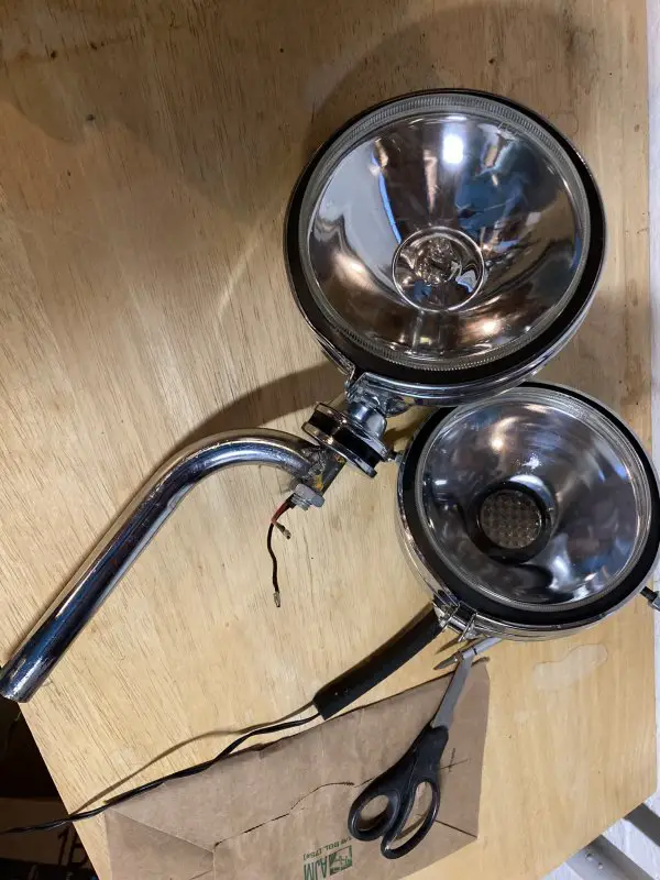

In looking over the Indian Hiawatha I see that I never adapted the headlights I intend to use, so did some investigating today. First I needed to see if I had what I needed on hand to convert them for the tri-car.
Some years ago I ran across some big honker headlights at Harbor Freight and bought a couple. $12.00 each then, if I remember right. They same thing was being sold at NAPA for around $20.00. They were supposedly for dune buggies or something like that. I was impressed with the nice chrome and tear drop shape and figured I could adapt them to my bike builds somehow or other. The price was certainly right and I do like the look of big honker headlights and I couldn’t tell you why.

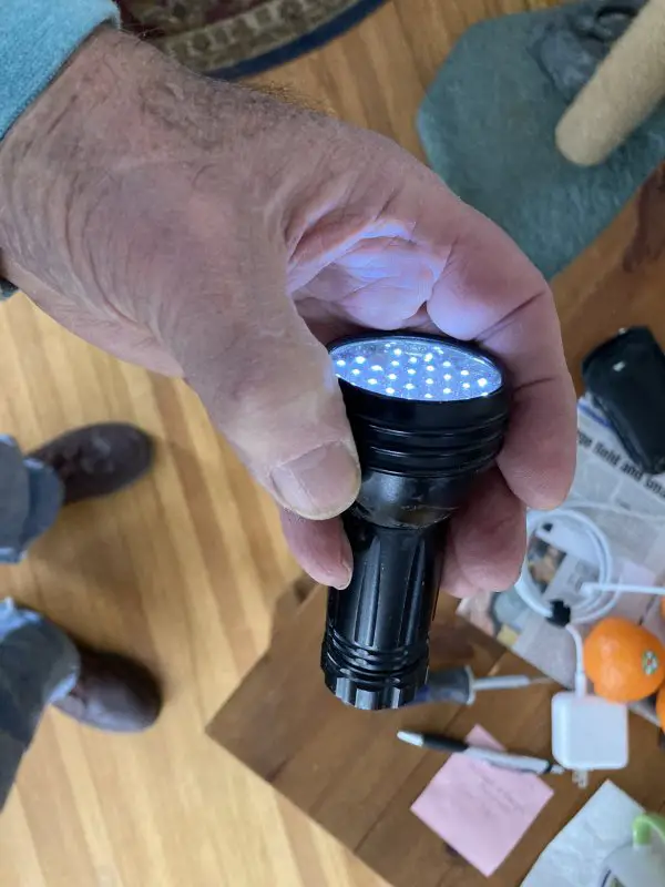

I had also been fooling around with some of their cheap little flashlights incorporating the business end into copper jewel tail lights. Then I saw these and pictured them in the headlights and bought a few.
They were only four or five bucks each and quite bright, powered by 3 AAA batteries. They had 32 led lights inside. I didn’t know how I woulid replace the 12 V. halogen bulbs in the headlights with these, but figured there had to be a way. Over the years I made several headlights using these harbor freight flashlight components.

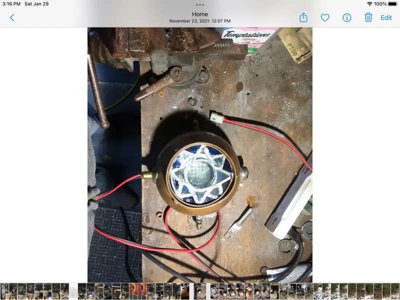

I adapted the first one in a strange headlight I made from a Portuguese cooking pot. It was copper and I saw it in an antique shop. In my twisted brain I immediately saw possibilities for a bike headlight. I cut off the pot handle and made a special lens for it out of clear and stained glass (blue for the background, yellow for the rays and clear at the center in a star pattern. Lead cames hold it together with solder at the union points. That was fun and will finally find a home on the quadricycle build coming up next summer.
I made another out of an old headlight for the “kindalikeawhizzer” build again making a special lens incorporating stained glass with a copper disc surrounding the led light unit. Cool beans!

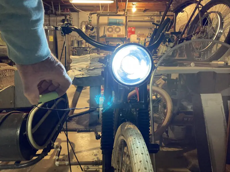

And then I made one following the original plan, removing the halogen bulb from the harbor freight honker headlight and fitting in the front end of the flashlight LEDs.
This was for the 1934 Elgin “Velocipede” build and I was very pleased with how it turned out. Even with just one 18650 battery cell it is quite bright. I had to take the above light apart today to see how it was that I did that. Forgot, I did.

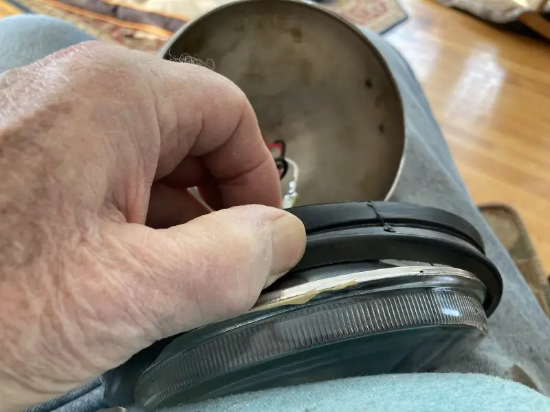

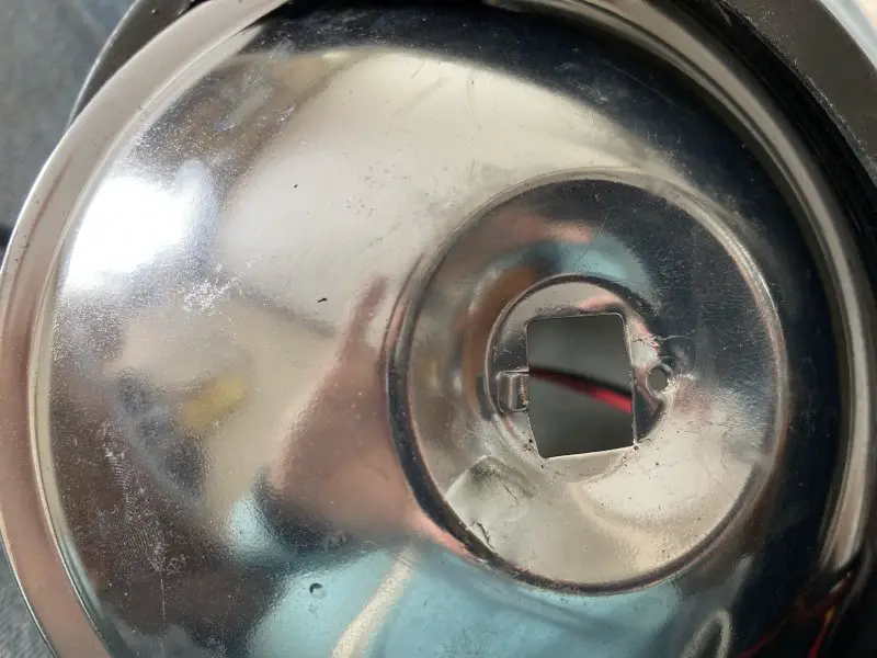

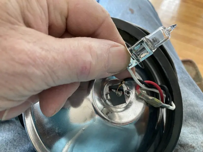

I took the velocipede headlight apart to see how I had made the conversion and also took one of the tri-car headlights apart to see how it compared.
As I understand it the 12V halogen bulb draws a lot of juice and is brighter than I would want a bike headlight to be. I don’t need to blind anyone and I don’t foresee riding around in the dark… that’s when old guys like me sleep. The lights need to be bright enough to draw attention to the ride from other vehicles, but if nobody notices the Indian Hiawatha being there then I don’t think much anything would help. So it is for safety and for helping the tri-car look right.
What you see in the above image is the glass lens housing and the rectangle in the center is where the halogen bulb fit. A screw holds it in place. That hole needs to be enlarged so that the front end of he flash light can fit in it’s place. I think (don’t really remember), that I used a grinding bit in a drill at low speed to open it up. It might have been a dremmel rotary tool with a wee grinding bit. Go easy making the round hole, at any rate. Then rinse out the grinding dust and dry before inserting the flashlight unit.
(To be continued)

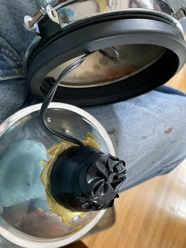

And what you see here is the innards of the Velocipede headlight which has been converted from halogen to flashlight LEDs. I didn’t want to take it further apart at this point as it is obvious that it was epoxied in place. It feels quite solid. And was sealed up with electrical tape. I don’t recall exactly, but I do know that I soldered wires to the positive and negative contacts. When hooking up a battery be aware that LEDs are positive/negative sensitive unlike incandescent bulbs.. Getting it backwards won’t hurt anything, it just won’t light up.
And that’s about it at this stage. When I do the soldering on the tri-car lights I’ll try to remember to take pictures. Yesterday I attempted to buy a few spare flashlights like the ones I used for the headlights, but Habor Freight was out of stock and they are now clearance items on sale right now for less than $4.00 each. What a deal! Maybe your harbor freight still has them. Your needs might be different than mine, but these have worked nicely for me.. I did a search this morning and found two of the flashlights in my department of bike stuff, so I’m good for the Hiawatha.

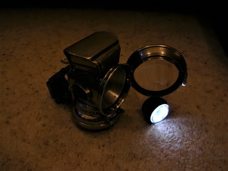

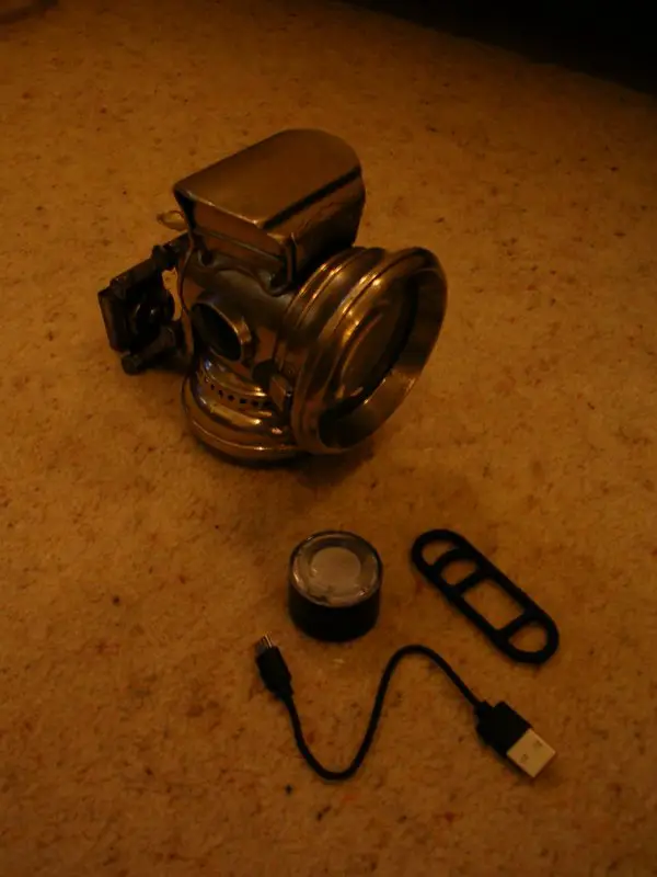

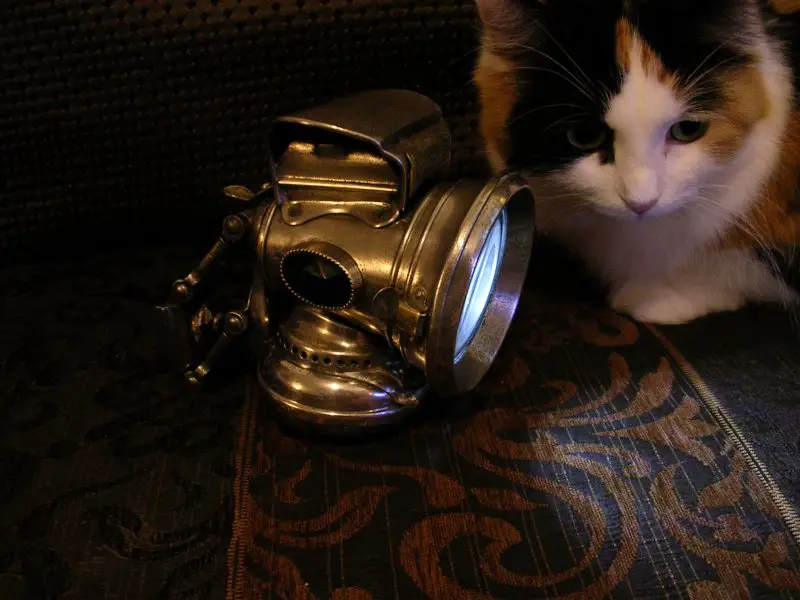

SB, Enjoying the ongoing headlight conversion saga. Here's something you might find of interest. Couple of weeks back I wrote in my forum thread about converting one of my vintage bicycle carbide lamps to LED. I retro-fitted it with a cheapo (UK£4.50 post free from China) multi-function 'modern' LED lamp sourced from AliExpress - but they sell them here on eBay too, usually in matched head and tail light (clear/red) packs. These lamps feature 12 super bright LEDs and you can select dim, half brightness, full brightness constant light or different rates of flash via the lamp's single push switch. Output-wise, it hurts to look straight at them on full brightness. Best thing about it is the lamp is USB rechargeable and comes supplied with its own USB cable - meaning you don't even have to think about buying or finding space for batteries. Conveniently, the 33mm dia. LED lamp's casing was a snug interference-fit into my vintage Powell & Hanmer lamp's internals. Or it could just be fitted using double-sided tape in any other lamp.
Footnote: Dadcat's little helper Mischa says to point out the lamp's stated brightness is rated at 80 lumens - whatever that is.:cool:
