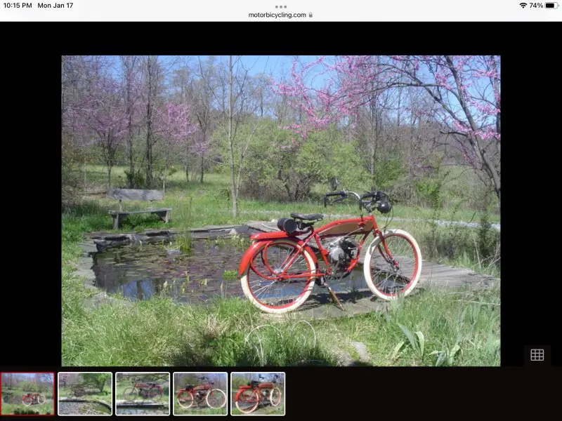

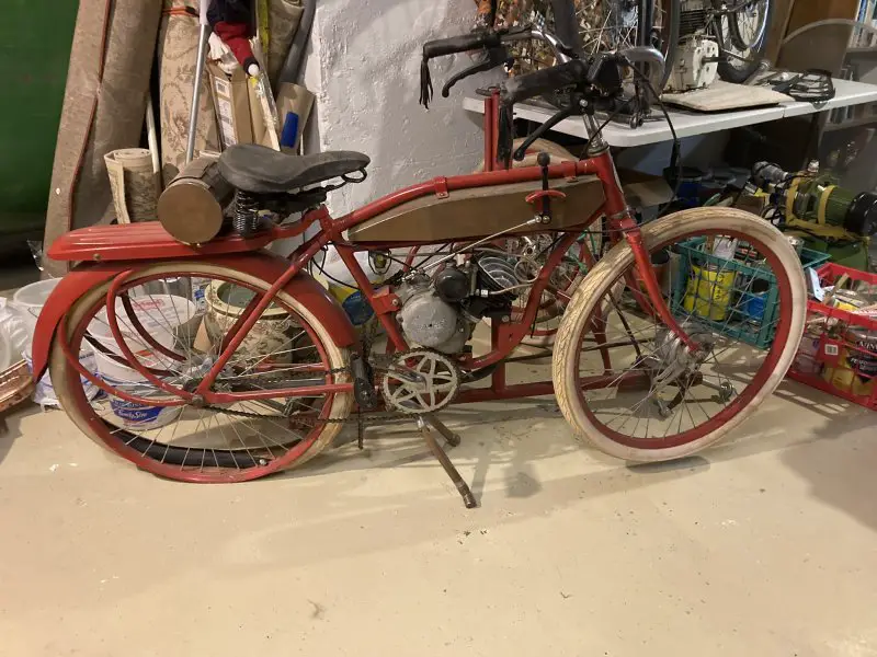

The last time I actually ran it was the same day I took some photos by a little fish pond at the caretaking property in Maryland.
I thought it was a thing of real beauty and was proud of what we had done…
but also disappointed that there was some kind of clutch or transmission glitch so that it was also the last time I ran the engine and now years have passed.

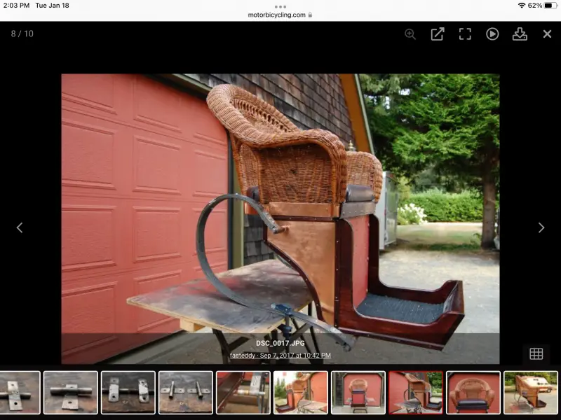

The seat has residence in the trailer. I'll have to look in this week end and see how the seat's slumber is doing and hoping the leg holds up. We'll know more tomorrow because I have a day in the garage planned.

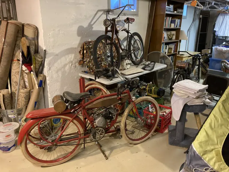

I lay awake some in the early morning hours thinking about the bike. I have a lot on my plate right now with recumbent trike conversions to electric assist and building lithium batteries, but by spring all that will be over with and I can turn my attention elsewhere...
...and I think that elsewhere is in the basement gathering dust. Why not keep tinkering with the Indian a bit at a time during winter days or evenings when it is too cold to heat up the shop for other projects even with the wood stove burning hot? There have been lots of below zero days this winter with over a week straight at the minus mid twenties in the night. If nothing else at the present time I can turn the bike upside down and get that back tire back on the rim before the sidewall starts cracking. Then check some things over and see why the drive chain is disconnected. I thought again about the problem of pedal starting it and think the idea of a 24v hub motor in back is a good idea. I'm going to check to see if there's room in the cylindrical copper "tool box"behind the seat to be sure there's enough room for a lithium battery. That would solve the engine starting problem (assuming it still runs). And if I left the bike in tri-car tadpole mode on three wheels most of the time getting on and off the seat and balance issues are at a minimum. It would be fun riding around the back streets here in town or going to the hardware or grocery store. Maybe even swallow hard and ride it in a parade (and maybe not since I don't like crowds of humans. A bunch of fish or birds is good, but people not so much). Anyway, I like the thought of riding it finally and when it is time to pass it on to someone younger it is best if it is looking and running fine. I think so. Yes. We'll see if I keep feeling this way.

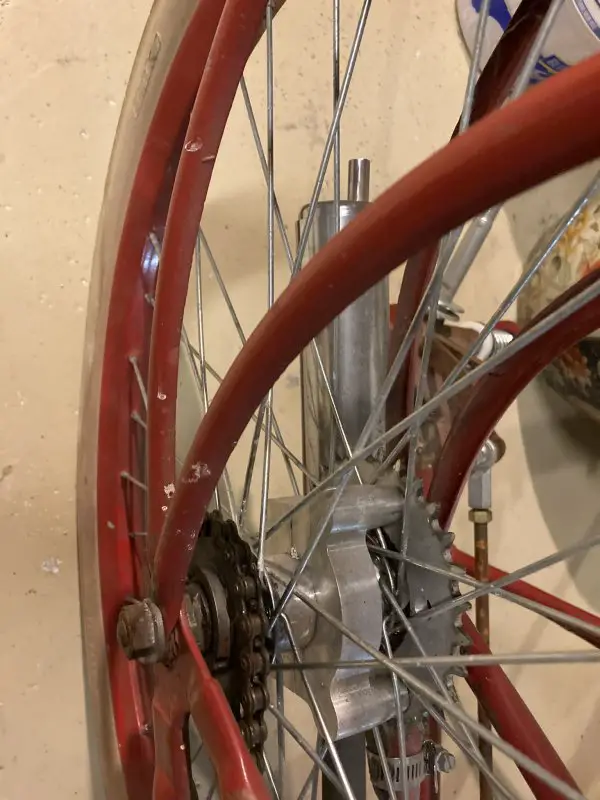

Then I noticed the engine drive chain and had second thoughts. i think that’s an adjustable manic mechanic sprocket deal ( or maybe I got it from Pat…don’t recall where it came from) but that certainly won’t fit over a hub motor. So how would I align the drive chain? Don’t know. Maybe a hub motor won’t work.

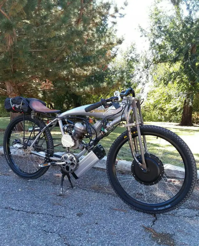

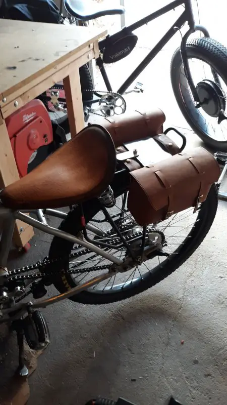

Silver bear I run a front hub motor and a rear gas China doll motor to the rear sprocket adapter. Works a charm to start the gas motor and you're right you don't need a big e motor hub for starting the gas motor (bump start) or for pulling away from a dead stop without slipping the clutch. I use two throttles one for electric and one for the gas engine. Really kinda' like the early bikes which had one twist grip for carb and another for spark advance. I've ridden this setup for many miles and it really works well.
The first photo is version one hybrid with 36 v battery on the down tube. Batteries are now in leather saddle bags on rear rack (2nd. photo).

Rick, that's a nice setup. The problem for me as I see it is not understanding how it can work on the rear hub where I suspect it needs to be if I'm going to use the bike mostly as a three wheeler. As a two wheeler it would be simple enough to put the motor up front. But how would that work as a tadpole? Two front motors ( one on each wheel) would be pricey and requite more battery power I would think. Or would just one motorized front wheel work? Is there a way to do it on the rear wheel and still be able to pedal and also have it driven by the gas motor? It's a lot to ask of one wheel, I know, but would be sweet if it could me made to work.
indian22
Dec 31, 2014
4,738
7,752
Oklahoma
SB you can drive two e hubs using one battery, single throttle and one controller, so two hub kits are required. I would say a 36v 20 amp hour battery would be adequate and appropriate.
One front wheel drive just won't work with hub/wheel drive, 1 motor central drive yes but quite a project.
The single rear hub is a bit more complex given that you want to be able to pedal and use both engines either individually or in combination with each other and be able to bump start the gas engine as well.
The rear e hub normally comes with a 5, 6 or 7speed sprocket cassette for pedal assist and this adds to the frame width necessary at the axle drops, so it makes sense to remove this cassette and go to a single speed sprocket on a freewheel clutch. At some point you will have to choose between a using a Jack shaft to drive the pedal side chain or use a separate motor drive chain as you had originally intended to drive the Manic hub adapter and sprocket. This can and has been done but requires using a sprocket adapter plate bolted to the e hub and using the disc rotor bolt pattern to secure the sprocket. Though these bolts are very tiny they must have great shear strength to withstand full break stops on bikes. That said the brake bolts are quite short as rotors are very thin and sprockets are 4 times thicker. I would find appropriate length bolts to enable complete bolt up. The greater the shear strength of these bolts the better. If you go this route using brake bolt pattern will require accurate drilling of the pattern to the sprocket. Also the sprocket must allow drive chain alignment to clear tire and chain. Next is getting the motor sprocket to align with rear sprocket and this could and probably will require engine offset or a reduction type gear sprocket machined to your specific setup. Then it's time to fine tune it all. There are several steps in this that I'll be glad to share if this sounds a good plan.
Running the Jack shaft to the pedal side has it's advantages as well as disadvantage and problems. It's been done many times for shifter kits so lots of info available. Also glad to help once you narrow it down.
My opinion and it's just my guess that you will spend more and get less from the rear drive setup no matter how you accomplish it by design. The rear setup will take some significant time to get perfect. The dual motor setup has it's own problems with designing an adequate mechanical connection to the two motor hubs. The easy way is repurpose two bike forks and run fenders to hide the fact lol. Mechanical connection from the fork type system to steering will take some thought as well.
Probably too much info at one time, but as I said glad to help.

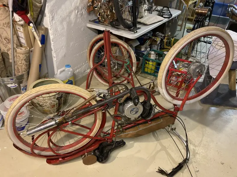

Somehow lying abed in the pre dawn helps in thinking a problem through. I realize now that I’m complicating and making something even harder to do and less likely to ever be finished. No, I won’t be doing an electric start with a hub motor or any other. It’s a nice idea and if time and money were in abundance then it would be interesting fun. But no, not at this point in my life. I have too much to finish as it is, both on the Hiawatha and on other projects Including recumbent trikes, a quadracycle and a cabin at the lake to finish remodeling.
Starting the Hiawatha is within my powers if it is in tri-car mode with the front two wheels in place. Dropping the fold down center kick stand will raise up the rear wheel off the ground. In two wheel mode as a bicycle with just one wheel up front it is rear heavy, but the other way around and the heavy front end will tip the balance the other way… which means that I can turn the pedal by hand to start the motor and leaves me in a position to operate the compression release valve, throttle and choke mechanism while standing next to the bike. Once running I can remove it from choke, release the locking brake, push it forward a bit to release the kickstand which will spring back up, climb aboard and give it gas as I release and let out the locking clutch. If the engine is running well and starts easily then there shouldn’t be a problem starting it even for an old fellow. Keep it simple. And compared to trying to make it electric start the price is a whole lot better. So I think that’s clear enough and the way to proceed.
And I do want to proceed on the Hiawatha. There are little things I can do while it is in the basement and next summer when the recumbent trikes are out of the shop I’ll get some help from a couple young fellows in bringing the Hiawatha up from the basement and out to the shop where I can tinker at will. And if I can figure a way to get that wicker seat here from Canada then I can get that affixed and have a place to comfortably sit while taking a break from tinkering in me man cave which even has a fire view wood stove in colder weather. Now that’s a plan! And I think it is doable, focusing on what is needed to make it a rider with functional drive train, good brakes and lights. Not that much, really. In my mind’s eye I see a day when the shop doors are swung open, the Hiawatha is rolled out and started up. Sue settles into the wicker seat and we putter off to seize the day…. It is nice just thinking about it.

Don't give up on summer yet. It won't be a long bike camp but with some planning it will be a productive one. Memory serves me correctly we have to weld the seat mounts on the axle and bolt the seat on. I don't think we worked on fender mounts so that is a consideration for you if you can find fenders you like and figure out how we can mount them.
To ship the seat will not be inexpensive. The wood to crate it wouldn't be either. It would be in the hundreds of dollars to get it there.
