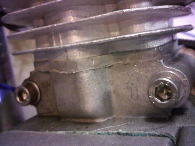

mine is 89mm, the three or four others that i have seen were all 85mm. i've always had the longest rod.
i noticed the longer rod when i tried to throw on a new piston and cylinder, wristpin height was 4 mm lower on the new piston. i couldn't find the right piston so i built a cylinder spacer 4mm thick.
Ok so that wasnt a sexual enuendo joke.... You actually do have a long rod.
4easy, if you want more bottom end power, you should map out your cylinder, see what the absolute lowest you can lower your cylinder while keeping your intake and exhaust ports fully open. Then machine the head the remaining depth needed. the top of your piston will stick through, and as long as your ring does not protrude past the deck you will gain more power.
