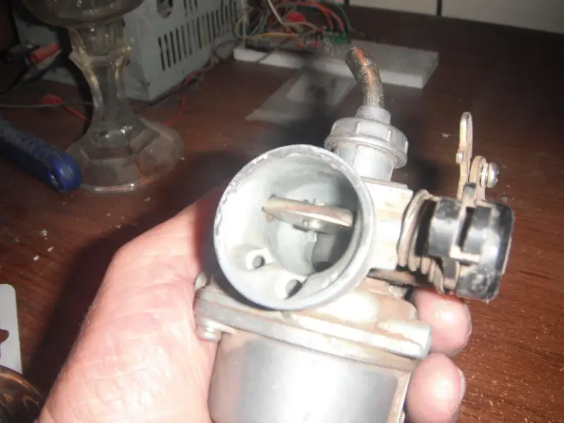

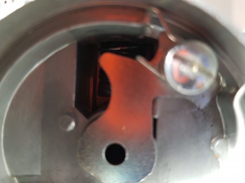

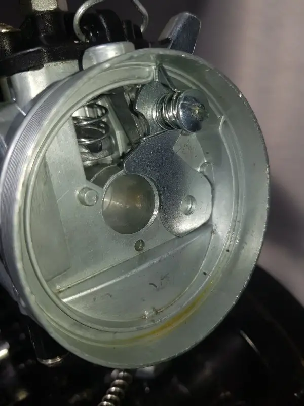

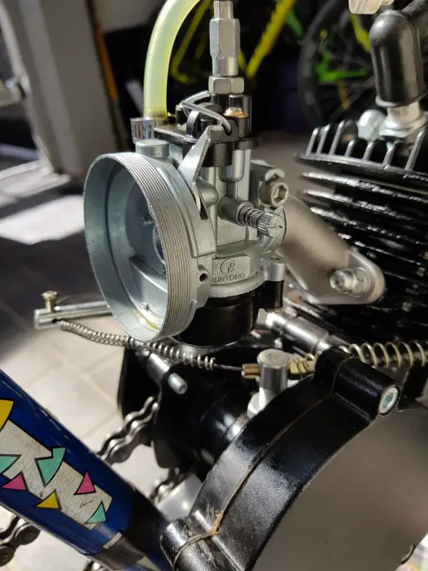

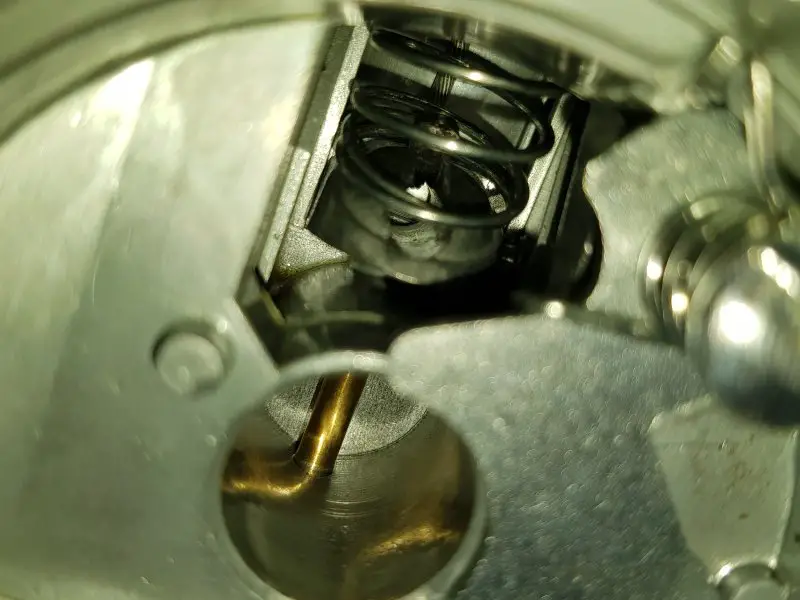

Here are the photos would the air screw be that flat head one?

Now you're on it Rusty. U da Man!
I'm not seeing it in your pics. Usually it will be on the same side of the carb as the opening that feeds it. You can sometimes follow the casting the passageway needs to find it. Maybe on the left side?
Looking again, 1st pic, and I'm not even seeing an opening to feed an idle circuit. Could be I'm all wrong and it ain't even got one. I dunno. Chinese.
The 2nd pic looks strange too. The slide isn't normally exposed out the back like that. That makes me think sloppy parts could cause an air leak in there somewhere. On a conventional carb even a loose cap will leak air. How do they get away with that?
I dunno Rusty, but I ain't impressed with that carb.

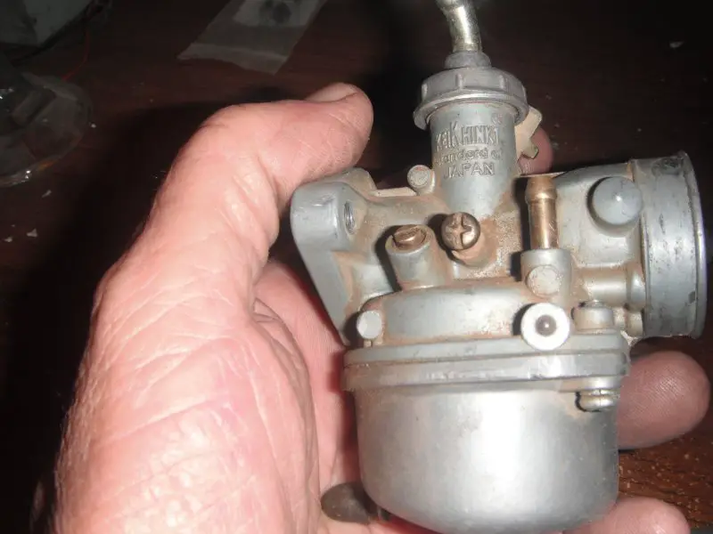

This is more typical.
The idle circuit's fed thru the hole on the left.
Here's a sideshot showing the air and idle screws. Air's in front. Idle's in line with the slide.
And frankly I ain't the best person to recommend a carb for you. I've been messin' with Japanese for something like half a century now but they're too expensive these days. Other guys here know better than me.
Help him out guys! I haven't been any help at all.
