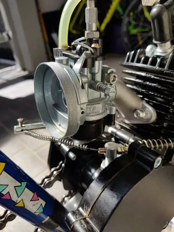

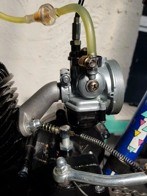

HI indian22
The engine with the choke will idle fine for as long as it can but when i would put full throttle on it, it would die and like to stall out and this is with the choke on. The cap on the carb is made out of platsic and has a gasket in place. The throttle cable nice and tight. so yeah possibly getting air through another place like you said I can send photos of the entire carb to

Photos
Good photos, the area I referred to is above the plastic top cap, where the throttle cable enters the carb. I would suggest wrapping the cable and fitting at that point to temporarily seal that area of the carb to see if that works.
Also did you actually fit an O ring at the manifold to carb connection as was suggested? This is the most common area for a leak. Also when tightening the carb to manifold be cautious not to over tighten or you will break the carb alloy housing and then you've no option other than a new carb. Also did you spray WD40 with the choke closed and idling? It's hard to know these things & eliminate the possibilities without some feedback.
