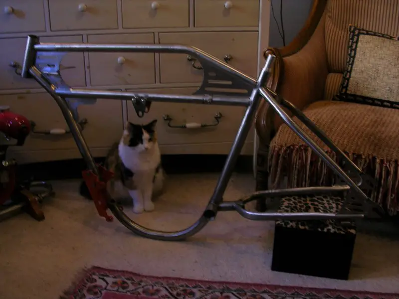

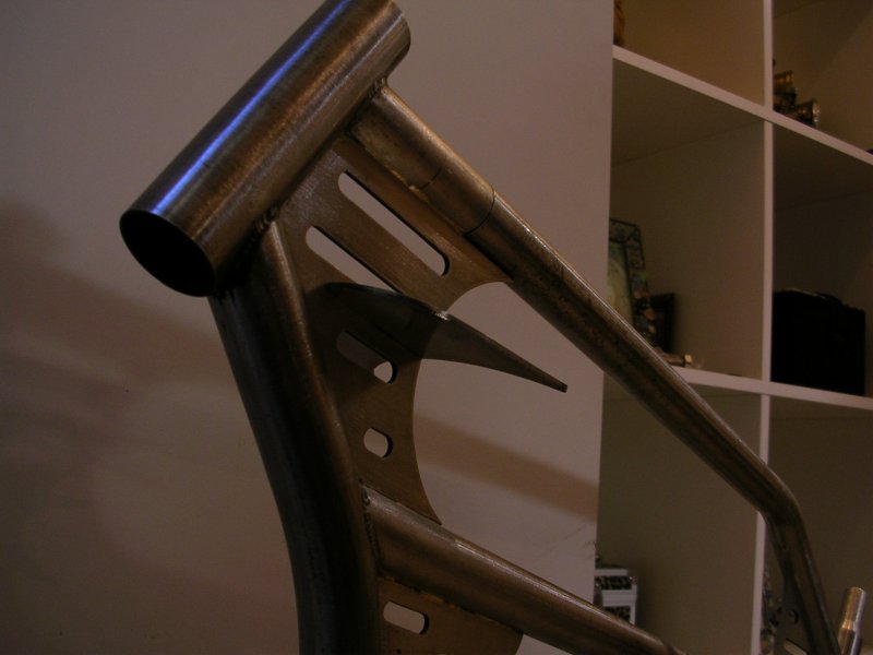

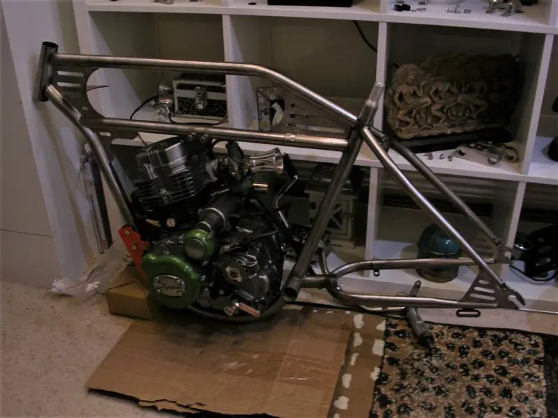

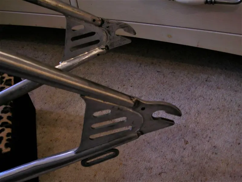

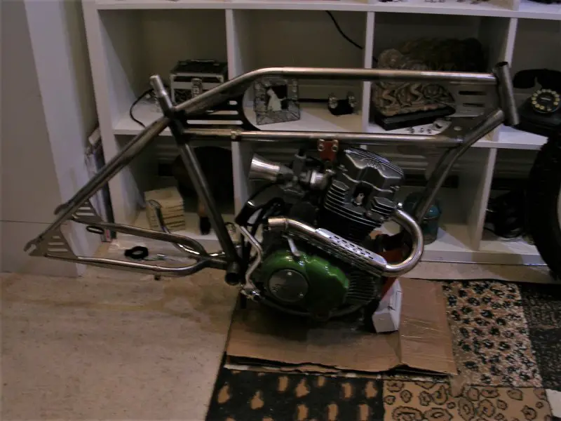

Finished up silver soldering the steel reinforcing gussets to the frame. At this stage, the frame is still able to be separated into two halves where it was lengthened 1-3/8". For convenience of dis-assembly, I think I'm going to leave it this way and instead of welding it up solid, I'll drill/bolt it together using reinforcing plates either side of the join. Should be plenty strong enough given there are substantial tubular steel slugs inside the frame where it's been lengthened.
Next stage is to get the 125cc motor bolted into the frame via its front and upper mounts. Then I can use card to mock-up the steel cradle that will include the rear engine mount which will be slung under the motor and bolt-up to the lower holes in the front engine mount, providing substantial stiffening of the frame once the cradle is firmly attached to the bottom bracket.

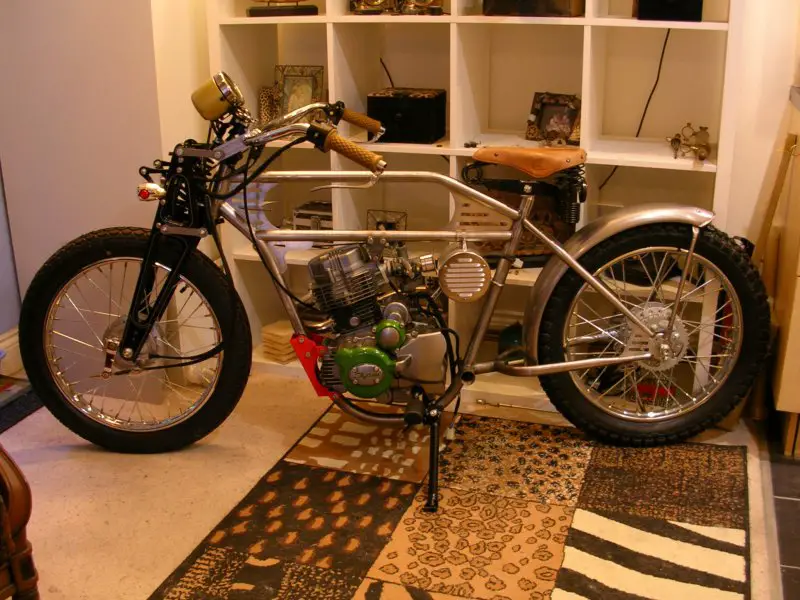

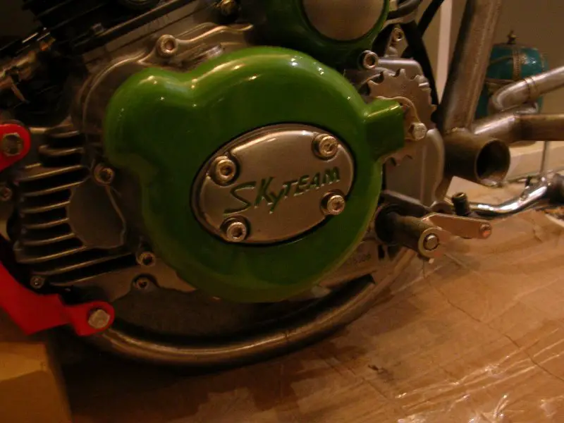

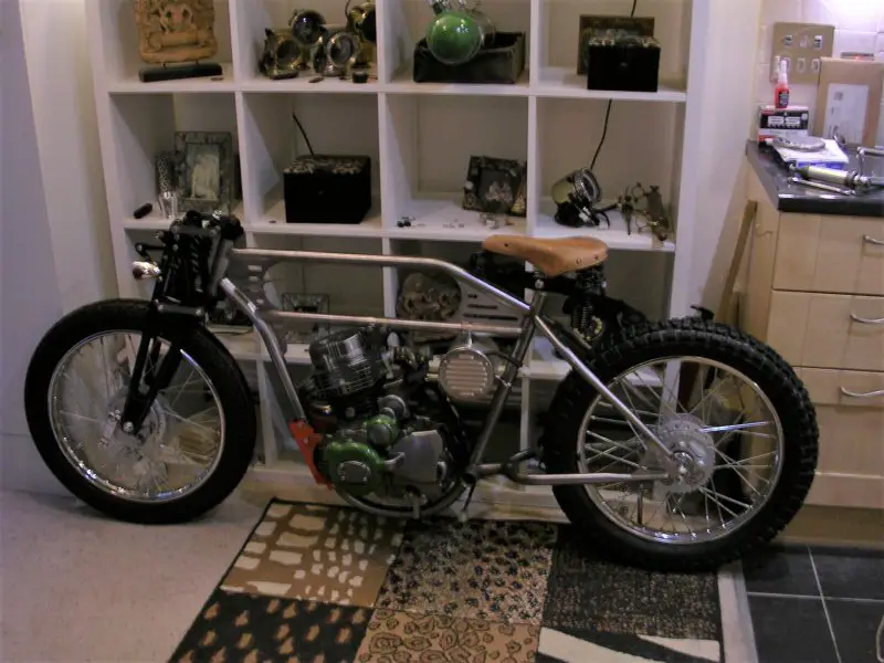

She's a roller - with motor in frame - for the first time. Just checked the chain line with a straight edge and it's spot on - but I'll have to fab an idler sprocket to steer the lower chain run so it avoids contact with the chain stay. Easy peasy. With the battery box installed, I've shelved the carb's longer velocity stack. The good news is OORacing have come up trumps with an alternative. I've just ordered their shorter 34mm velocity stack which fits the available space perfectly.

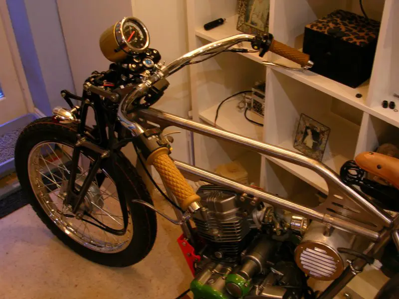

Couldn't resist seeing what those alternative wide, pull-back bars with inverted levers and longer front brake cable look like when swapped out. Bike takes on a whole different persona with these bars. God forbid I start contemplating adding a rear rack! Love both the ACE's dropped board track style handlebars and these pull-back roadster style bars, but the pull backs will make things more comfy on longer rides for sure. Wasn't too thrilled about the big speedo after its purchase - but It's grown on me a lot since and I think its look with these bars is perfectly period. Speedo's mounting clamps doubled-up as a convenient place to bolt the regulator/rectifier. New shorter velocity stack for the carb arrived earlier this morning, so it's now installed. Fits the available space a treat. Local art store came up trumps today with some suitable card for me to begin mocking-up the engine's lower cradle. Following my unenforced lethargy since Christmas (nothing more than January blues...) time to get back up to speed on the ACE build.

You & the forum regulars know my preferences well, yet here's where I ante in. I love the bars, not just for utility either. They also look great as does the speedo. Early road bikes had large headlamps and speedo too. As to rear racks they were common in early days and have continued to this day. If you were creating a perfect replica board bike then minimalist is quite correct, for a period road rider anything goes, mix and match to hearts content with period style touches.
Many originals display combinations of race look with practical daily use accoutrements like headlamp, bars, rack etc mixed with Messinger board track saddle, fenderless fork or sans fenders period, small tanks... Racing influenced the sales of brands which won and, like today, many purchased various accessories used on or which were ommited on factory race bikes. We've observed the post war "Bobber" bikes thrive in various forms for decades now. I'd suggest there was no correct way to accessorize a bike from the factory or customize by the owner. In the "spirit of" continues and greatly enhances ones liberty to build and enjoy the results. Self expression was and is fundamental to those who fabricate one offs, if not just buy a cookie cutter bike from whoever and slap a motor in her.
I like your Ace...

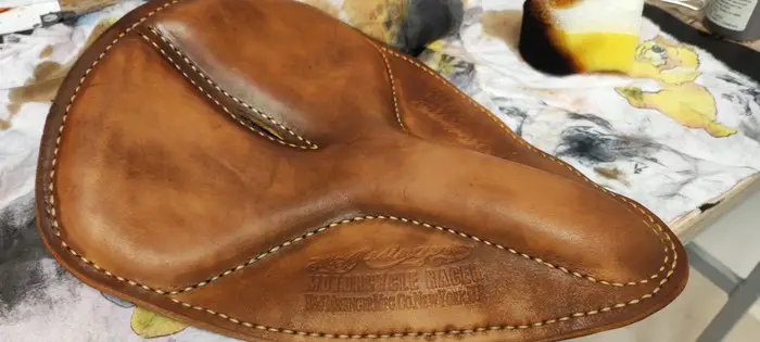

True to his word, Czech leather craftsman Tomas Adamek of leathermotorcyclesseats.cz has kept me up to speed with progress pics as the leather Mesinger board tracker saddle he's making for me takes shape. Received several updates yesterday and today as the seat's construction reached the sewing and colouring stages. Via Tom's photo and video updates, I was able to have a say in when he'd achieved just the right amount of patina. The finished result is a masterpiece in leather. Superb customer service.

True to his word, Czech leather craftsman Tomas Adamek of leathermotorcyclesseats.cz has kept me up to speed with progress pics as the leather Mesinger board tracker saddle he's making for me takes shape. Received several updates yesterday and today as the seat's construction reached the sewing and colouring stages. Via Tom's photo and video updates, I was able to have a say in when he'd achieved just the right amount of patina. The finished result is a masterpiece in leather. Superb customer service. View attachment 109699
Yeah buddy that's a keeper!

That is a beautiful saddle Pete! How will it be mounted?
Saddle features 3 x bolts on the underside to accept a nose bracket and a pair of uprights to secure it to the seat stays. Planning on being able to swap-out this boardtrack saddle and the sprung Lepper Primus saddle on my ACE depending on which handlebars - dropped boardie or pull-back roadster - are fitted.
