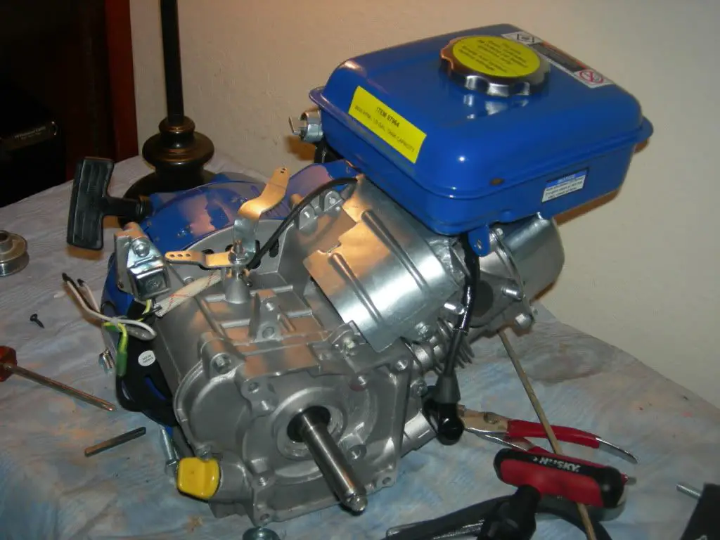

Moosylvania
Ment to post this and forgot. No need for the low oil sensor, so I removed the electronics. (more correctly the "silver thing and wires")
Pic one is with it on.
