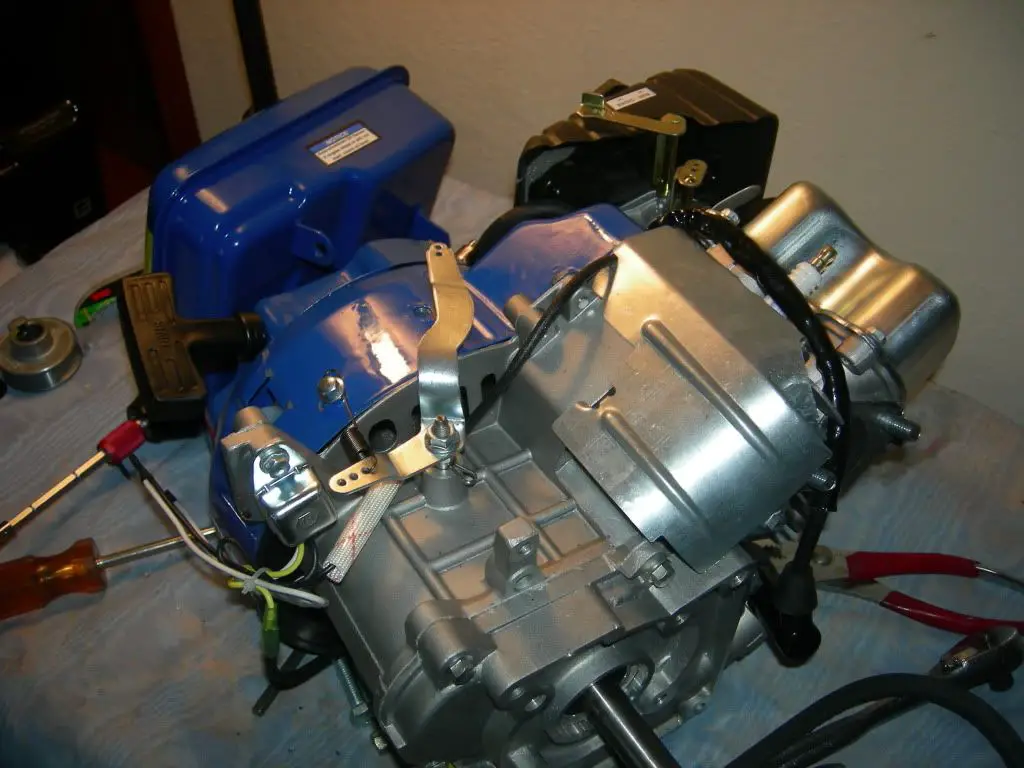

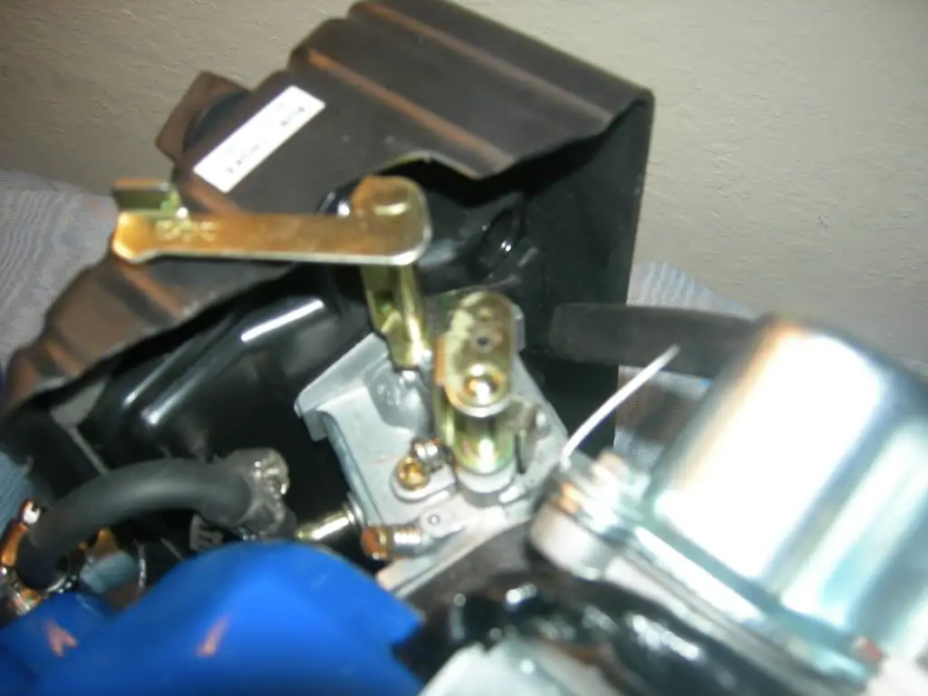

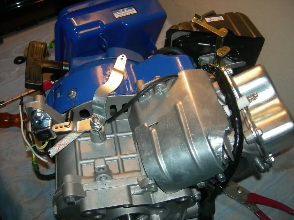

You can remove the linkage arm on the govenor bolt and just put the nut back on and I just left mine . I dont know if these pics will help but if you use your seat down tube as a staging area for your cable and come up with the right spring you should be able to come up with a throttle assembly. As long as the homework is done.
