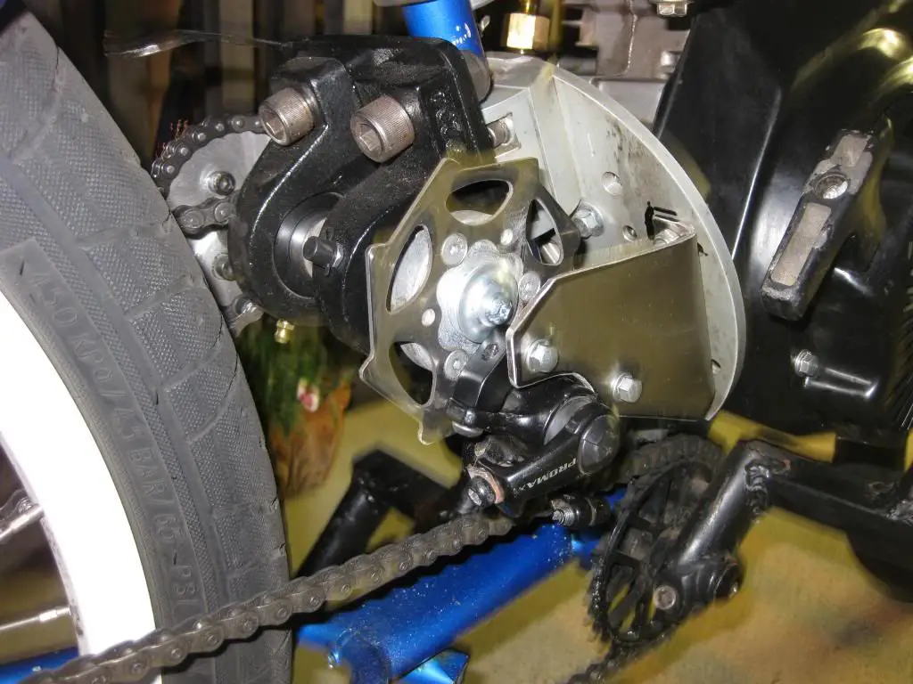

Just to put my design ideas out there, this is the adapting plate I will be putting on the SBP bracket and jack shaft setup. This way I will have 4 mount bolts just on the bottom of the engine holding it in place :)

I have two overall options on my rear drive train and disk brake.
One: I COULD go with the idea of the Predyno and have a rotor on my jackshaft.
In this situation, I would have the drive chain on the right side and have the pedal drive separate from the motor drive. I would have a sprocket adapter for the hub of course.
TWO: I could also use a shift kit and replace my rear hub with a disk brake one.. At this point they would amount to about the same cost, but with the shift kit I would need to weld on a caliper mount. That could pose a problem seeing as how I have an aluminum frame... So I may lean toward the jack shaft brake for that reason.

I am into the idea of the jackshaft brake and hub with the sprocket mount. It sounds like a solid plan for what I have to work with!
