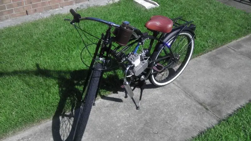

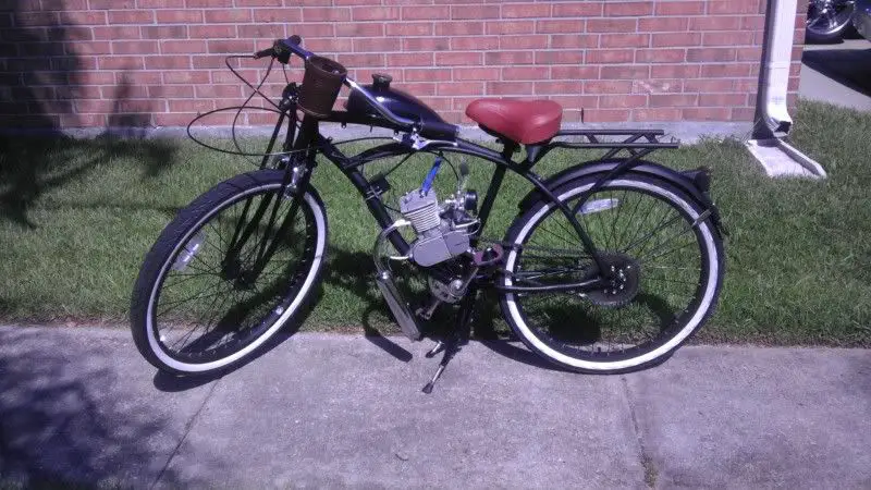

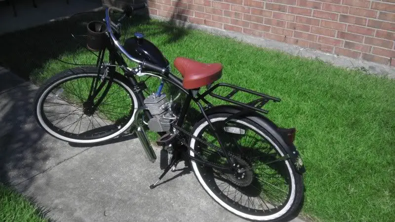

After a few weeks of tinkering with the bike, and after a helpful hand from Rolo (Harris), the bike is ready.
I got the bike from a little unknown store, it's called (excuse the spelling if I'm wrong), Wal-Mart. I talked the salesman down to 104 dollars. I called Piston bikes, got a 66cc kit, new saddle, springer fork, front brakes, and an adjustable center stand. It runs very very good, specially for this being the the brake-in period.
I'm very happy with how it turned out. I can't wait to ride it around this neighborhood. It usually doesn't have that many cars, it's a football day, though, so there are many people here....
Hope you guys enjoy
Here's the BEFORE
And here the AFTER!!!

As you know I am not a cranbrook fan (nor do I drink Pepsi, Coca Cola all the way), but the bike came out real nice I like the inverted handle bars! Now you ask for opinions, I personally would route my cables a little neater. Like I said the bike looks great and I know you will enjoy the pleasure that only riding an MB can bring! Welcome to the club.

Don, if you want to you can shorten your clutch cable housing and cable to help get it closer to the handle bars. I bought a cable kit from w/m that came with housing ends so I could cut cables to any size.

as far as the cable goes, use a propane torch and some silver solder, melt a little solder on end of cable after housing is cut to lenght then just grind or dremmel the cable end(where you soldered) to size to fit in the throttle slide. worked for me when i needed to run braided cable housings
